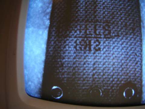

When I first got my first piece of field gear, a M45 Mussette Bag I think, It had a MFG date and maker I could not make out. A couple of years later I got a Sony DC something and was taking video of my gear and turned on the Night Vision mode. For some reason, I could make out the dates and maker like it was newly stamped on to the canvas.
I have a Khaki Haversack that had a "19.." something (the last 2 digits were covered w/ paint) I looked throught the screen with N.V. and it was a 1918 Haversack.
Has anyone tried this before?

No, but now I'll have to get my Sony Digital 8 camcorder back from my sister and give it a try.
Link to comment
HOLY CRAP IT WORKS!! I found out dates on my cartridge belt, FA pouch, and a canteen, this is awesome, thanks!

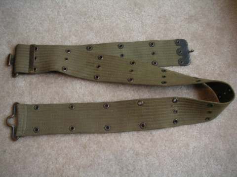

Excellent shot.
I have found with Mills equipment stampings the results are dramatic.
Yes, it is the same belt.

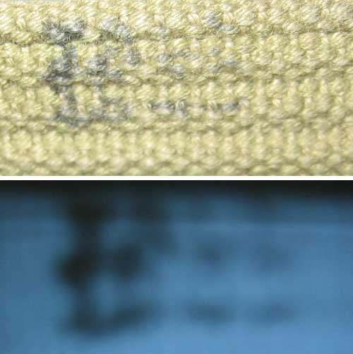

I can tell you that a camcorder with night vision will be a whole lot better: it has a far superior lens and image chip and you have the ability to focus on close objects: baby monitors will be out-focus with close objects.
In the interest of science, I spent $60 this week to buy a used baby monitor from Ebay.
As with most or all of these, it has a wireless connection to its monitor, which degrades the image quality further. This one as a "auto sensor" for night vision, but I took some photos with early morning light coming into my studio. I will say that despite the image quality problems, it pleasantly surprised in one of the two tests. I shot a canvas jungle first aid pouch and a web belt. Both of these are not only totally unreadable, but on the jungle pouch it's hard to even tell there is writing.
Here's the pouch:
It seems to show the date as 1945 and with a little detective work I could probably determine the maker (the list at http://wing.chez-alice.fr/USA/US_equipment.html is a good guide to makers names).
With the belt, the results were unusable. I suspect the very rough weave of the belts is the problem.
In the future I will show results with the same objects on a baby monitor and camcorder. I see old Digital-8 camcorders with Night Vision for maybe $30-40 at thrift stores. Even if they don't record, they are still perfectly good for this purpose.
