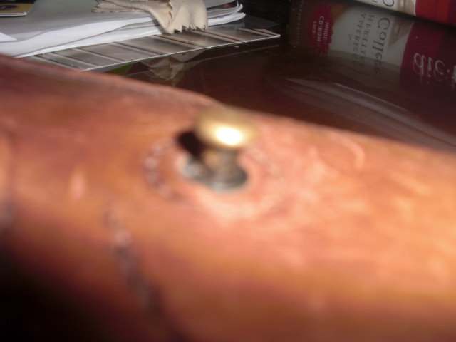

Just to add some pics about verdigris disaster. Rivets disassembled by verdigris build up (then lost) on a WWI Sears and a flap stud pulled out on a rare P.C. CO.1918.
Link to post
P.C. CO flap stud. In the same holster verdigris wasn't able to strip rivet washers so it made tears in leather.
Link to post

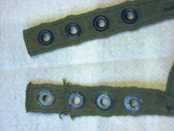

In fighting my own war against verdigris I have experimented, like the most of you surely did, almost everything. What's worth a try is plain white wine vinegar. Just dip a Q-tip in it and then gently rub the part, repeat untill the green it's gone. Eventual residual could be carefully removed with a soft nylon rotary brush on a dremel tool or simply with a wooden toothpick. Once cleaned a thin layer of WD-40 could be applied to protect the part.
Shown in the photos are the results obtained on some of the eyelets of an old Parachutist' chinstrap whic was badly stored
