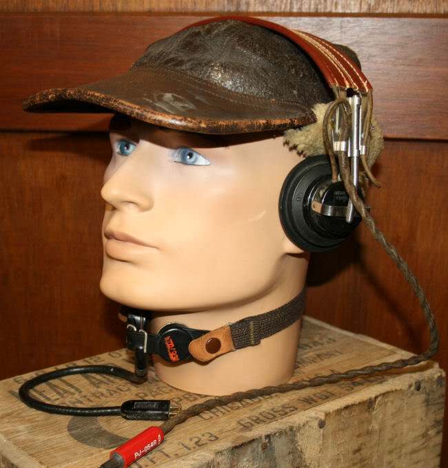

Johan Willaert Posted January 17, 2010 Share #6 Posted January 17, 2010 Here's a set-up from my collection as an example... Link to comment Share on other sites More sharing options...
Sabrejet Posted January 17, 2010 Share #7 Posted January 17, 2010 Johan...I have an identical set-up. My headset is in mint condition but came without its ear-pads. I acquired these seperately (also mint) and they're of the grey "sponge rubber" variety. However, in the 10 years I've had them they've visibly deteriorated as the sponge begins to perish...it's crazed and becoming slightly tacky! I have a mint pair of rubber/chamois "donut" ear-pads among my spares. When were they used...late war? Also, any idea where I might be able to obtain some sponge-type replacements? Thanks, Ian Link to comment Share on other sites More sharing options...
Johan Willaert Posted January 17, 2010 Share #8 Posted January 17, 2010 Ian, I have a set with R14 microphones which came with the sponge type cups... I believer the ones on my set above are correct for AC use... The yellow ones are IMO post WW2 Sorry, don't know where to find them... Johan Link to comment Share on other sites More sharing options...
Sabrejet Posted January 17, 2010 Share #9 Posted January 17, 2010 Ian, I have a set with R14 microphones which came with the sponge type cups... I believer the ones on my set above are correct for AC use... The yellow ones are IMO post WW2 Sorry, don't know where to find them... Johan That's what I thought and why I was reluctant to fit the "donuts" to my WW2 display headset! Thanks. Ian Link to comment Share on other sites More sharing options...
Tseuh Posted January 17, 2010 Share #10 Posted January 17, 2010 My headset is in mint condition but came without its ear-pads. I acquired these seperately (also mint) and they're of the grey "sponge rubber" variety. However, in the 10 years I've had them they've visibly deteriorated as the sponge begins to perish...it's crazed and becoming slightly tacky! hello, BellsAviation is selling rubber ear-pads for $15. http://www.bellsaviation.com/mm5/merchant....tegory_Code=COM I haven't tried them but it may help Tim. Link to comment Share on other sites More sharing options...
Sabrejet Posted January 17, 2010 Share #11 Posted January 17, 2010 hello, BellsAviation is selling rubber ear-pads for $15. http://www.bellsaviation.com/mm5/merchant....tegory_Code=COM I haven't tried them but it may help Tim. Cheers Tim! :thumbsup: Ian Link to comment Share on other sites More sharing options...
