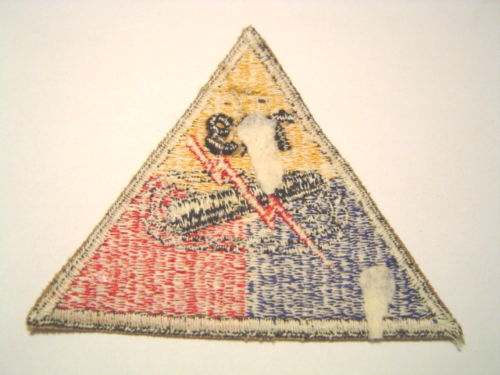

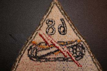

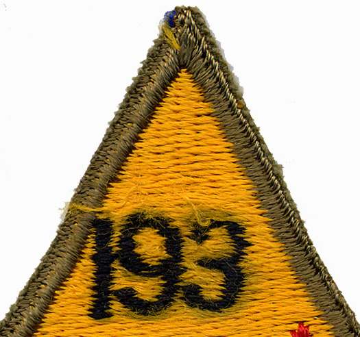

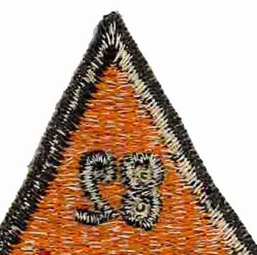

As I have previously posted, there are several characteristics to look for in made-for-collectors armor triangles. These characterictics apply to standard, U.S.-made fully embroidered armor force triangles. If you have two or more, and you are still unable to make a determination, put it down and walk away if you only collector original insignia.
1) On the front: the numbers are not uniform
2) On the front: the numbers look “fuzzy”, not distinct
3) On the front: you can see a zig-zag edge where the numbers meet the yellow cables of the apex
4) On the front; the numbers are misaligned
5) On the side: one or both sides of the patch where the numbers have been added is/are pinched

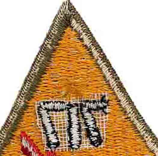

6) On the back; the numbers tend to be much thicker/higher than the rest of the embroidery; they noticeably protrude; this characteristic is easily seen as well as felt
7) On the back: there is usually white thread from a pick up bobbin
8) On the back: this white pick up thread GLOWS

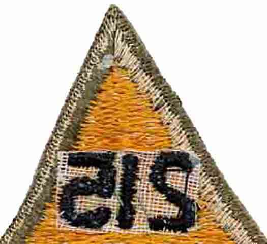

9) On the back; there may be newspaper, thin gauze strands or a thick white gauze square; the white pick up thread and this gauze all GLOW
Due to the many different skilled tailors and seamstresses in many different occupation locales, and because I don’t have them all or have not seen them all, the purpose of this thread is not to depict original period examples of a real numbered triangle. The purpose is to depict the typical, made-for-collectors armor triangles so often found for sale. Based on the above list of characteristics of what constitutes a bad patch, an astute reader can make his/her own determination of what a good numbered triangle should look like. EXCEPTION: if you find a dealer who has numerous armor triangles with none of the above characteristics, but the numbers all look to have been made at the same time and/or place, then put them down and walk away.
See how many characteristics YOU can find with these bad boys.

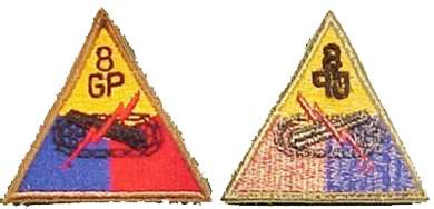

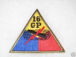

The first image is that of a good 16th Armor Gp SSI, and the only type you should ever buy (selller: rick27rod).
The image on the right is the first 16th Armor Gp patch (seller: toad389) that I have ever seen made for collectors like this (his TTC is also made for collectors, but the rest of his armor patches are good):

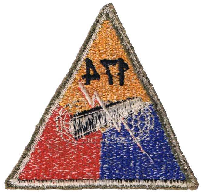

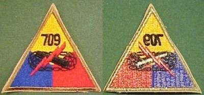

Another bad one, and this one is diff - note the pink pick up thread on the back of the numbers.

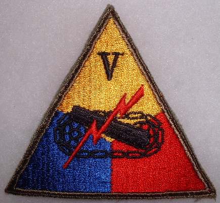

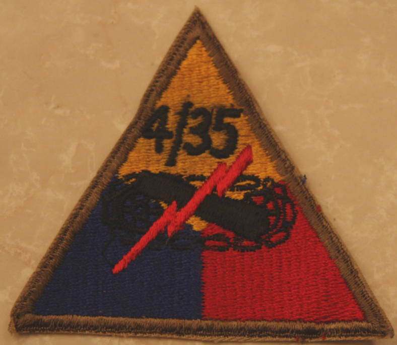

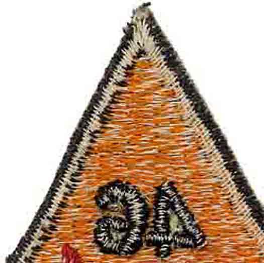

Depicted is an example of a new type of WW II triangle currently made for collectors. The other units that I know of are S, O (have no idea what unit that is supposed to be) and an incomplete 743rd (missing lightning bolt, cannon, tracks and bogie wheels). Sorry, don't have color images. All of them have OD colored cloth backs. There may be others.

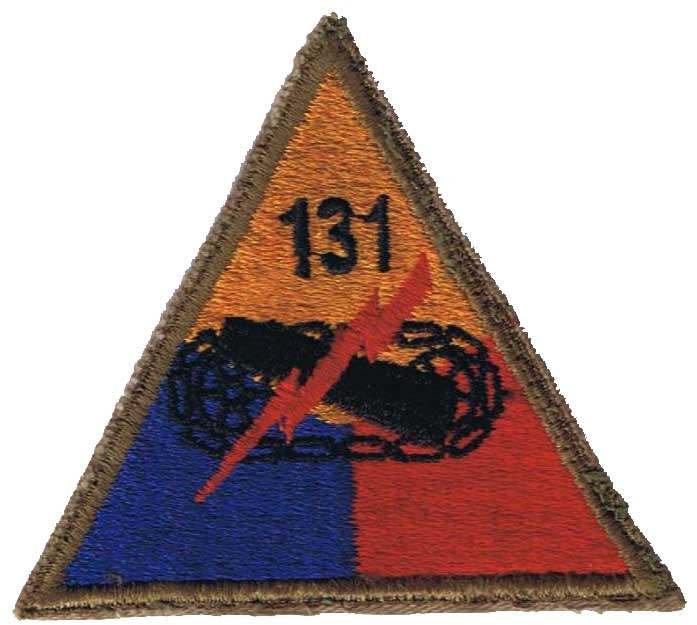

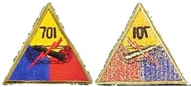

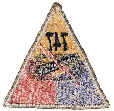

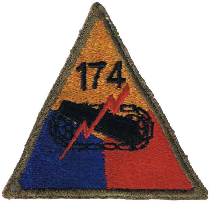

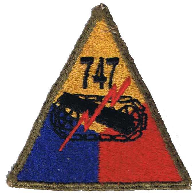

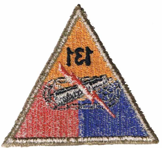

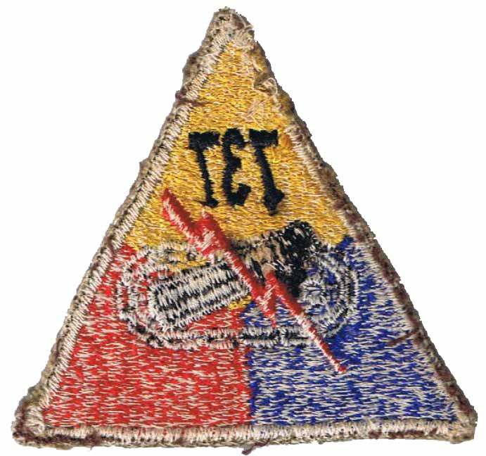

The astute collector will note that the following patches - 131st Tank Bn, 174th Tank Bn, 737th Tank Bn, and 747th Tank Bn served during diff time frames; the 131st and 174th post Ww Ii (1950s +) and the 737th and 747th in WW II. Note that from the front, they all look great (esp. on line, which is why many of us suggest attending shows to physically examine insignia). One even looks "used". When you look at the backs, you will note that they are all made exactly the same. There is no logical military reason for this. There is nothing wrong with purchasing them as "examples" of insignia which may have been worn, but don't accept that they are period originals. There are probably many others out there, perhaps in collections but collectors who don't have the information Forum members have.

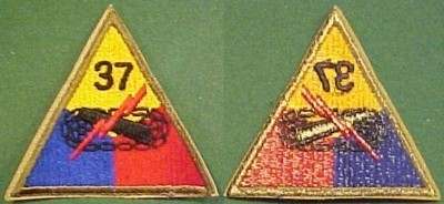

These are some more that are made for collectors. Note that they are ALL made exactly the same way. What are the chances that these units would choose the same manufacturer? There are many more out there like these.
It is evident those who offer these patches made for collectors have seen examples of really bad pieces and have tried not to make their offerings look so obvious.

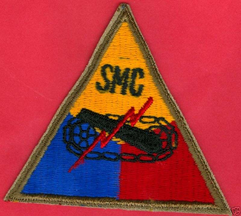

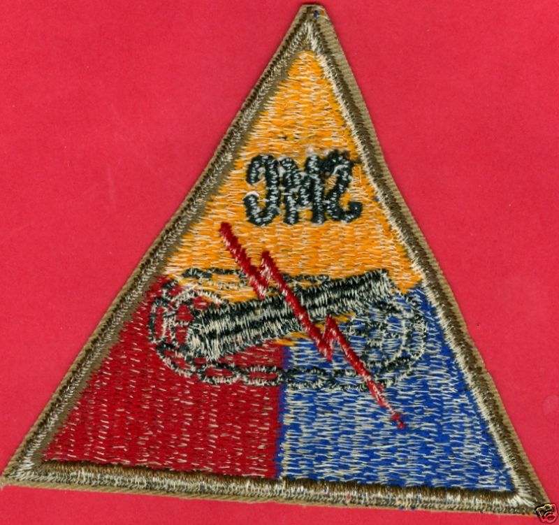

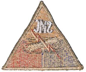

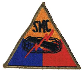

This is about the crappiest made for collectors SMC variant I have ever seen.

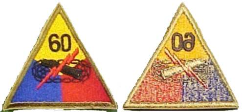

They keep crankin' them out.....60th is similar to posts #28 and 30; and is for the 60th Tank Bn (Philippine Scouts) active for 8 mos. Another seller who didn't do his homework (like the 8th "Armored Cavalry".

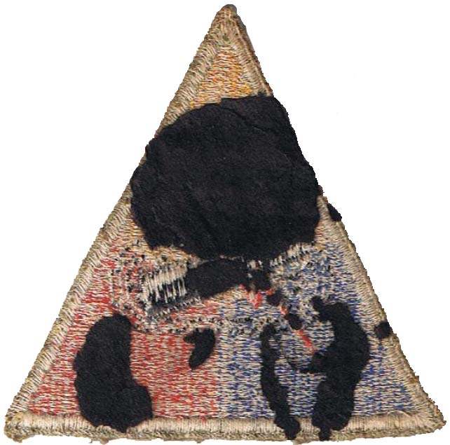

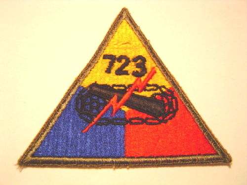

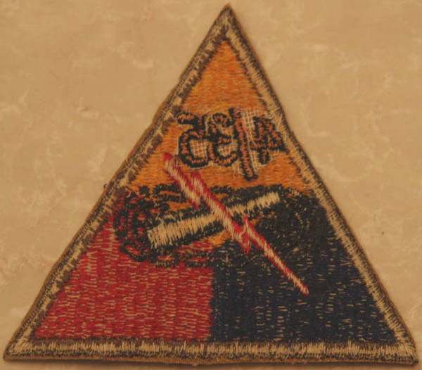

back of 723rd (and original 723rd Tank Bns are quite common)

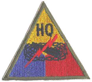

The famous "HQ". There is no documentation, written or photographic, of the existence of this "unit". EVER.

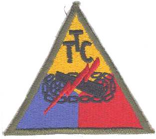

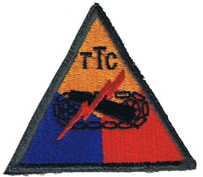

Finally, some bad TTCs (7th Army Tank Training Command). If it isn't German made, it isn't real; and if the base of the center T doesn't go all the way down, it's not real, either. Seller had 3kb image of back of OG-44 border patch, too small to be useful.

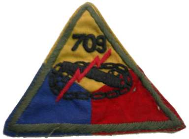

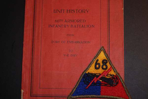

Guys-
Would like your thoughts on this patch. I purchased the pictured history of the 68th Armored Infantry Battalion, and when it came, the patch was included. Looks legit to my untrained eye, but would like to know what you think-
