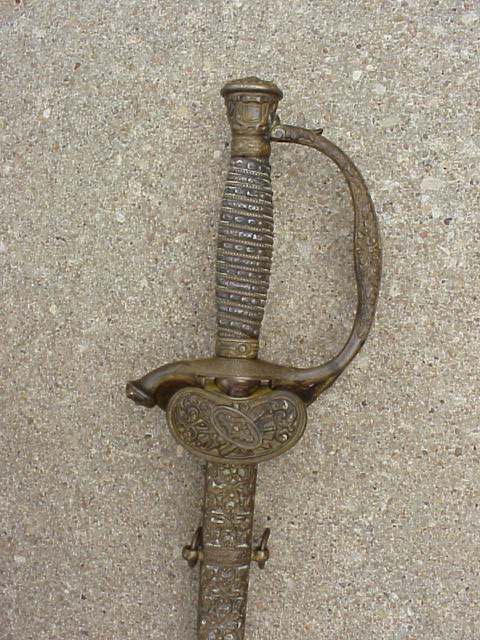

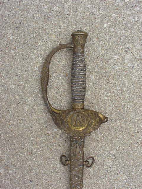

SARGE Posted June 5, 2009 Share #1 Posted June 5, 2009 I picked up this 1872 Staff & Field Officer sword a couple of months ago and have been slowly cleaning it. I thought I would show the sword and talk about edged weapon cleaning and conservation as opposed to restoration. Here is the sword as it came to me from a plumber who took it in as trade for some plumbing work. The sword is an Ames Sword Company presentation grade sword with a highly chased custom hilt and white metal grip. Notice the age patina and dull gilt over the brass castings. Also notice that there is old white powder residue, particularly on the grip, from ages old polishing. There is no damage that needs restoration and nothing is missing that needs to be replaced. While there is no damage to repair the sword was in need of conservation and stabilization. Before I do anything, I first evaluate the condition of the sword and and decide how I want it to look when I am done. I decided that I wanted this sword to retain some age patina and that I did not want to polish it because it seemingly retains more than 50% of its original finish under the dirt and grunge. So, with that in mind, I decided to slowly clean the hilt to determine what finish remained and to remove the old cleaner/polish residue and dirt. I cleaned the hilt outside with ammonia and a soft tooth brush. Only use ammonia outside and use a mask or you will have a sinus headache that you will remember for some time and your wife will continue to remind you to go outdoors for years. I start in an inconspicuous place, in this case the underside of the clamshell guard, to test how it will look when clean. This way if I overclean the underside I can lighten up on the other areas. I clean a small area at a time before I move on to something else. I cleaned the underside of the guards then stopped. I then cleaned the top of the guards and then stopped. I then move on the D guard, then the pommel, etc. I saved the grip for last because it was a different metal than the gilt brass. This process usually takes days. I found that I have the best results if I stop between areas such as the hilt and the scabbard so I can examine the process and determine if I want to clean further or stop. These self enforced stopping points are necessary for me or I tend to get carried away and overclean. "You can't please everyone so you have got to please yourself." Ricky Nelson Link to post Share on other sites

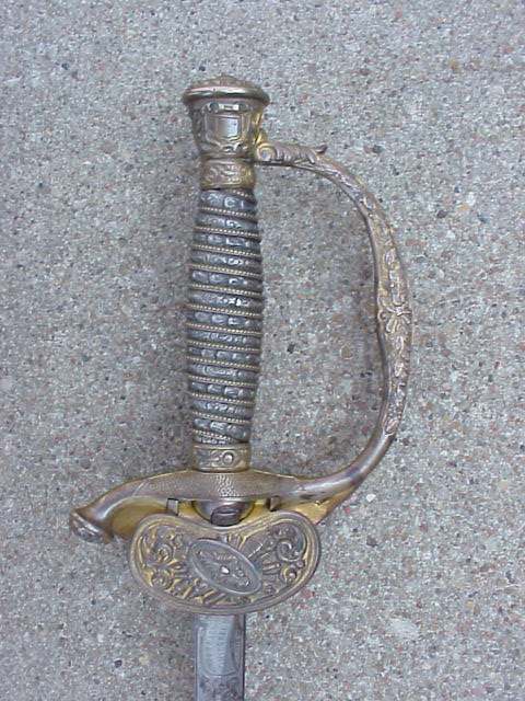

SARGE Posted June 5, 2009 Author Share #2 Posted June 5, 2009 Here is a closeup view of the back of the uncleaned hilt. The white powder and dark spots are clearly visible in this photo. "You can't please everyone so you have got to please yourself." Ricky Nelson Link to post Share on other sites

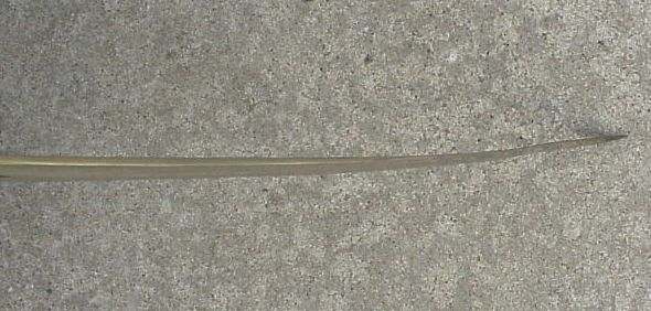

SARGE Posted June 5, 2009 Author Share #3 Posted June 5, 2009 Here is a shot of the cleaned hilt showing the exposed gilt and clean brass. The metal is now stabilized but not polished bright or overcleaned. This is the way I wanted the hilt to look when I started the process. It still shows its age and retains some patina but the foreign grunge has been cleaned away. The grip turned out particularly well and while the photo is rather hazy, it looks very nice in hand. "You can't please everyone so you have got to please yourself." Ricky Nelson Link to post Share on other sites

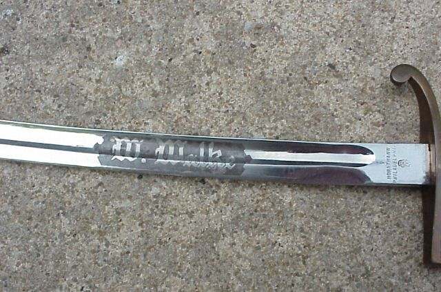

SARGE Posted June 5, 2009 Author Share #4 Posted June 5, 2009 A view of the reverse of the hilt showing the cleaned sword. "You can't please everyone so you have got to please yourself." Ricky Nelson Link to post Share on other sites
Spathologist Posted June 5, 2009 Share #5 Posted June 5, 2009 Very nice job on a very nice sword. I've also found that Varsol on Q-tips or a soft baby's toothbrush does a good job of removing built-up grime without removing orginal patina on the brass or harming gilt. Link to post Share on other sites
noworky Posted June 6, 2009 Share #6 Posted June 6, 2009 Looks very good Sarge and still has a nice patina look to it. Q-tips, Varsol and baby tooth brush, have to write that down. Great sword! A people that values its privileges above its principles will soon lose both. Link to post Share on other sites
SARGE Posted June 6, 2009 Author Share #7 Posted June 6, 2009 Thanks guys... I use lots of Q tips and soft tooth brushes but I have not tried Varsol. One of the reasons I opted to keep the patina on the hilt and scabbard is the blade. It is gilt and there is not much cleaning that one can do without destroying the remaining fragile gilt finish. I just have to live with the age and spotting to the blade and if the exterior is too polished up the blade does not look the same as the rest of the sword. "You can't please everyone so you have got to please yourself." Ricky Nelson Link to post Share on other sites

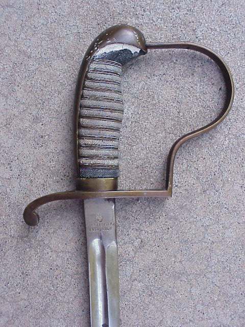

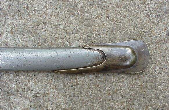

SARGE Posted July 27, 2014 Author Share #10 Posted July 27, 2014 I would also like to point out that after taking these photographs I did perform some repair on this sword. You will notice that the outside branch of the guard is bent into the next branch of the guard. I debated for a time with myself the pros and cons of restoring this branch to its original position. After considerable thought I decided to do the repair and restore the outside branch to its original position. I did this knowing the hilt and scabbard were soft nickel alloy and probably would bend without breaking as there was no visible crack. I took the calculated risk and was able to reshape the guard. This is clearly a repair but an invisible one to the naked eye. I removed nor added anything to the sword that was not there when it left Springfield Armory. It should be clearly understood however that this was not conservation but was repairing something that can be seen as damage. "You can't please everyone so you have got to please yourself." Ricky Nelson Link to post Share on other sites

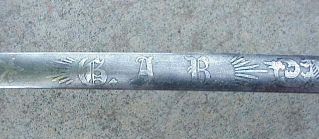

SARGE Posted July 28, 2014 Author Share #11 Posted July 28, 2014 Collectors should recognize that sometimes it is best to do nothing at all in the way of cleaning or restoration. Always remember that once you have removed grime or patina it is gone forever. Generally speaking cleaning is something that cannot be reversed so think hard and long before you act has always been my motto. Here is another example of a decision not to clean a sword. This early Grand Army of the Republic (GAR) CW veterans sword was coated with shellac long ago. This was done by the owner to protect the original finish and it has subsequently turned a golden hue due to the inherent ingredients of old shellac This coating is not like the age patina on the M1902 Saber above. This coating is something that was never meant to be on this sword, it did not come from the factory with shellac all over it, and it is not a product of age, except it has turned a somewhat attractive golden color over time. I elected not to disturb the shellac and to leave it in place. If I remove it the old shellac will be gone forever but on the other hand it can still be removed at any time in the future. I have elected to go with the medical advice of, "do no harm" and leave the applied finish in place. "You can't please everyone so you have got to please yourself." Ricky Nelson Link to post Share on other sites

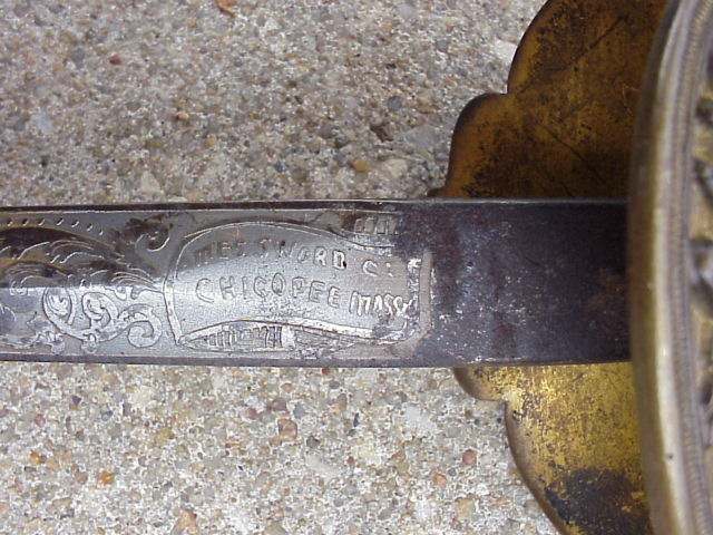

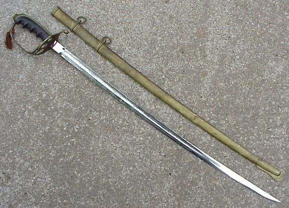

SARGE Posted July 30, 2014 Author Share #13 Posted July 30, 2014 Thanks for the kudos ka bar and thanks as well for the warning concerning the use of ammonia. As you say, it is not something to use lightly so take precautions if you use it. We have covered cleaning but not the next step, which is repair or restoration. Repairing something that is broken is an attempt to restore the sword to something akin to its original condition. Replacing missing wire in the grip wrap would be an example of restoration. You are adding something to the sword that was originally there but is now missing. This is a step that should be carefully considered. Do you have the wire? Do you have the expertise to properly replace the wire? How do you want the grip to look when you are finished? Restortion is not conservation! Here is a before example of a Model 1872 US Artillery Officer Saber with some problems. Somewhere along the line someone painted the sharkskin grips white. The blade of the sword was also bent. The sword also has some active rust on the scabbard so it needs to be cleaned and repaired. "You can't please everyone so you have got to please yourself." Ricky Nelson Link to post Share on other sites

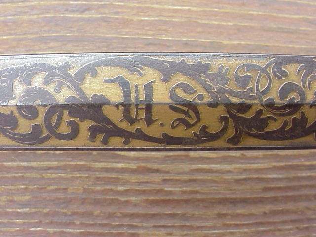

SARGE Posted July 30, 2014 Author Share #14 Posted July 30, 2014 The blade restoration was not much of a problem. It was bent sideways and I was able to slowly straighten it without breaking it. This was done by placing it a slot between two wooden boards, so it would not be scratched, and slowly bending it in several places along the area of the bend in order to bend it back to straight. This is a restoration and not conservation. The nickeled blade finish was dull so I polished it using semi-chrome. The semi-chrome will polish the plated blade bright and leaves a thin protective coating. Other polishes will do the same thing to brighten the blade. This blade was etched with the name of the original owner so one must be careful not to over-polish that area particularly if it is gilt or blued. The paint was a particularly vexing problem and I tried several things on it. I did not want to use a caustic paint stripper that could damage the sharkskin wrap. I tried turpentine but it did not work as the paint was too old and stubborn. I tried an organic paint stripper and it sort-of worked but would not remove all the paint. In the long run I was able to remove the paint from the brass without leaving spots and I was able to blend the very stubborn paint into the sharkskin grip so the appearance was improved. The scabbard had most of the original nickel plate but the plating had many spotted places where it had lifted and rust had formed on those areas. I first used 0000 fine steel wool to clean the plating and get into the crusty areas close to the brass fittings. I then used Brasso on the scabbard body making sure to avoid getting it on the brass as I wanted to retain the age patina on all of the brass which had lost its original gilt. I chose Brasso because it tends to penetrate the plating and get to the underlying steel on the scabbard body. Again, it also leaves a protective film to keep air away from any remaining rust. One must also be careful with Brasso as it has ammonia and is fairly agressive so use it with care on subborn problems only. The scabbard wound up looking better and the rusting was curtailed. "You can't please everyone so you have got to please yourself." Ricky Nelson Link to post Share on other sites

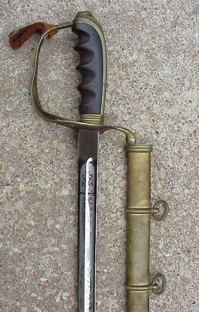

chenzo Posted April 9, 2015 Share #17 Posted April 9, 2015 Some great tips, Thanks Guy's! Sarge your photo's of the Model 1872 Artillery Officer's Saber solved the "What Is It" identity dilemma I have had over a sword that has hung at our Legion Post for ages. Odd that it is so plain in look being an Officers. My Grandfather was in a unique position at "West Point" where he collected or was sent 'Bladed Weapons' by former Cadets during their Army Careers. I now have the time to try and make sense of them along with the bayonets. My early interest in them was brought to a "Screeching Halt" at about the age of 5 when I was caught 'dueling' with the Family Couch. "No more Sword Barrel for you Mister." A 'tip' I discovered when presented with a CW Naval Officers Sword with the leather scabbard in two pieces was that "Super Glue" didn't work. Not on the first try anyways, but what it did do was soak into the old leather, harden and later when I tried the glue again and it bonded as good as any Weld. There was a bulge on one side that with a sharp knife I all but removed and colored the plain leather with a black Sharpie (rubbing as with stain). I left the small imperfection so as not to deceive because the bond was seamless. Link to post Share on other sites
SARGE Posted May 7, 2015 Author Share #18 Posted May 7, 2015 Chenzo, Thanks for your kudos on this thread. I am glad that the photos of the Model 1872 Artillery Officer Saber helped you identify your unknown saber. I will point out that the saber that I show belonged to General Wiloughby Walke who wore it as an Artillery Officer in the 3rd Battalion Artillery during the Spanish-American War. Walke was an expert on explosives and published works, including a standard manual, for the US Artillery School, where he was a lecturer. Brigadier General Walke also served as Commanding Officer of the Middle Atlantic Coast Artillery during WWI. "You can't please everyone so you have got to please yourself." Ricky Nelson Link to post Share on other sites
