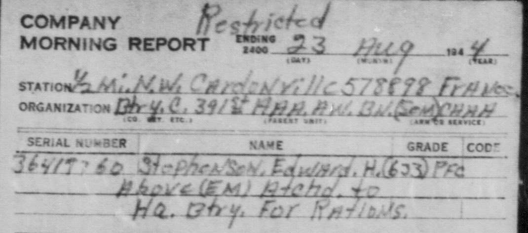

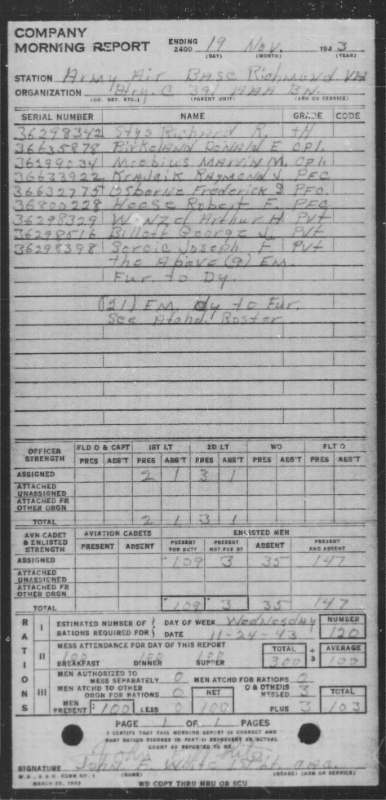

jumpship Posted March 22 #4 Posted March 22 During Nov 43, he is shown as assigned to Battery C 391st AAA Bn at Richmond AAB, VA: During Aug 44, he is shown as assigned to the same unit, Battery C 391st AAA Automatic Weapons Battalion (Semi-mobile), in France: Source: NARA The 391st AAA Automatic Weapons Battalion (Semi-mobile) was formed on 10 Jan 43 at Camp Davis, NC as the Separate Coast Artillery Bn AA-AW. It was re-designated from the Coast Artillery on 30 Apr 43. The battalion departed the Boston Port of Embarkation on 27 Feb 44; arrived England 8 Mar 44; arrived in France on 14 Jul 44. Its location during Aug 45 was Mondorff-Bains, France. The battalion was given Campaign Credit for Normandy, Northern France and the Rhineland Campaigns. (Source: Shelby, Stanton. US Army WWII Order of Battle).
RG Posted March 22 Author #5 Posted March 22 Thanks immensely!! This matches with what I suspected from the little bit of family lore I have heard. The assignment at Mondorff-Bains puts him at Camp Ashcan, Luxembourg. Thanks again. Edward's 93-year-old brother will be happy to get this information.
