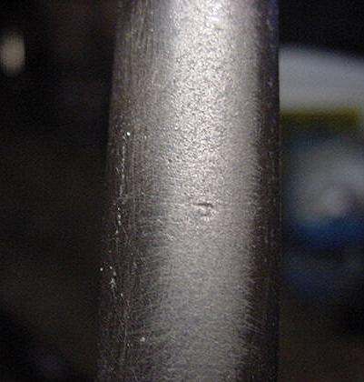

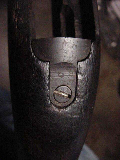

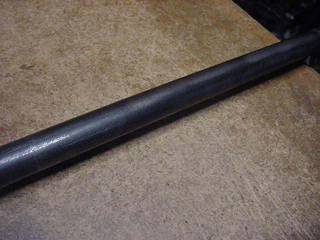

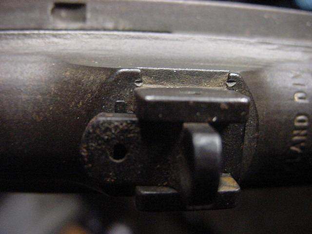

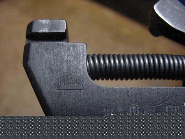

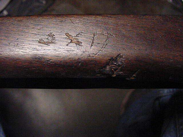

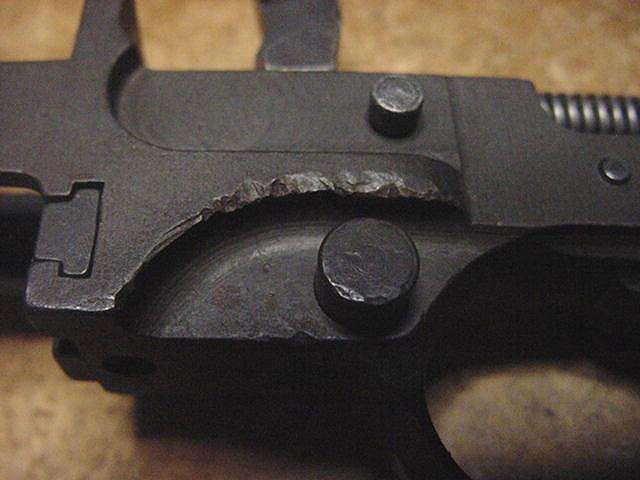

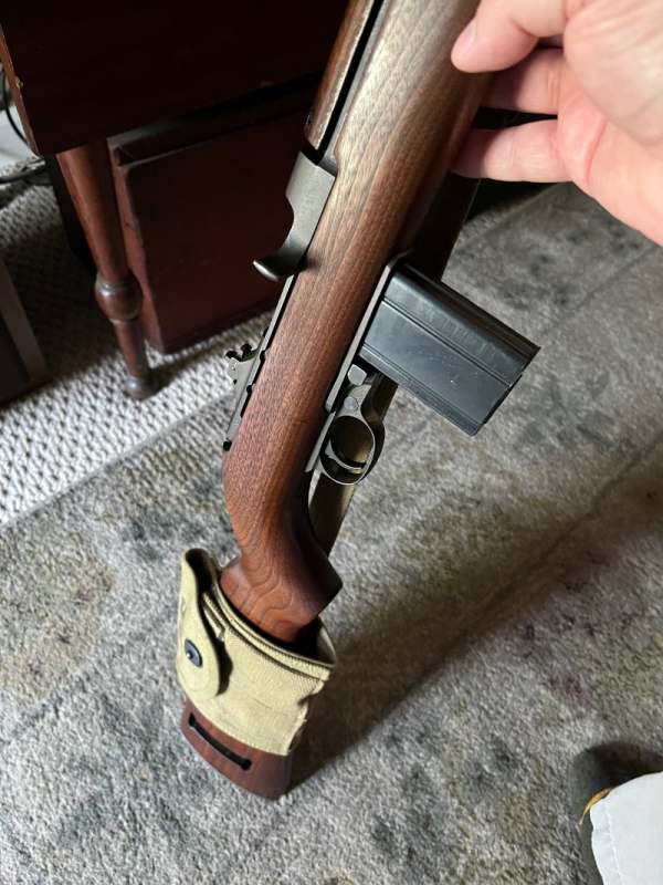

I just found this carbine. I have seen postings saying that an original condition carbine that has its un-replaced parts is rare. I would like opinions on this one. It came from an estate that has had the carbine ever since WW2. The only piece missing is the slide stop pin. There is an area of stock gouges that are next to some trigger guard dents that indicates to me the stock is original to the trigger group. I would appreciate members expert opinions on this carbine. If it is all un-messed with original, how would that affect the value?

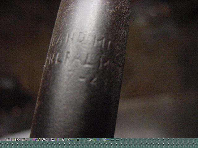

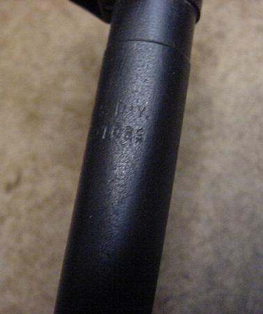

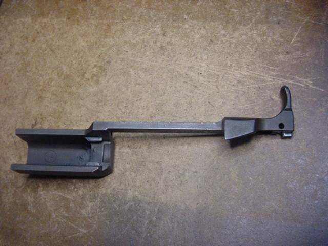

Hi, from what the pics show, I’d say that it looks as though it’s in order……I agree in that it hasn’t been messed with many years, all the components look as though they are in the same condition and have aged equally.

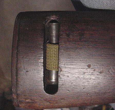

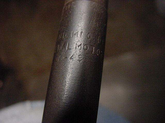

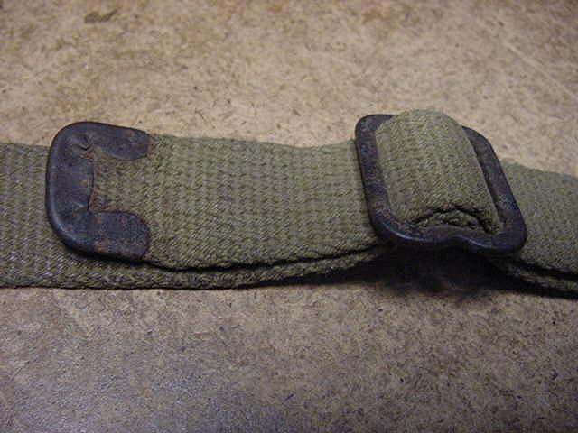

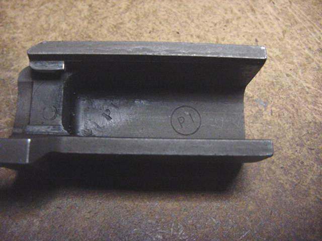

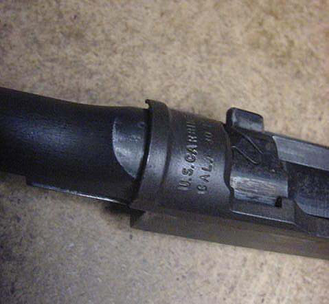

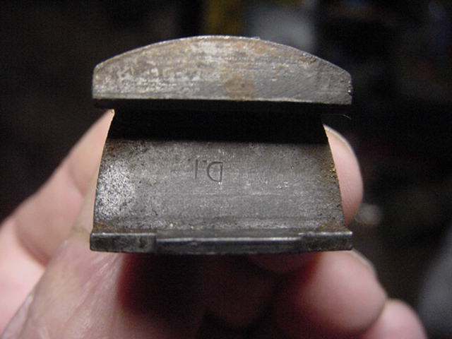

Here are some pics of my own Inland, with a barrel date of some three months earlier, kinda ‘close’…. It is also in unaltered condition and is quite similar to the one you’ve posted, although the stock on my Carbine has an I-cut oiler slot.

I’d check the bore before handing over any money, and if it passes muster then I’d carefully clean it-it’s hard to tell if we’re looking at grime or some light rust in spots. All in all, the Carbine has a lot of potential, and with an excellent bore and bringing the condition up to snuff the value could be a lot better. As far as what number that is, your mileage may vary, as they say.
Thanks for the comments. The bore is very nice. Should I leave the carbine as is, or should I clean it? I kind of like the original used look.

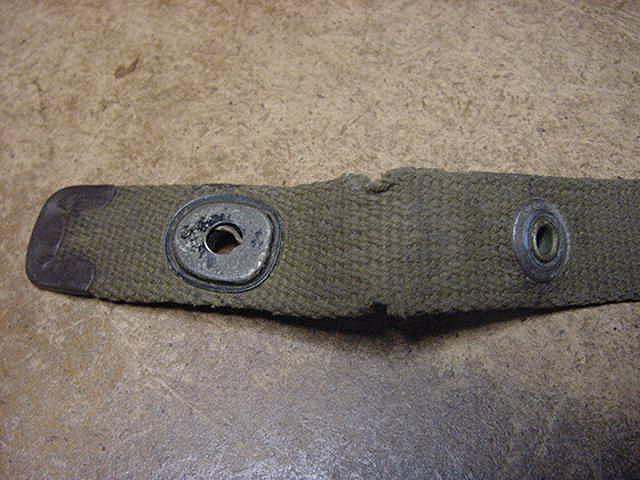

To remove the sling, remove the other end from the buckle.  Then hold the oiler in place while while unthreading the sling past the oiler.   Otherwise  the oiler moves with the sling and locks it up.  The end should come through without a fight.  Then do the same the othe way, and last let the oiler drop out.  For installation start with the oiler in its slot.

The stock looks pretty Ok, but a little dry.  Maybe be more of that under the rusty buttplate. So if you take the buttplate off, you may want to put linseed oil on the endgrain.   depends if the rust is just on the outer surface or if it got soaked in water at some point.
Here is a photo of the butt plate removed.
I'd say use a somewhat soft brush to remove any loose rust.  When you put linseed oil on, see how quick it soaks up.  If it disappears in a minute, keep feeding it.  if it sits on the surface, see if it soaks in over a few hours and then remove the excess.

Just saw your post on the carbine forum. Nice rifle. From what I see, I like. You’ll get some really good input over there. Parts look correct. The oval sling cut highwood stock is correct for your SN. Wear patterns are a big factor when trying to decide if it’s original or not. Even then it’s a guessing game. Yours definitely has that been there done that look.
I like it, looks unmolested straight from WW2!
