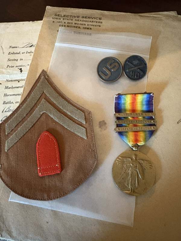

Spudboy Posted December 17, 2025 #1 Posted December 17, 2025 Any assistance would be appreciated - A little context: I am building a shadow box of my wife's grandfather. I have his service record, medals and collar tabs as pictured. What I am struggling with is the rank insignia that I acquired at auction. His service record indicates states that he was inducted Dec 19, 1917 - discharged Feb 8, 1919. Highest rank attained Corporal. He was assigned to artillery HQ and family history has him as a runner. Service record indicates he was assigned to Artillery "CAC?" then to the AEF. Question - Is this the correct Rank Insignia patch for his service? Any hep is greatly appreciated. Thank you.
Salvage Sailor Posted December 17, 2025 #2 Posted December 17, 2025 CAC is the Coast Artillery Corps -->> Insignia of the Coast Artillery Corps
Spudboy Posted December 17, 2025 Author #3 Posted December 17, 2025 thank you - Pardon my ignorance - Is the HQ collar disc accurate due to being part of the AEF? any help on the shoulder patch would be appreciated

atb Posted December 18, 2025 #5 Posted December 18, 2025 The disk is for the headquarters battery of a field artillery unit so it could work for his AEF assignment. More thZn likely he wore a plain corporal chevron with no gunners device.

atb Posted December 18, 2025 #7 Posted December 18, 2025 On 12/17/2025 at 12:13 PM, Spudboy said: Any assistance would be appreciated - A little context: I am building a shadow box of my wife's grandfather. I have his service record, medals and collar tabs as pictured. What I am struggling with is the rank insignia that I acquired at auction. His service record indicates states that he was inducted Dec 19, 1917 - discharged Feb 8, 1919. Highest rank attained Corporal. He was assigned to artillery HQ and family history has him as a runner. Service record indicates he was assigned to Artillery "CAC?" then to the AEF. Question - Is this the correct Rank Insignia patch for his service? Any hep is greatly appreciated. Thank you. The chevron looks like a pre-WW1 cotton service uniform example for a corporal holding a gunner's rating.
CAC1901 Posted December 19, 2025 #8 Posted December 19, 2025 He would have worn a standard olive drab wool corporal chevron on the right sleeve. These are easy to get and fairly inexpensive. The particular chevron you have is ca. 1904-1908 era first class gunner / corporal brown duck chevron for the brown duck fatigue clothing worn at coastal gun batteries well before WW1. Much of the 'coast artillery' of WW1 like your wifes grand dad were initially assigned to coast artillery units but did not operate in the usual coast artillery mode. They were distributed to the AEF in France, for example the First Army, and basically operated as heavy field artillery.
