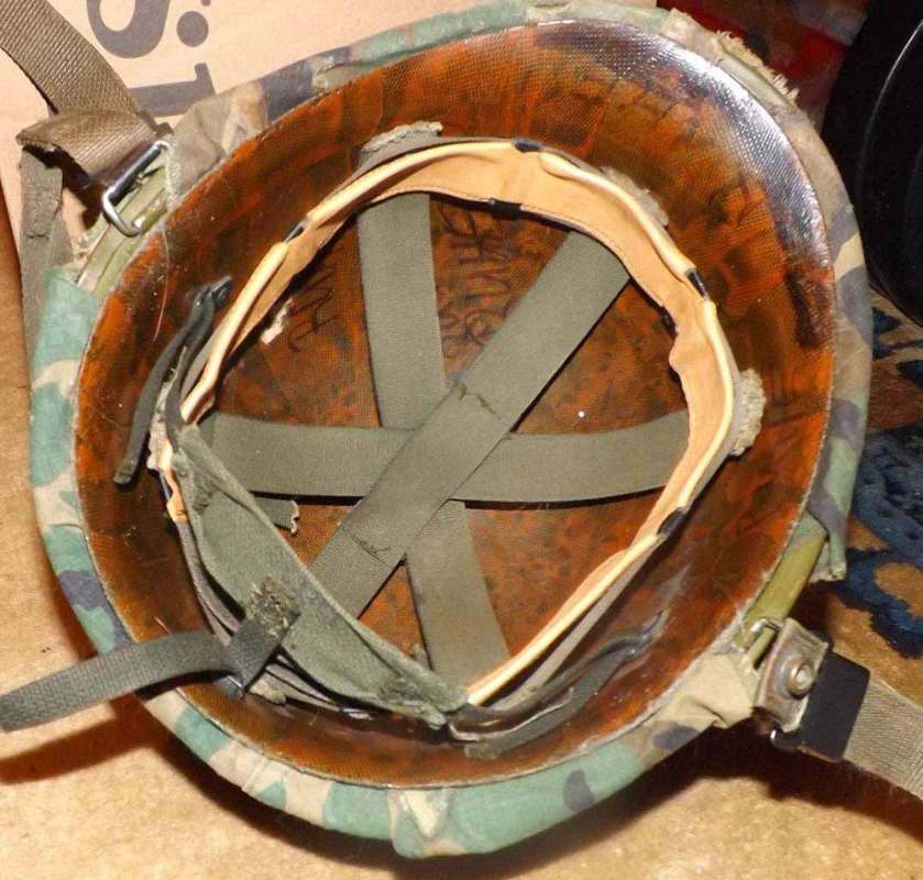

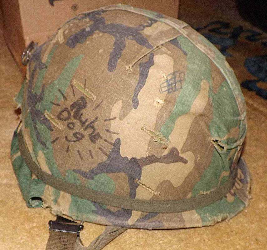

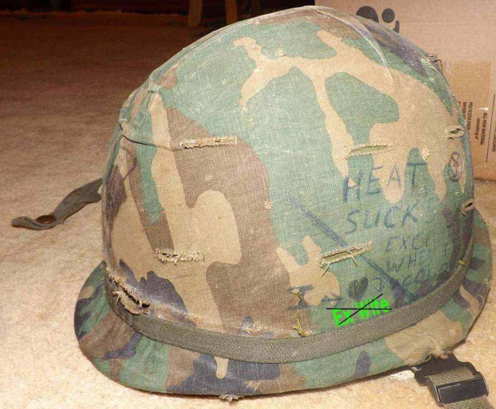

I joined Nov7th1981, Was never issued a Butt Pack but some guys had em.
Yes people in my unit, me included wrote and drew stuff on our helmet covers.
Nothing crazy and nothing that was glaring or stood out too much.

Here is my old steel pot which I was able to keep back in 86 when we turned these in for kevlars.
I turned in an extra I had and kept my issue M1.
