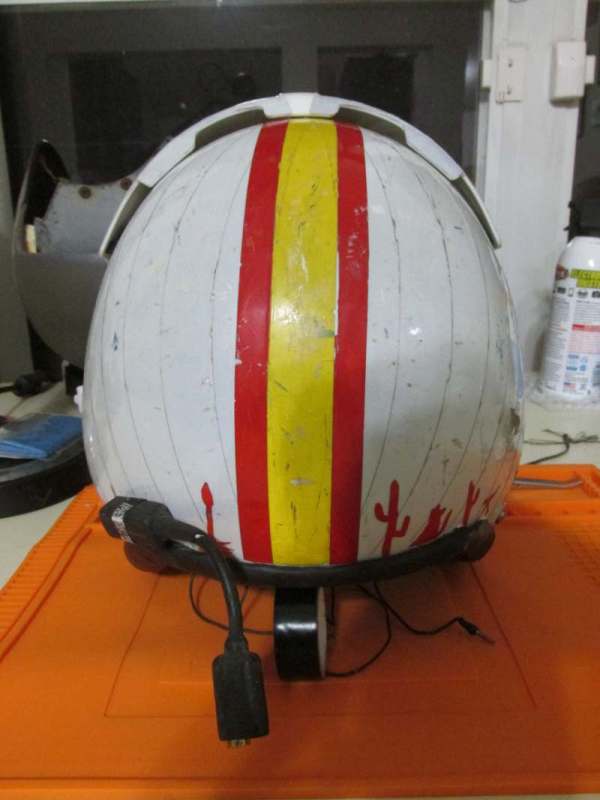

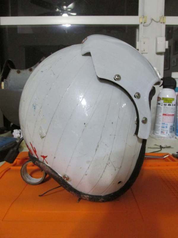

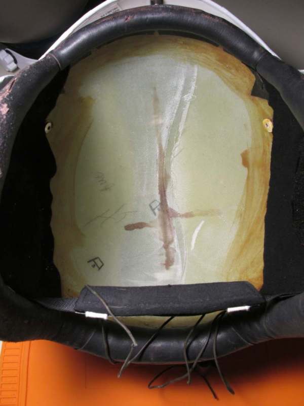

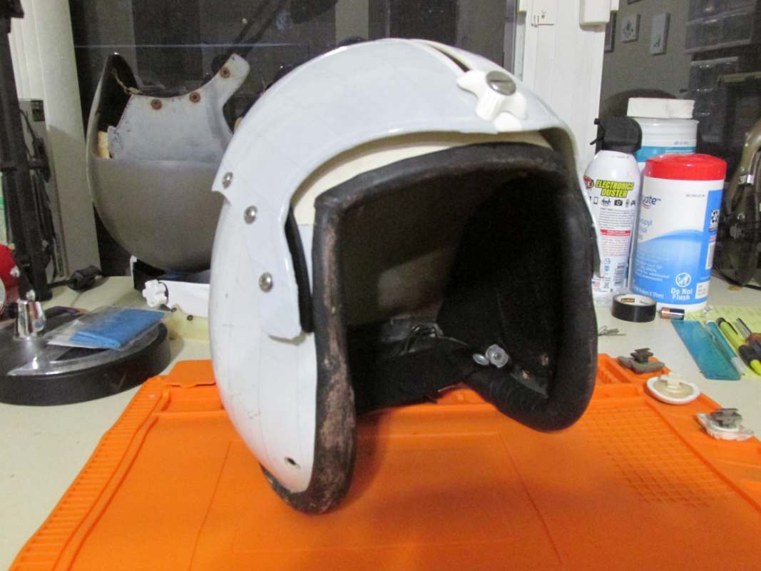

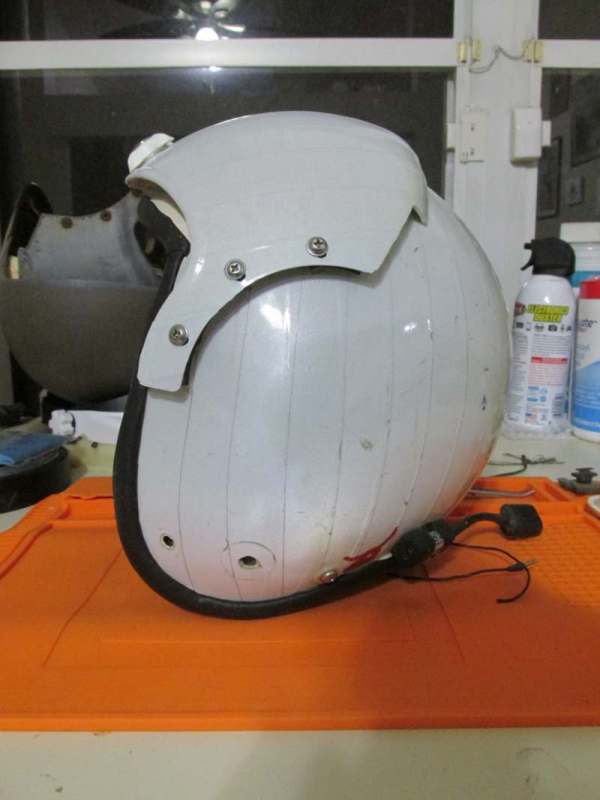

Rooter Posted November 7, 2025 #1 Posted November 7, 2025 Hello! I have here a PRK-37 shell with some parts I put on it already. When I got it, it was the shell, the CX-4832 cable, and a PRK-40/P liner, which was worse for ware and loose in the shell, so I took it out momentarily to work on the rest of the helmet a little better. Afterwards, I got that EEK visor housing, taped it up and screwed it on, and that nape strap too. Thats all I've done to the helmet for now. From the looks of it, I think its an HGU-47 (V4), but I have no idea where it was used, nor what squadron it was once attached to. Another thing is that it has holes drilled for the bayonet receivers, but at one point was taped over, as you can see these "dimples" in the tape.
AMT500E Posted November 7, 2025 #2 Posted November 7, 2025 The comms pig tail and boom mount hole alone might suggest S2, P3 etc.
amateuraero Posted November 21, 2025 #3 Posted November 21, 2025 Guessing P-3 Orion variant from a squadron stationed at a NAS in California such as VP-19 with NAS Moffett Field, etc. Mask receivers previously installed were probably removed after previous assignment with a training squadron or P-3 crew position change. The crew on the flight deck such as Patrol Plane Commander and pilot positions might have used oxygen masks when needed? Seems like that I have seen the helmet artwork before in a book or online. Maybe in a documentary. There should be a contract date on the communications cable. For example ...82-C-... for 1982.
Mikeym_us Posted November 23, 2025 #4 Posted November 23, 2025 Those earcup piles need to be refoamed as the original foam disintegrated. Pretty easy to do with 1/8" thick anti static foam sheets which is what I did with the earcup piles in my HGU-55. Visor cover is also missing the velcro pile patch on the visor for attaching the distress strobe onto the visor cover.
Rooter Posted November 25, 2025 Author #5 Posted November 25, 2025 On 11/22/2025 at 7:53 PM, Mikeym_us said: Those earcup piles need to be refoamed as the original foam disintegrated. Pretty easy to do with 1/8" thick anti static foam sheets which is what I did with the earcup piles in my HGU-55. Visor cover is also missing the velcro pile patch on the visor for attaching the distress strobe onto the visor cover. Thank you very much Mike, I didn't actually know that was something I had to do, so I'll be doing that very soon. As for the velcro, I have it on standby for after I finish adding some more designs to the housing there.
