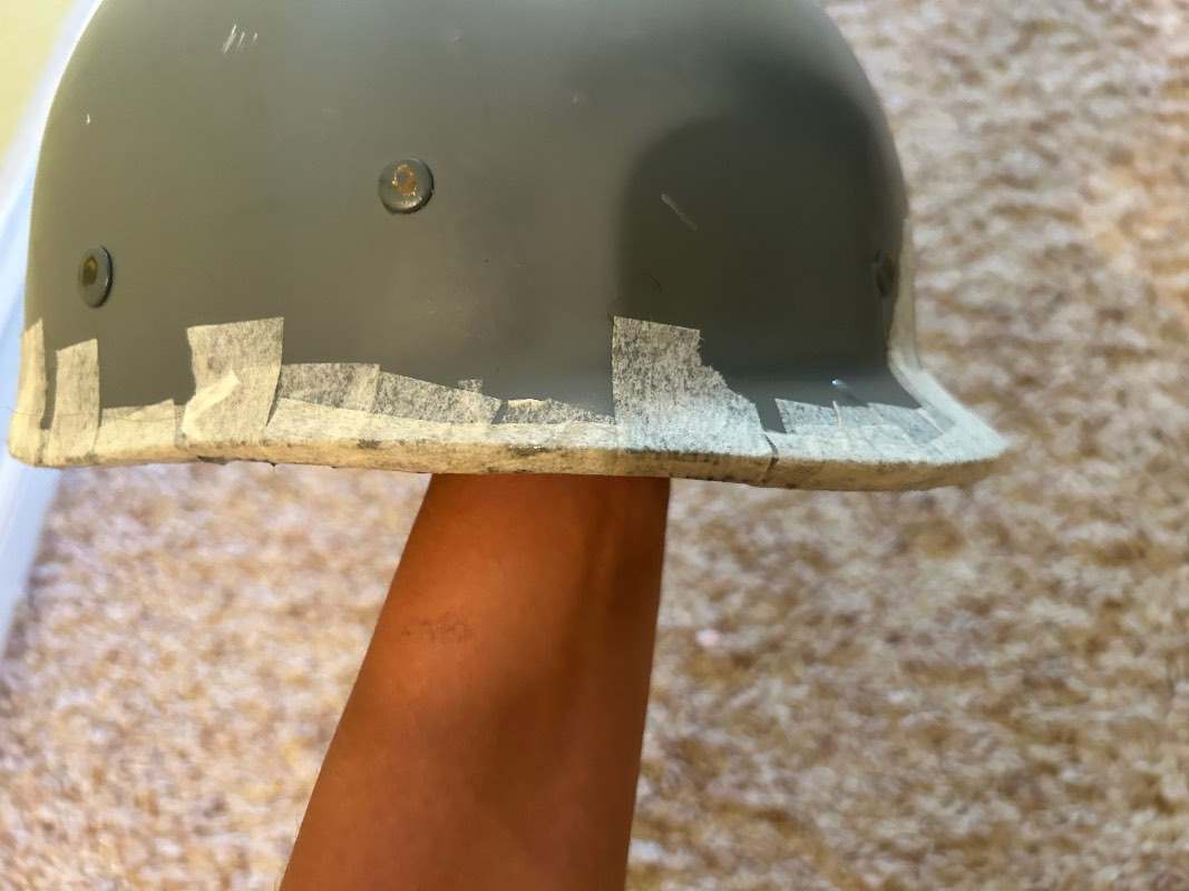

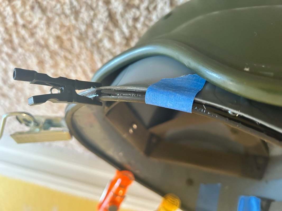

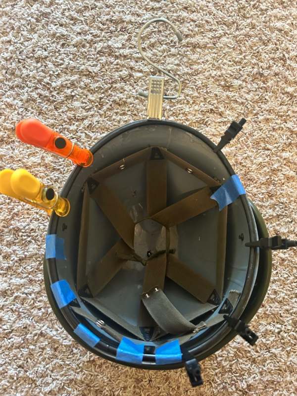

Gear Fanatic Posted June 16 #1 Posted June 16 Hey all, to start, over the years I’ve tried to come up with many, many different ways to create an accurate Fiber liner. Or at least one that looks fairly close. Mainly for use in reenacting and displays, but still keeps the right look. I’ve tried making cardboard compression molds, I’ve tried paper mache, I’ve tried cardboard pulp, I’ve tried 3D printing, everything. But making it how everyone else makes it IE (using a post war high pressure mold and making a mock up). And today I finally gave up trying to make one how it should be and resorted to creating a mock up. So today I brainstormed the process and came up with a full proof plan. I got this post war Norwegian liner that is plastic with mostly accurate cotton webbing and I started fiddling with it. My idea for the brim was to cut a large electrical board and epoxy it to the brim which is what I started doing. After it’s firmly in place I plan to wrap the bin thickly in white masking tape to give I the paper look for when it inevitably wears down along the brim. After that I plan to find an accurate fabric and somehow get that completely confirmed with no fold to the liner from there I will tack in mock rivets above the old ones under the fabric since I don’t have money to buy the tools to take them out and remove them through the fabric. After that I will paint the inside to correct green and create an accurate fiber liner stamp for the side. Then for the weebizbh depending on what version I do I will bleach and dye the webbing to correct shade and create a mostly accurate sweat band from the existing one which is fairly close to the originals. Then I need to buy/ replicate a liner chinstaro and voila a semi accurate mostly working fiber liner. Here are some pictures below of the current prices. Stay tuned for more!
Gear Fanatic Posted June 16 Author #2 Posted June 16 Alright all, this morning the glue dried and I taped the brim and then coated it in a 40/60 solution of water and PVA glue. This will hold it together and “impregnate” it in a harder protective layer. After that dries today it’s time to start working on the inside.
Gear Fanatic Posted June 16 Author #3 Posted June 16 The brim has come out very nice and defined. Given it is a little bit shorter than an original, but the pint is to get the signature appearance of the brim poking out from the shell. Which it definetly has. Looking for suggestions on what pattern of fiber liner to do on the inside. Type 1,2, or 3? Let me know if anyone has any ideas.

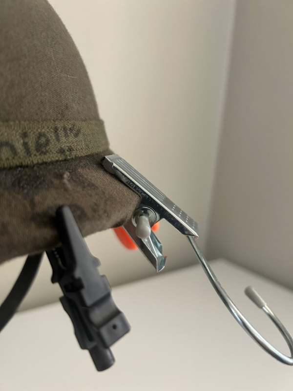

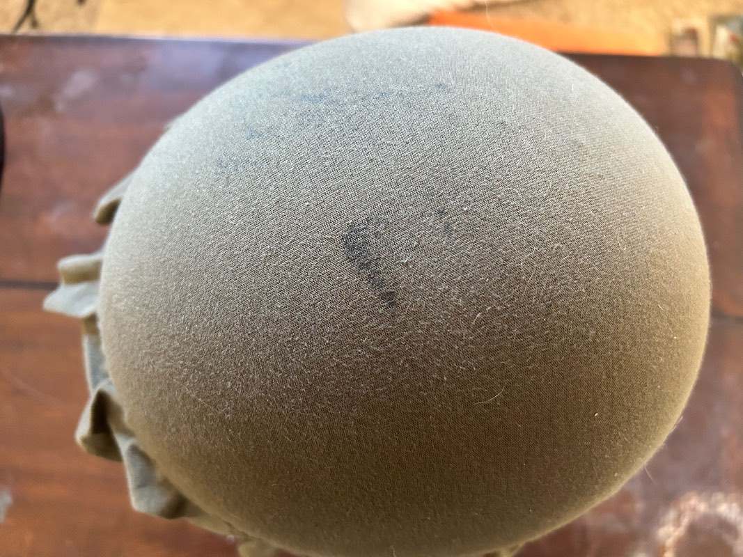

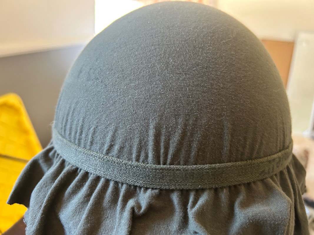

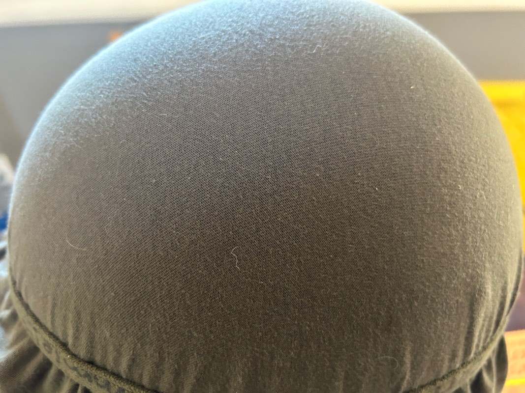

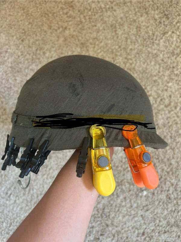

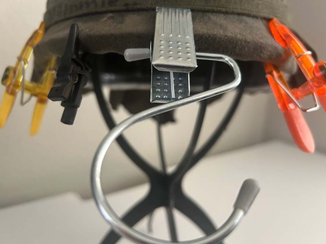

Gear Fanatic Posted June 16 Author #4 Posted June 16 Started stretching the fabric over the helmet which is by far the hardest part. Cut up and old faded OD T shirt since it’s made of stretchy material. I’m going to try to glue it slowly in multiple stretched sections so that it conforms better. I’m also fine if there are some folds as I can literally iron the out hopefully. Will also try to shrink it to the liner by soaking it in water and then drying it outside super fast. Do that multiple times and it should conform.
Gear Fanatic Posted June 16 Author #5 Posted June 16 The top is done, now onto the brim, the one part I can’t mess up. I’m honestly really worried that there are going to be wrinkles, so hopefully it turns out okay!
Gear Fanatic Posted June 16 Author #7 Posted June 16 Working in the brim some more. I will definetly have some folds, but I hope to minimize this when I’m done. So I plan on washing the fabric in warm water then putting it in the oven at about 100 degrees so it can dry at a hot heat which will shrink it to the helmet. Hopefully…

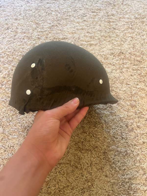

Gear Fanatic Posted June 17 Author #9 Posted June 17 Alright all, finally finished the hard part of gluing in the fabric. There was a lot of cursing in the process of making this… So today I woke up and found that all the clips on the back popped off so the back was sorta messed up as you can see and there was bunch of extra material I had to cut off and then lay over so there are 2 minor folds in the back, but there are as few wrinkles as I could get. Today I’m going to try to finish cutting the excess material around the brim and gluing it down. Then I meet do a thin over paint of the fabric because of all those glue patches. Then I need to install the mock rivets which I using thumbtacks for that I’d rolled through the center of the right and glued which really just strengthens it more. After that I need to paint the rivets a dark grayish green color similar to original ale. After that if I have time today I will try to paint the inside and make a replica ink stamp for the G at the crown and the Liner Fiber M1 stamp for ten store if the helmet. Still undecided on which model I intend to make it into, so we’ll see. Wish me luck!

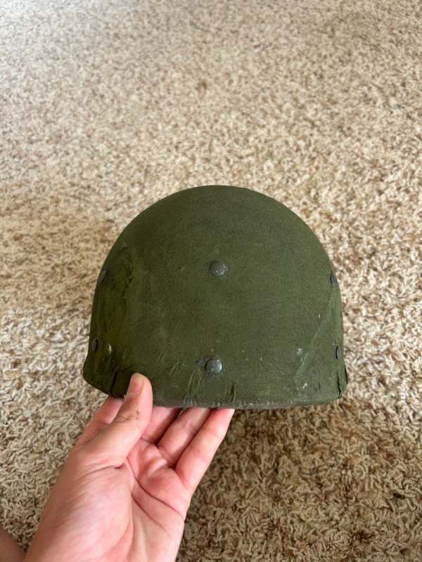

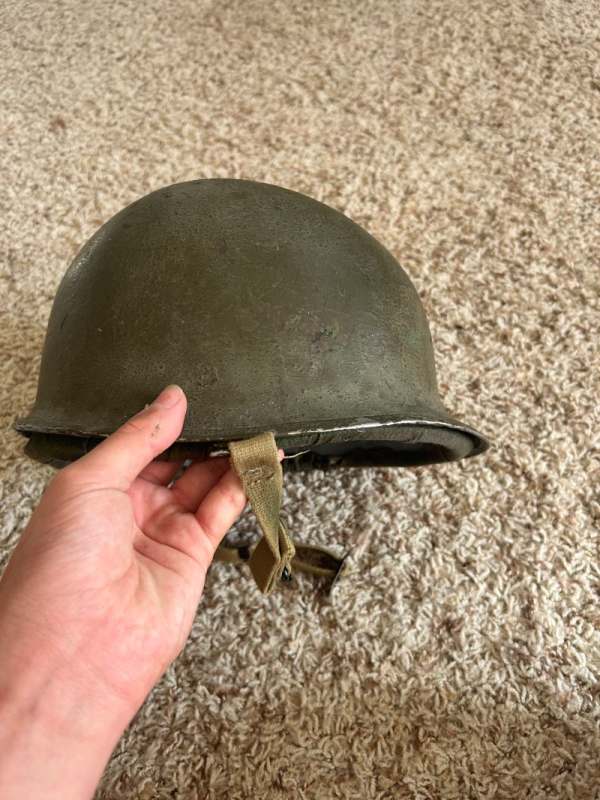

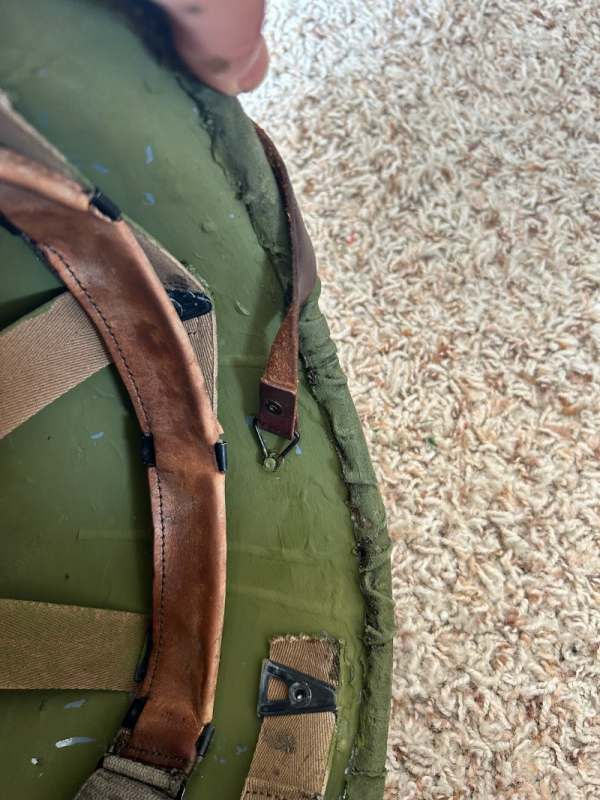

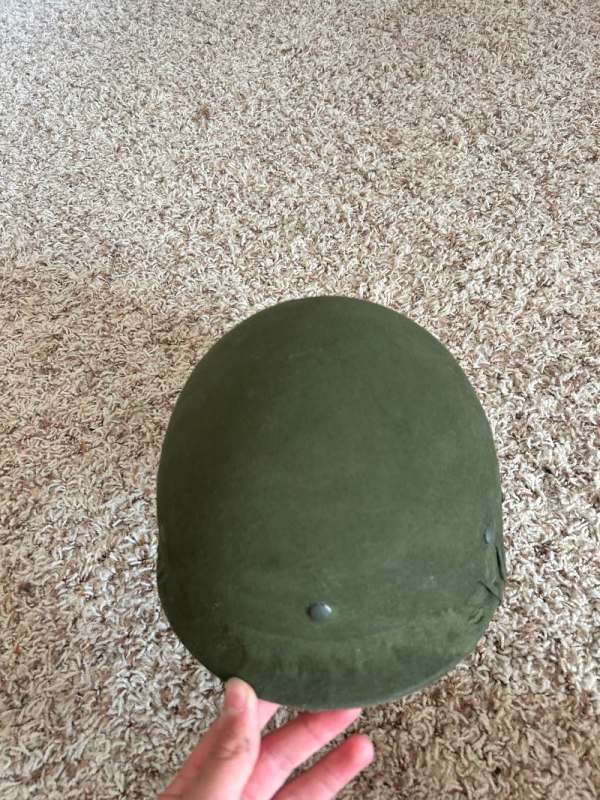

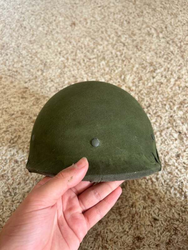

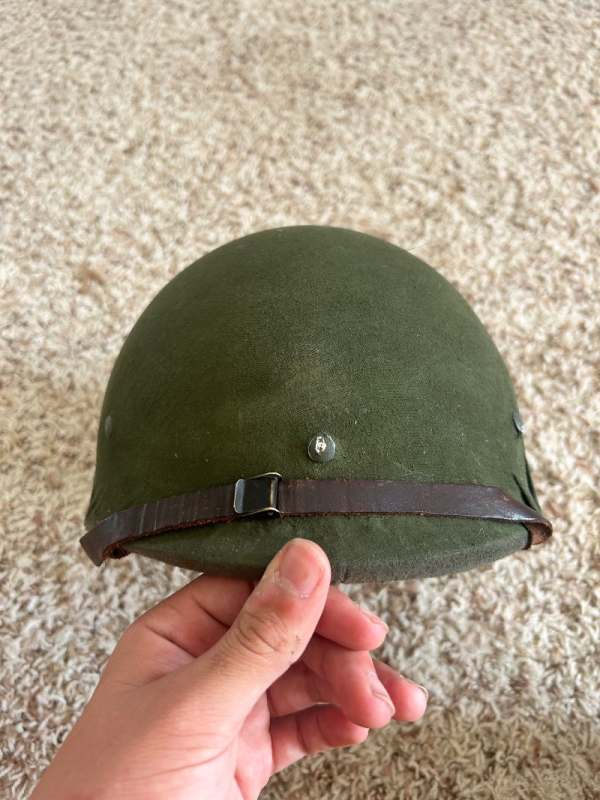

Gear Fanatic Posted June 18 Author #11 Posted June 18 alright all, the brim has now finally been put mostly in to shape as I still have to cut off some excess fabric on the inside brim. But otherwise the outside is down. I may end up stenciling my name around the bad bad ear to help “cover it up” if that’s even possible. The liner definitely has its faults, but I don’t think it looks absolutely terrible. Now the outside is basically finished. Now onto the inside!
Gear Fanatic Posted June 18 Author #12 Posted June 18 One last photo of the brim profile which is a bit more bulky than it should be, but I’m glad it’s fairly visible.

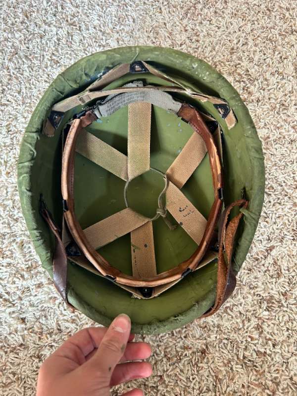

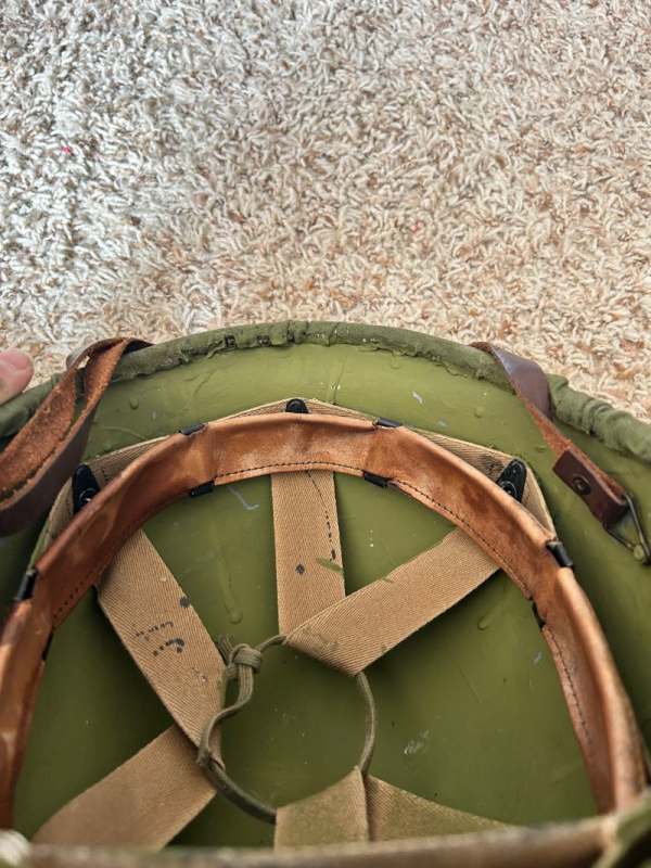

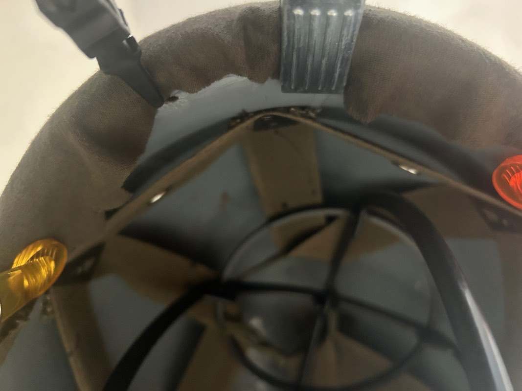

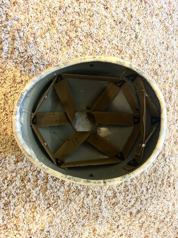

Gear Fanatic Posted June 21 Author #16 Posted June 21 Fully done 3rd pattern fiber liner is now complete. Bleached the webbing from OD7 to OD3 ish. Added a post war sweat band because I’m going to be using this a lot. Then I painted the inside, finished up the edges, added a liner chisel tarp and voila and decent standin Hawley. Turned out better than expected and super excited to show it off at my next event. Hopefully someone was at least semi interested in this and maybe this gives someone the inspiration to try it out for themselves. Hope you enjoyed the process!
