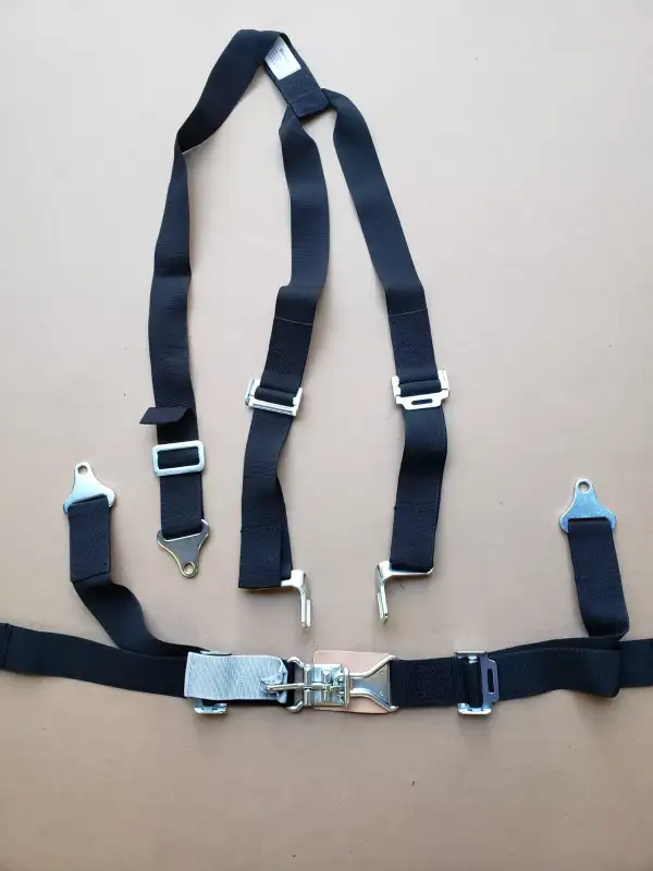

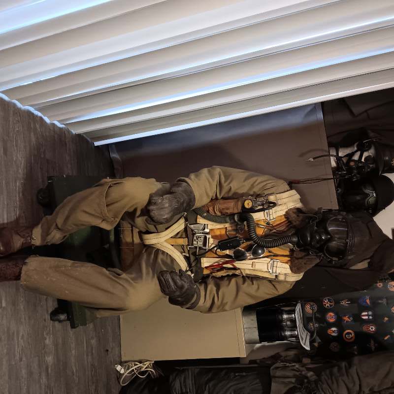

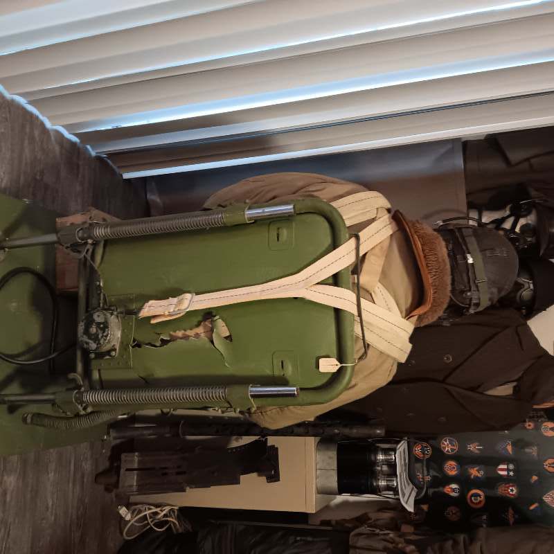

P-59A Posted Sunday at 07:13 AM #1 Posted Sunday at 07:13 AM So, the "Y" shoulder seat harness on most USAAF WW2 era aircraft seats look like this. The USN adopted this type in 1943. On the back of the seat the "Y" harness connects to the inertia reel or a spring friction action devise that allows the pilot to lean forward without being stopped. Your car seat belt harness functions the same way and has its roots in this set up. If you look at the front of the seat you will see the aircraft seat belt connected at the pilot's waist. Connected in the same belt buckle used by the seat you will see the "Y" harness connected. This is exactly the same system for the 5-point harness system as used by 4x4's, race cars and other specialty vehicles. The 5-pointsystem derives from this belt.

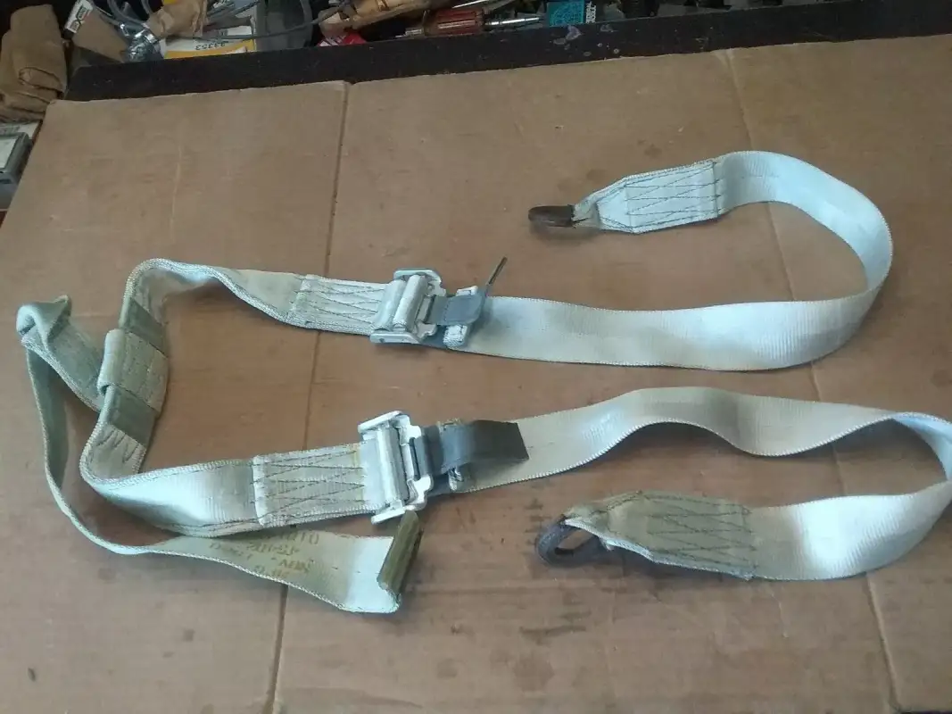

P-59A Posted Sunday at 07:19 AM Author #2 Posted Sunday at 07:19 AM This is the donor harness. This one has a 1952 contact date. I paid $40.00 for this on ebay. Look at what you're bidding on! Civilian belts may not work depending.

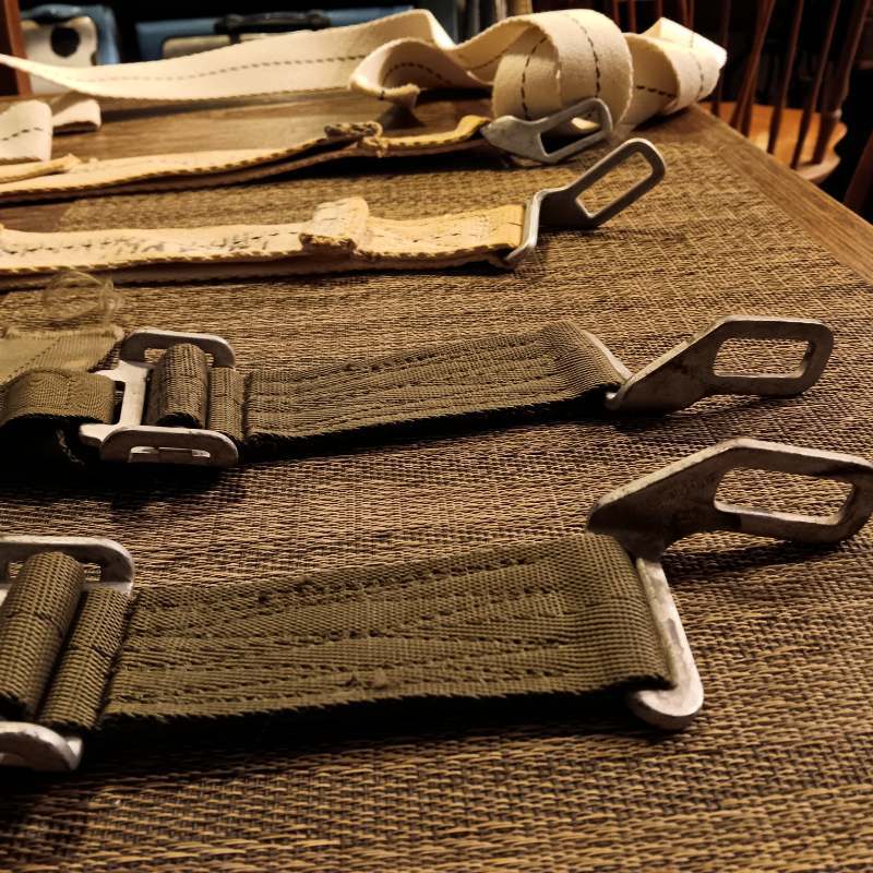

P-59A Posted Sunday at 07:30 AM Author #3 Posted Sunday at 07:30 AM The blue belt is civilian and everything on it will work for a conversion. The second belt is military, but of a newer construction. The cinch pulls will work, but it doesn't have the type connection from the "Y" to the lap belt buckle. The 3rd photo looks good, but look closer, the same problem with belt two is the same issue here. The metal attachment to the lap belt buckle is not the same as the WW2 connection.

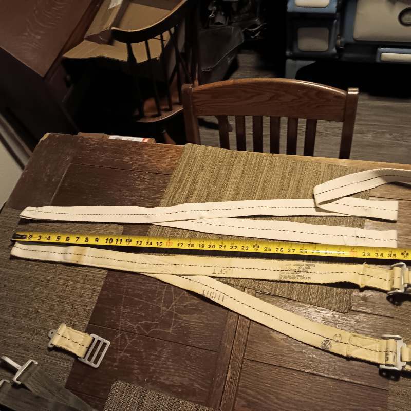

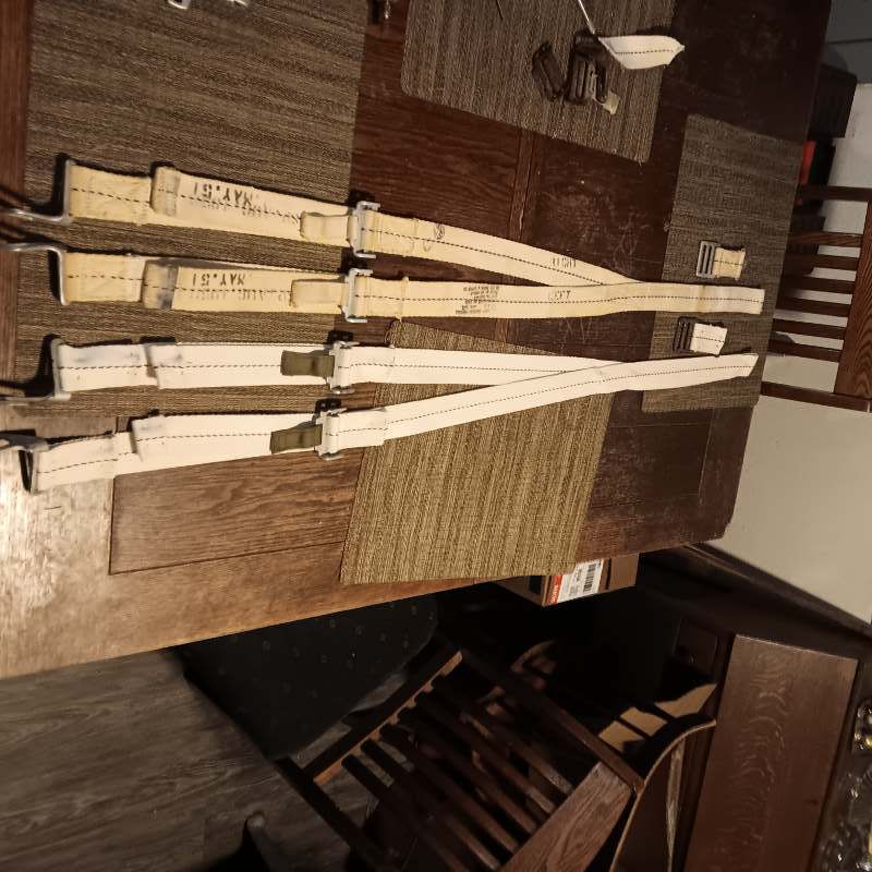

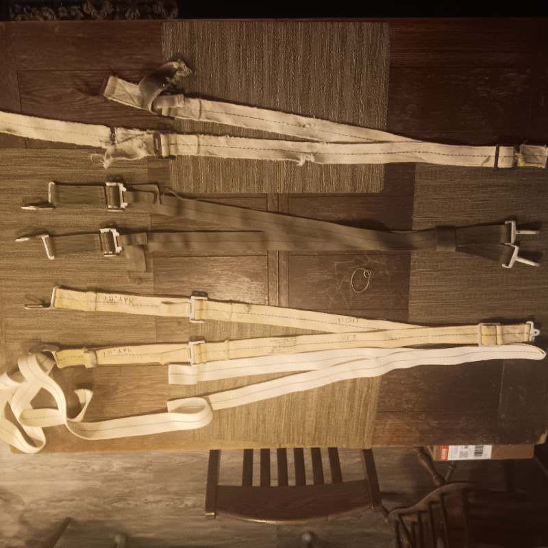

P-59A Posted Sunday at 07:39 AM Author #4 Posted Sunday at 07:39 AM The next photos compare an original WW2 "Y" cotton to webbing I found on ebay. The last photo shows a rotted out "Y" strap that I need to pull a part from. The green harness is the donor, the 3rd harness is an original. I will be pulling all of my numbers off that. The bottom is what I bought off ebay for the conversion.

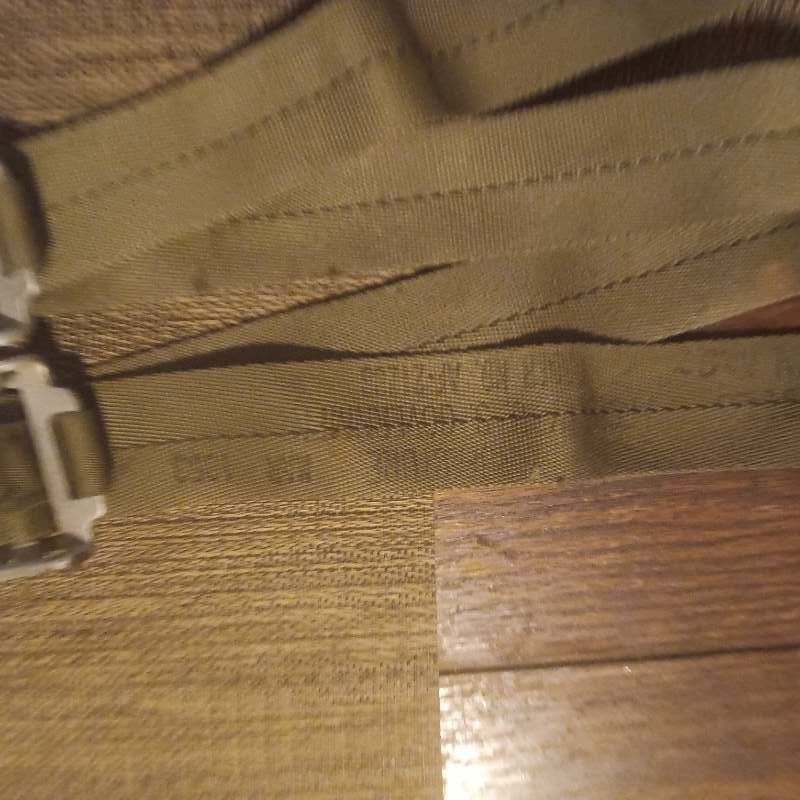

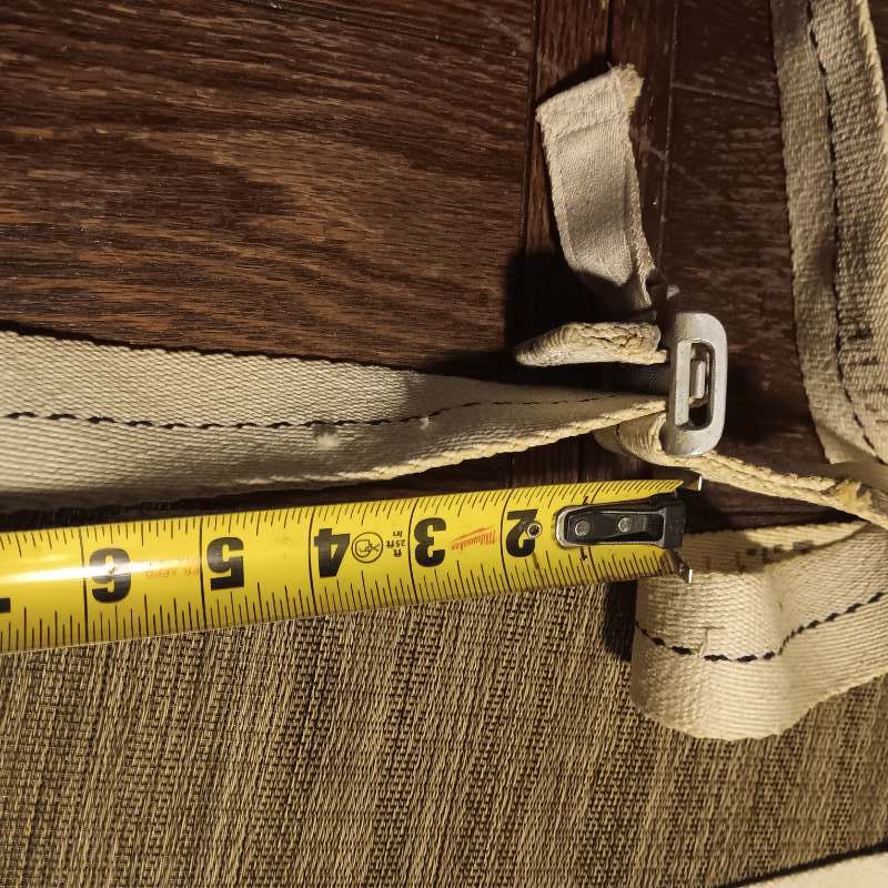

P-59A Posted Sunday at 07:44 AM Author #5 Posted Sunday at 07:44 AM This connects to the inertia reel. It disconnects and adjusts to the main harness by threading in and out of the buckle. Take note of the last two photos for construction of this tab.

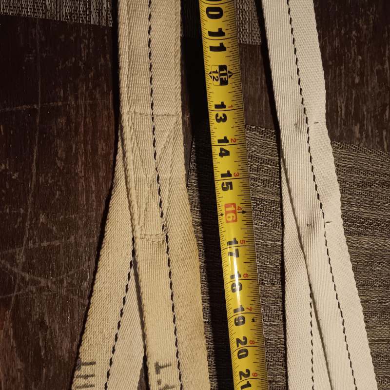

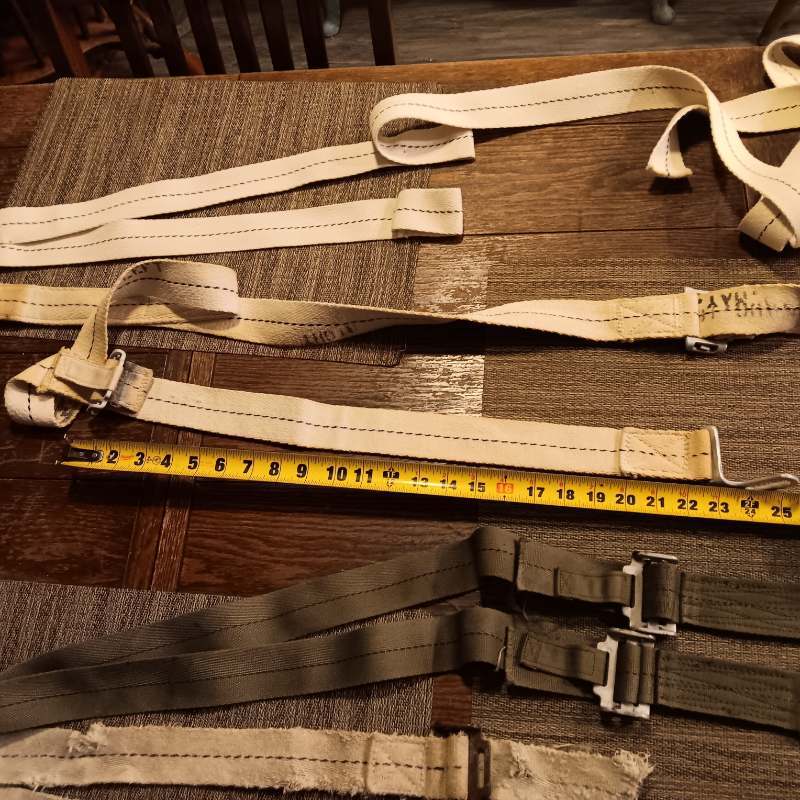

P-59A Posted Monday at 03:05 AM Author #6 Posted Monday at 03:05 AM The main run of the "Y" is doubled up from the bottom and starts it spread at 13 inches. The section from zero to 13 inches is sewn together. Note that little box stitch is what locks in the spred. The end that will hold the cinch ends at 36 inches, but folds back 3.5 inches, so the total length is 39.5 inches on both sides.
P-59A Posted Monday at 03:29 AM Author #7 Posted Monday at 03:29 AM The section that holds the lap belt attachment is a total of 29 inches long. It has a 3 inch fold back at the lap belt attachment and a fold back at the cinch.

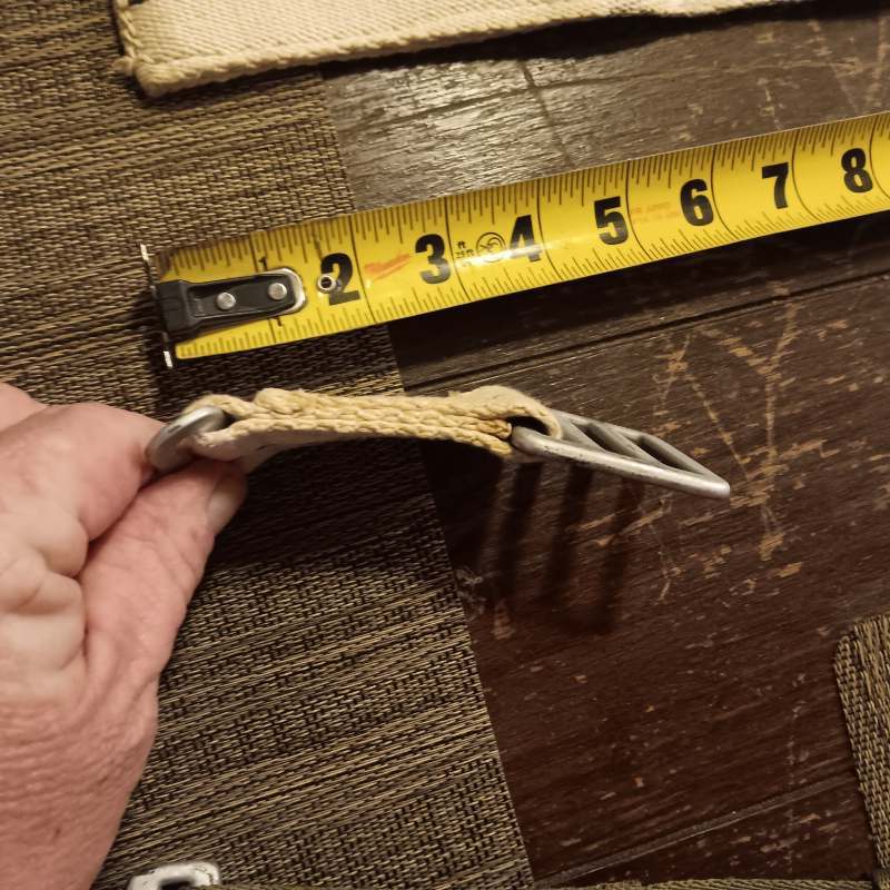

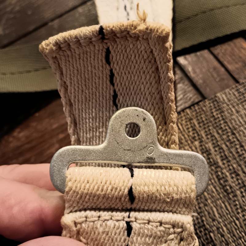

P-59A Posted Monday at 03:36 AM Author #8 Posted Monday at 03:36 AM Pay attention to how the belt attachment is set. The green harness reflects what was done post war. The white harness is what was done in WW2. I have three WW2 "Y" harnesses and they all look the same. The connection needs to look like this.
