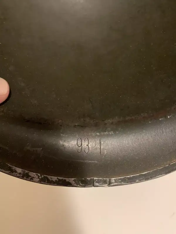

D-Day Collector Posted April 11, 2025 #1 Posted April 11, 2025 It looks like the right lot number but I don't know what the final character means. Is it manufacturers steel or something else. Any info appreciated.
502PIR Posted April 11, 2025 #2 Posted April 11, 2025 Looks lile 932 i so built in June 1944. So not used for the d day.
D-Day Collector Posted April 11, 2025 Author #3 Posted April 11, 2025 Thanks, I want to get into reanacting and was making sure that it was a real front seam M1 and not a rear seam made to look like one. Is the I a manufacturers Mark and if so which one?

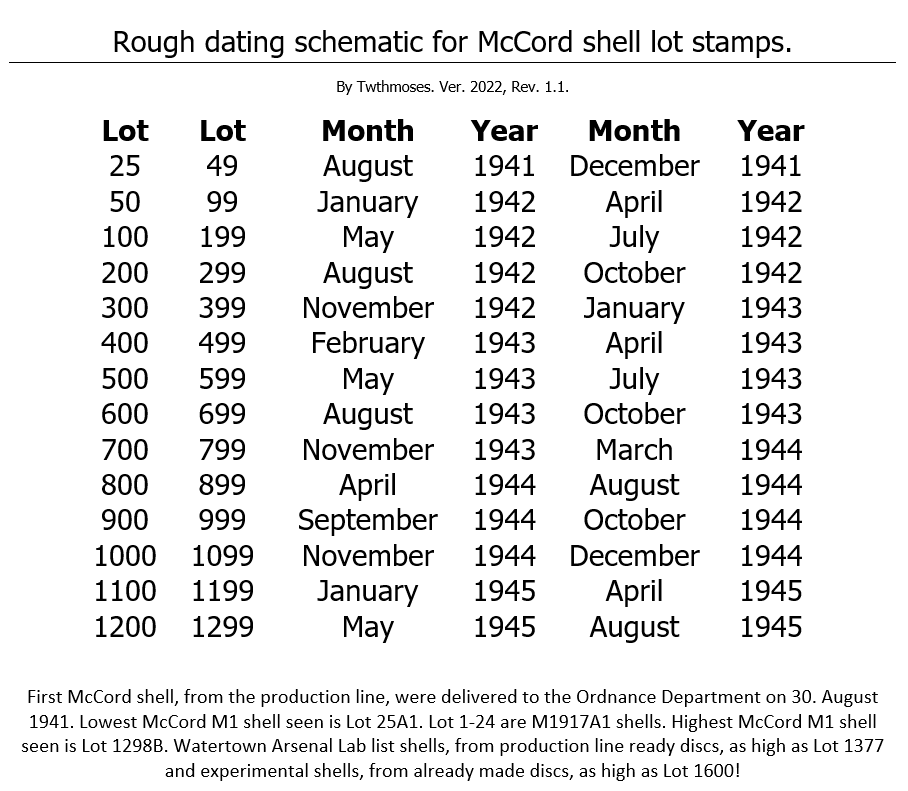

JohnK83882 Posted April 11, 2025 #5 Posted April 11, 2025 Nice basic chart. Batch number Production date 0-100 01/1941 – 03/1942 100-200 04/1942 – 06/1942 200-300 07/1942 – 09/1942 300-400 10/1942 – 12/1942 400-500 01/1943 – 04/1943 500-600 05/1943 – 08/1943 600-700 09/1943 – 10/1943 700-800 11/1943 – 02/1944 800-900 03/1944 – 05/1944 900-1000 06/1944 – 08/1944 1000-1100 09/1944 – 11/1944 1100-1200 12/1944 – 02/1945 1200-1300 03/1945 – 06/1945 https://second-worldwar.com/m1-helmet-shell-dating-heat-stamp/
aef1917 Posted April 11, 2025 #6 Posted April 11, 2025 1 minute ago, JohnK83882 said: Nice basic chart. Batch number Production date 0-100 01/1941 – 03/1942 100-200 04/1942 – 06/1942 200-300 07/1942 – 09/1942 300-400 10/1942 – 12/1942 400-500 01/1943 – 04/1943 500-600 05/1943 – 08/1943 600-700 09/1943 – 10/1943 700-800 11/1943 – 02/1944 800-900 03/1944 – 05/1944 900-1000 06/1944 – 08/1944 1000-1100 09/1944 – 11/1944 1100-1200 12/1944 – 02/1945 1200-1300 03/1945 – 06/1945 https://second-worldwar.com/m1-helmet-shell-dating-heat-stamp/ The article I linked has a few lots with known stamping dates and none of them line up with this, so exercise caution.

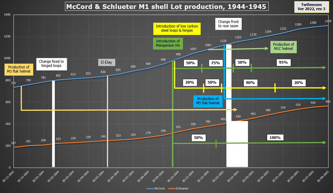

twthmoses Posted April 13, 2025 #7 Posted April 13, 2025 On 4/11/2025 at 11:28 PM, aef1917 said: The article I linked has a few lots with known stamping dates and none of them line up with this, so exercise caution. Indeed. The above list is only semi correct. Also note in the article the dates for lots 863 and 865 are, probably, a writing mistake. It’s not 19 Aug 1944, but 19 July 1944. So says the source. Here are two better.
The Rooster Posted April 13, 2025 #8 Posted April 13, 2025 Were the Manufacturers still making front seam stainless rims in late 1944?
twthmoses Posted April 13, 2025 #9 Posted April 13, 2025 1 hour ago, The Rooster said: Were the Manufacturers still making front seam stainless rims in late 1944? Change happen in feb 1944.
twthmoses Posted April 13, 2025 #10 Posted April 13, 2025 2 hours ago, The Rooster said: Were the Manufacturers still making front seam stainless rims in late 1944? Sorry misread your post in my previous reply. Fixed to hinged loops happened in feb 44. Front to rear seam happened in feb 45. So yes front seam was still going strong in late 44. In fact most of the war is front seam shells.
