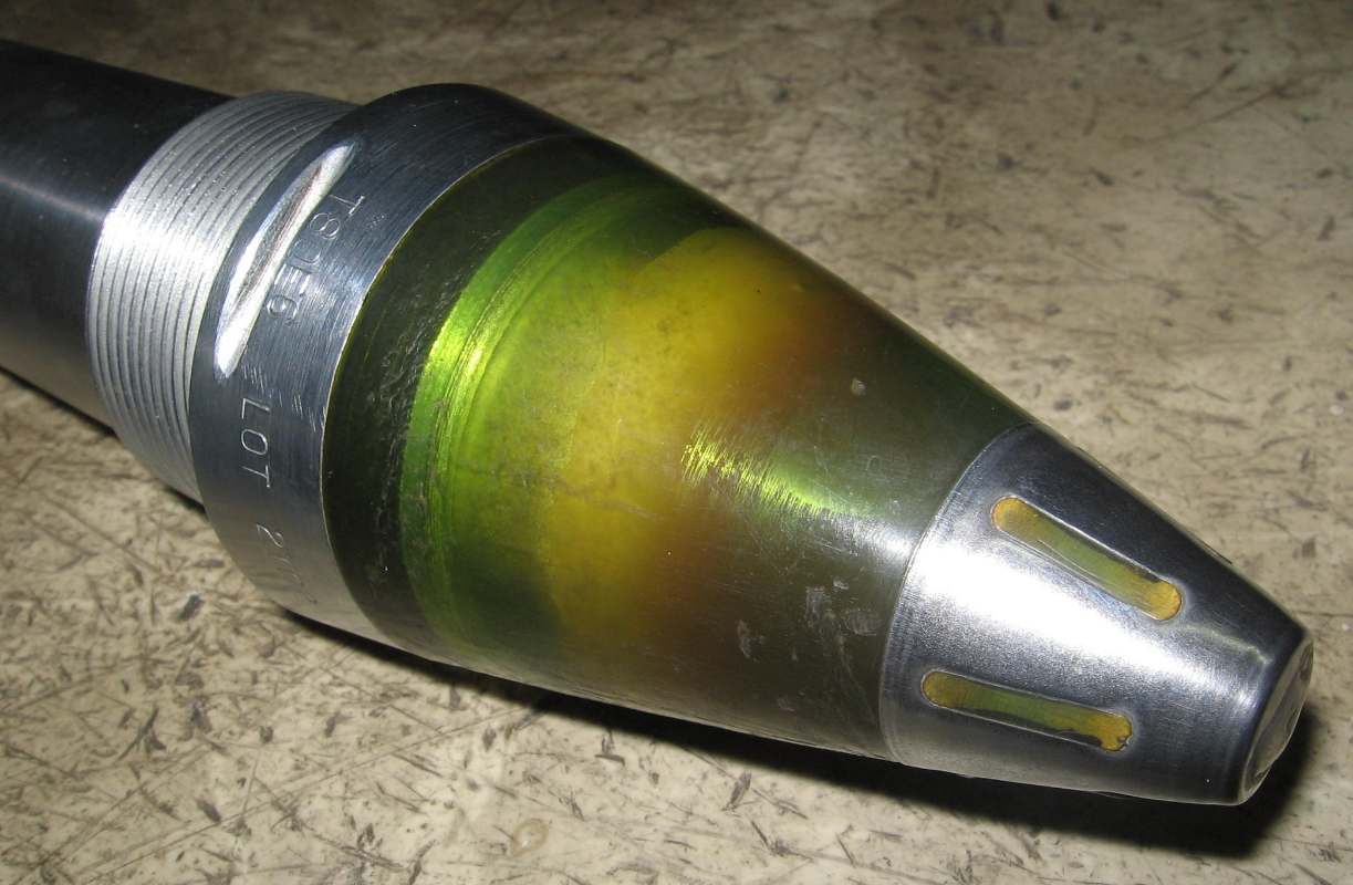

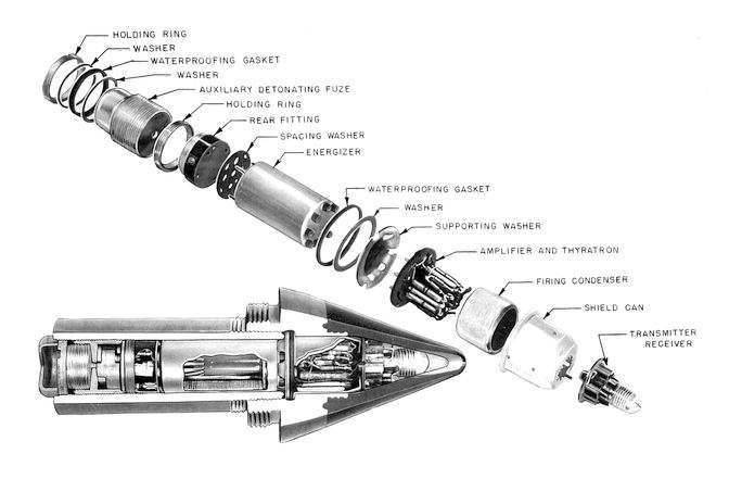

OK, I'll show some photos of mine. First a schematic of the components.

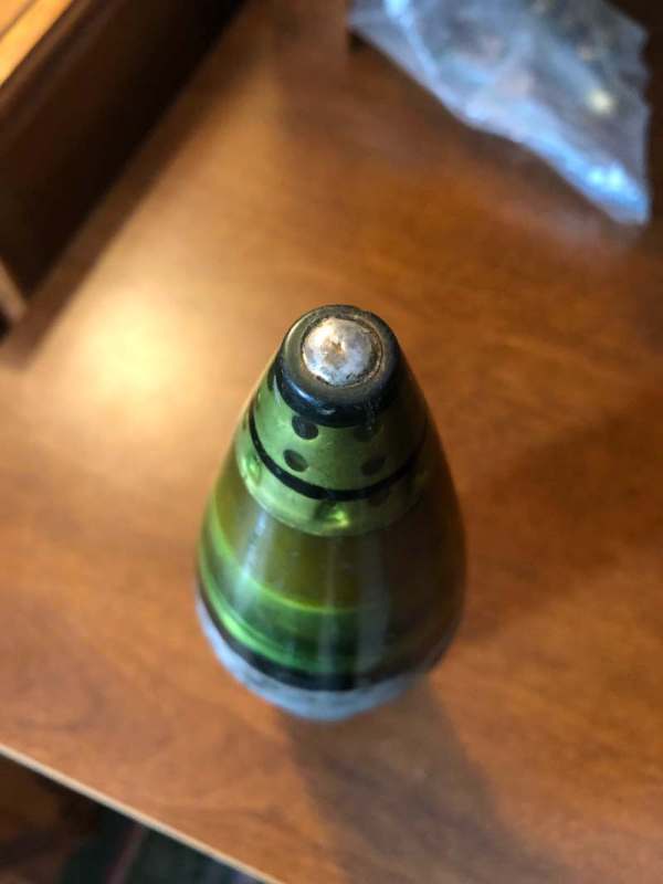

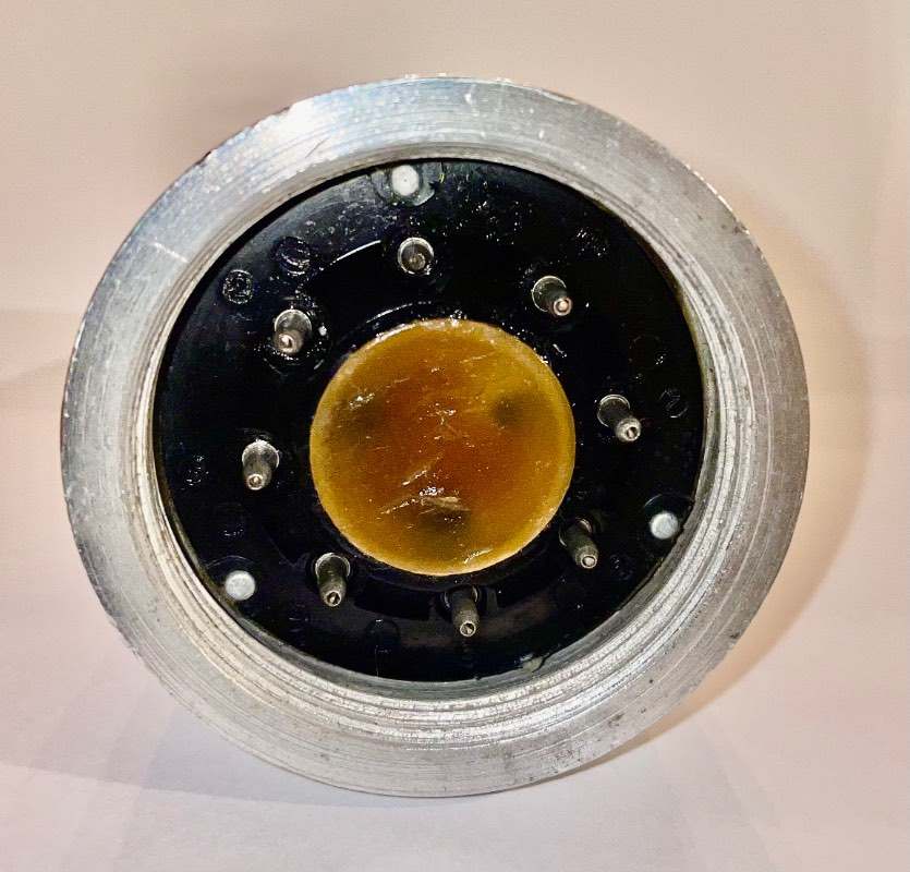

My example. The top part with the electronics and outer green leucite shell is complete. Unfortunately, the bottom half is hollow, which would have contained the battery pack, charger and explosive detonating fuse. The hollow tube, I am not sure it is correct and just missing the components or was fixed to allow for the fuse to screw into a standard 75mm-105mm HE artillery shell.

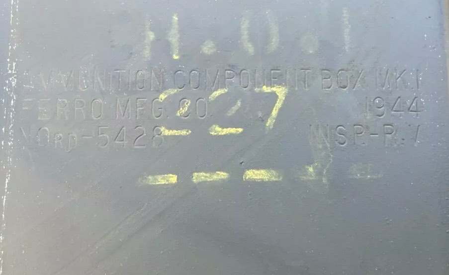

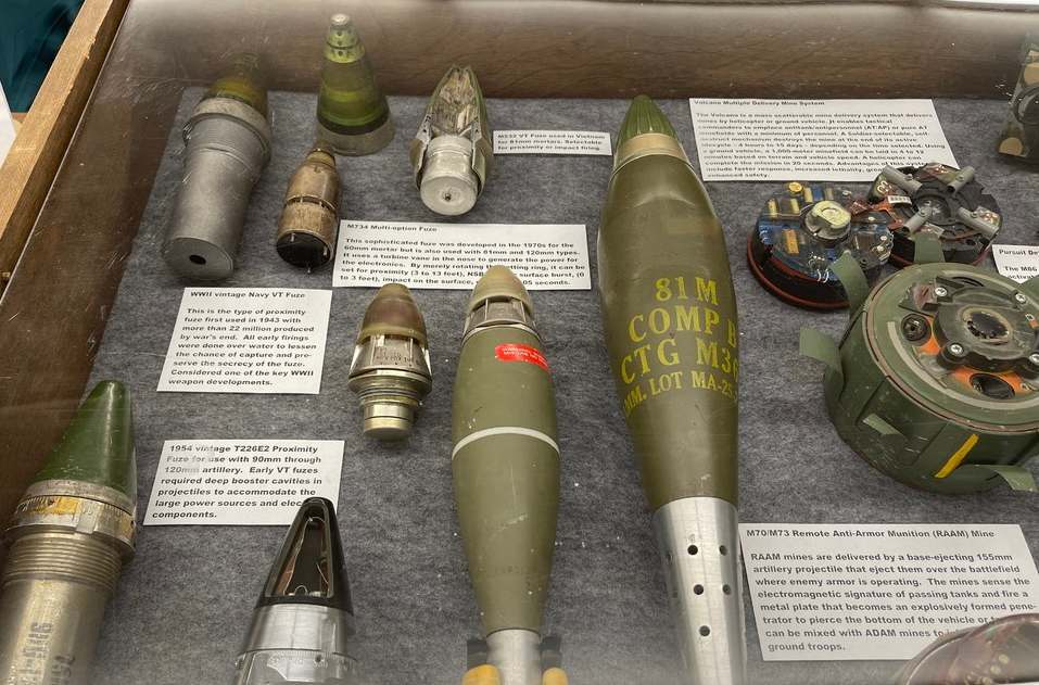

I also have a couple Navy types as shown in the photo from a display I did on battlefield electronics but have searched for years for my Holy Grail, a T80E6.  This was the Army version first used in late 1944 in the defense of Antwerp and the Battle of the Bulge in 75mm and 105mm howitzers.  VT fuzes had previously been used only over water to avoid capture by enemy forces.  At the Bulge they were particularly effective air bursting explosive shells over the heads of German troops where foxholes or open top vehicles provided no protection.
I was lucky enough to pick up a proper 105mm HE projectile a couple years ago, 1945 dated with a deep fuze pocket and marked for VT fuze. But the search for the fuze to complete it goes on.  The images of the T80E6 and can are from a couple different European museums.  Note the markings on the can describing the contents as a PD (point detonating)  fuze.  It obviously was not but was intentionally mis-marked  to confuse the enemy if stocks were observed or captured.

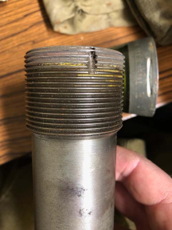

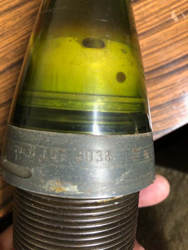

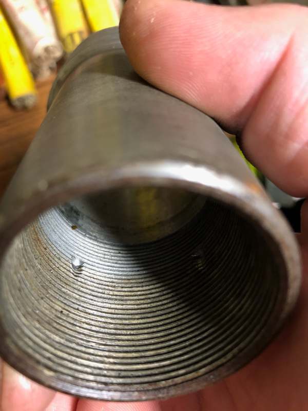

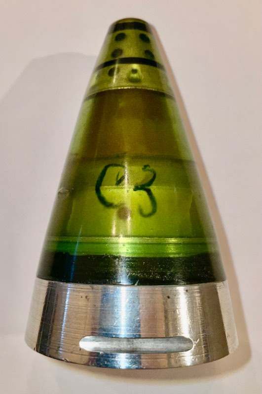

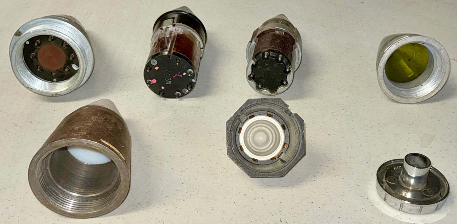

I picked up a few interesting ones recently.  Does anyone know when they date from and what type of shell they go with?
Persian Gulf Command
I'm guessing some are post-WW2 proximity fuze parts including some nose cones. The one in the upper left could be the radio unit of a late WW2 model. Here is the caveat, the U.S. gave its proximity fuze information to the Russians after the war in Europe ended. They copied our designs exactly so could the one on the upper left be a Russian copy?
Thanks for the info.  That’s interesting,  I didn’t realize we gave this info to the Soviets.
