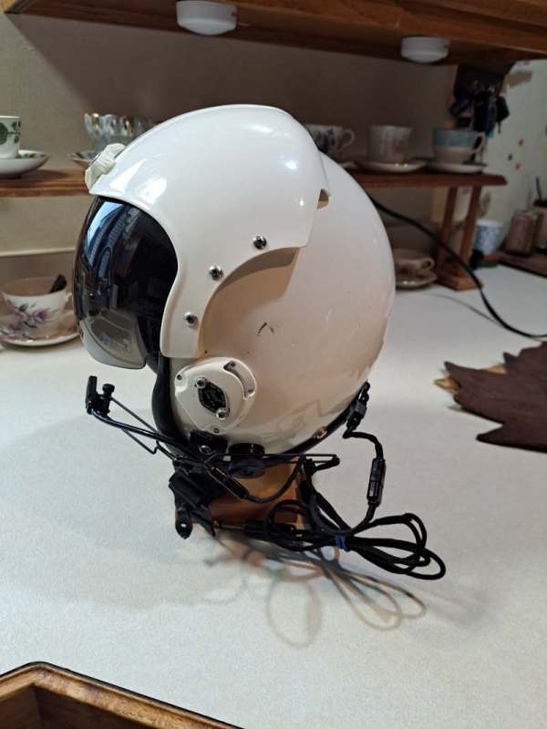

HUD69 Posted November 24, 2024 #5 Posted November 24, 2024 A good "hint" could be the position of the comm cord coming from the helmet shell. In this case further back then on your usual HGU-2 or 55. So that might indicate an PRK-37 shell (as the HGU-33/P is just a version of that helmet shell) It seems it is fitted out with GA comm? Cheers, Ron
HUD69 Posted November 25, 2024 #8 Posted November 25, 2024 On 11/24/2024 at 5:45 PM, AMT500E said: Maybe Flightsuits LTD - 33p It that's the case, there should be a label on the inside. But I doubt it, as the bayonet receiver plates don't show Flight Suits. (looks like Scott or Sierra)

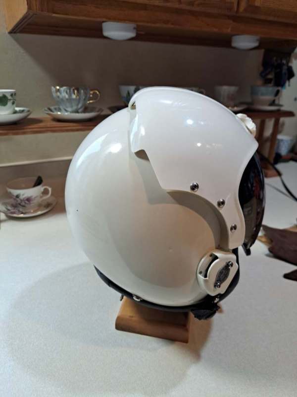

FlightGearSTL Posted December 17, 2024 #9 Posted December 17, 2024 Nice PRK37. Not a FSL or the comm location would be on the side. Does it have styro liner and pads or a form fit liner?
amateuraero Posted January 27 #10 Posted January 27 With the Sierra mask receiver plates, can not rule out the the helmet is the earlier Sierra PRU-37/P shell assy. that was introduced during the mid-late 1970s before the PRK-37/P shell. The vast majority of the PRK-37/P helmets that I have seen and had had mask receivers by Gentex/GENTEX and SCOTT. There could be a label underneath the visor housing also. I am almost certain the PRK-37/P was introduced 1979-1980. Nice helmet. The Gentex HGU-33/P, Gentex/Scott PRK-37/P (there was a HGU-33/P configuration with this shell), Sierra PRU-37/P, Protection Inc. and Sierra custom helmets can look very similar. Also modified APH-6 series and HGU-22/P shells with leather edge rolls can look similar also. There was a helmet matrix chart for the HGU-xx/P variants of the PRK-37/P shell. I do not know if there was one for the PRU-37/P. Also VTAS helmet shells and modified helmet shells for the VTAS that were converted back to non-VTAS applications can look similar to the HGU-33/P style. Almost forgot to mention the Gentex DH-151 helmet shell with leather edge roll, etc. ...

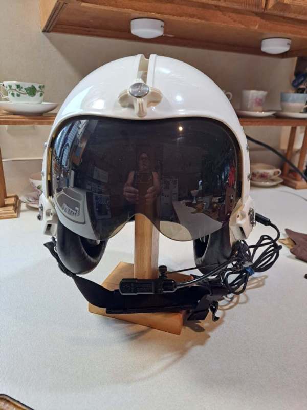

Mikeym_us Posted January 27 #11 Posted January 27 On 11/18/2024 at 4:59 PM, phantomfixer said: I’m going with a 33… too pretty for a 2😁👍✌️ I'm seeing earcups in there so it probably has a foam impact liner PRU-40. So safe bet HGU-34 as that has the foam impact liner and earcups. HGU-33 form fit liner and leather covered earpuds.
