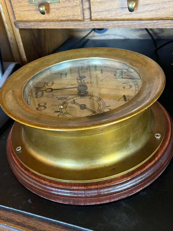

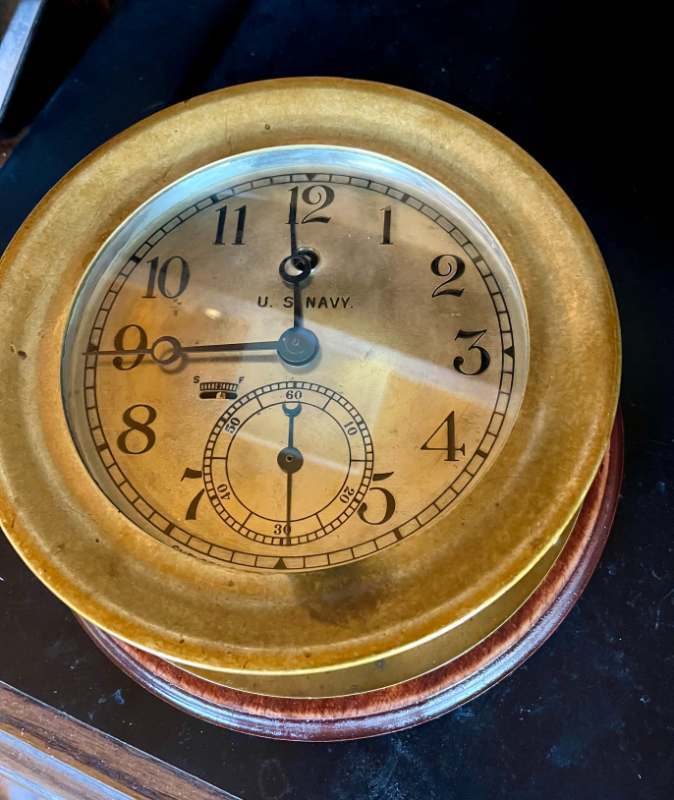

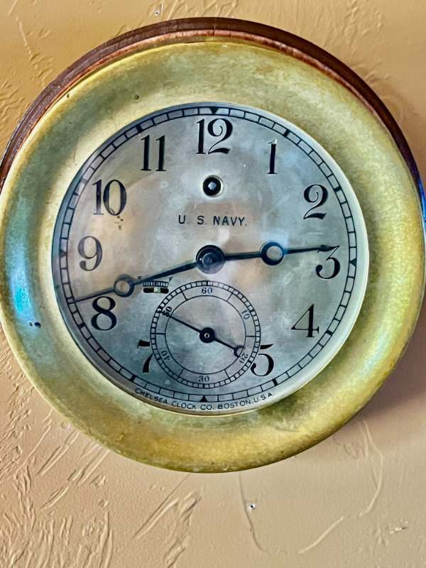

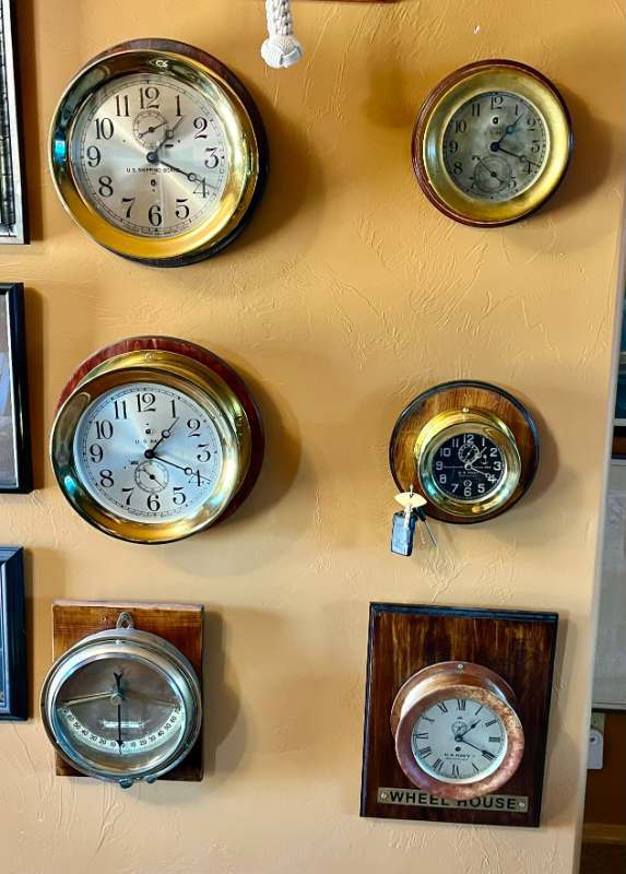

River Rat 1 Posted August 30, 2024 #1 Posted August 30, 2024 Just got this today. It's the smaller brother of two other Pilot house clock I have in the collection. The larger ones have a 8-inch dial this one's a 6-inch dial with a screw off bezel not hinged bezel. Has the same style dial with the large second bit and model F movement and very heavy. Have it on the wall with other WW1 veterans.
River Rat 1 Posted November 21, 2024 Author #2 Posted November 21, 2024 Well had this serviced but had to take it back the clockmaker to adjust the fast and slow adjustment was lose. I had to look at the movement to figure what was wrong. Doing that I notice something scratched inside the case engine room so this was in the engine room not the pilot house how wonder the dial a little dirty the heat and smoke down in the engine room did to the dial. The snipes that worked in the engine room on my last ship the USS Mauna Kea AE-22 painted the boiler to look like a Budweiser can.

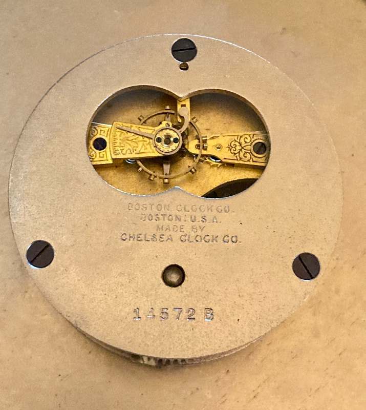

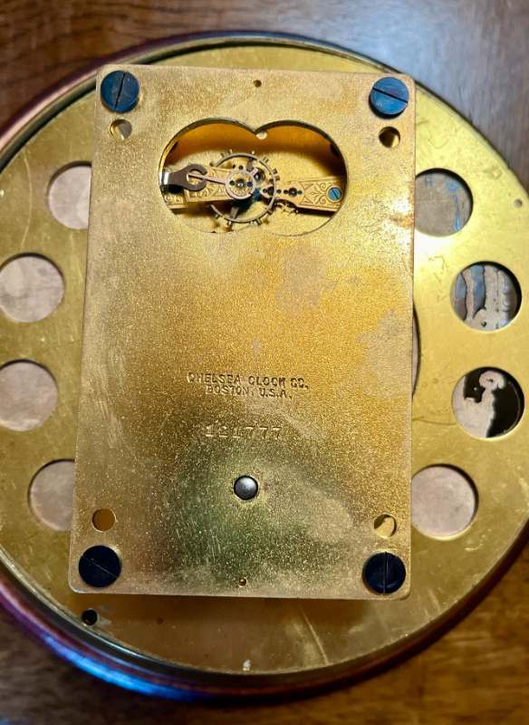

River Rat 1 Posted December 8, 2024 Author #4 Posted December 8, 2024 The movement was in great shape.
Josh B. Posted December 10, 2024 #5 Posted December 10, 2024 My grandfather was a clock and watchmaker who serviced these for the submarine base in New London many years ago. He commented on how overbuilt the movements are. The big problem with these arises when they aren't serviced for a long time; the extremely strong spring will drive the clock mechanism no matter how dirty or dry the movement is. The grit then wears pivot points in the brass plates oblong, leading to irreparable wear requiring re-bushing or complete overhaul with new plates. Lots of these clocks were shown zero love after their regular overhaul periods in the service were over, especially if they found their way into the merchant fleet. Btw, I have several chelsea and seth thomas maritime clocks- can I ask where you source your mounting plaques? I want to hang some but as you know they are quite heavy and want to put them on wood plates so I can keyhole mount them flush to the wall. Cheers, Josh

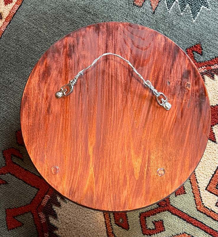

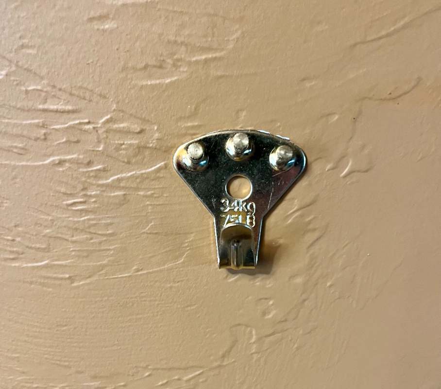

River Rat 1 Posted December 10, 2024 Author #6 Posted December 10, 2024 I get them at Micheal's arts and craft there a chain store. Thier bare wood I will sand them and varnish them and put mounting stuff on the backs of the plaques. There are mounting kits the kits I pick depends on weight of clock and the wall hanging hooks. Never use a lightweight hook or it might not hold the clock. My pilot house clocks are extremely heavy. If you want, I can post a back photo of the clock plaque to see how I do it. On the heavy brass clocks, the hook goes into a stud in the wall.
River Rat 1 Posted December 11, 2024 Author #7 Posted December 11, 2024 To hang real heavy clocks. I use a stud finder to find the wooden stud in the wall. I use a 75-pound hook. Use heavy duty picture frame wire with heavy rated connecting hardware to secure the wire to the plaque. See photos hope this helps. You don't want to use just dry wall to put the hooks in on heavy clocks it will just rip off the wall. Light smaller bakelite case clocks you can but not the heavy brass pilot house size clocks nothing worse than one hitting the floor. In the stud for the hook. Some hanging kits come with pads you can put on the back of the plaque, so it doesn't slide around and don't scratch the paint on the wall. You can see I doubled up the wire on this one.

aerialbridge Posted December 13, 2024 #12 Posted December 13, 2024 River Rat's Chelsea WW1 era Marine Mechanical clock movement.

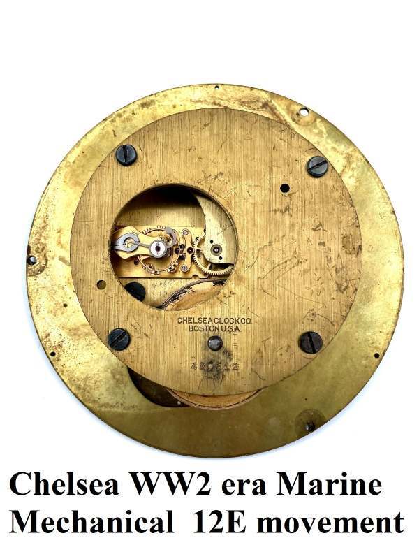

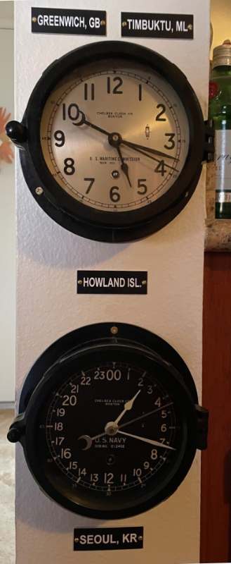

aerialbridge Posted December 13, 2024 #13 Posted December 13, 2024 You can compare this WW2 Era Chelsea 12E Marine Mechanical movement to the WW1 era Chelsea Marine Mechanical Clock movement that River Rat posted above. Completely different escapement, and sweep second hands vs. a seconds hand sub- dial. The WW2 Navy Chelsea's with black dials and white numerals should have white hour and minute hands and a silver sweep second hand. You can regulate them with the F and S dial.

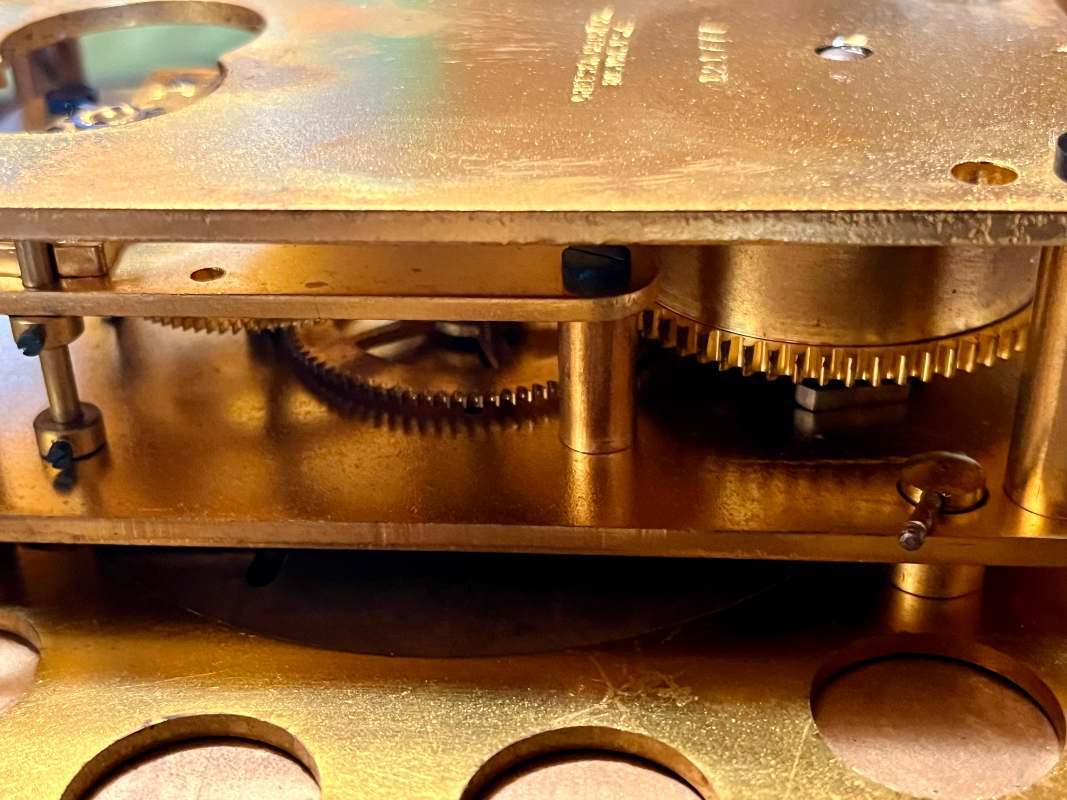

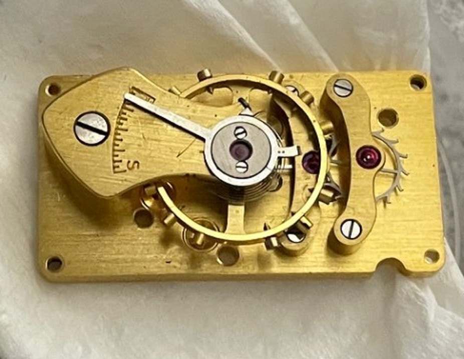

aerialbridge Posted December 14, 2024 #15 Posted December 14, 2024 Here's a close look at the platform escapement of a WW2 era Chelsea Marine Mechanical 12E movement. From wiki- "An escapement is a mechanical linkage in mechanical watches and clocks that gives impulses to the timekeeping element and periodically releases the gear train to move forward, advancing the clock's hands. The impulse action transfers energy to the clock's timekeeping element (usually a pendulum or balance wheel) to replace the energy lost to friction during its cycle and keep the timekeeper oscillating. The escapement is driven by force from a coiled spring or a suspended weight, transmitted through the timepiece's gear train. Each swing of the pendulum or balance wheel releases a tooth of the escapement's escape wheel, allowing the clock's gear train to advance or "escape" by a fixed amount. This regular periodic advancement moves the clock's hands forward at a steady rate. At the same time, the tooth gives the timekeeping element a push, before another tooth catches on the escapement's pallet, returning the escapement to its "locked" state. The sudden stopping of the escapement's tooth is what generates the characteristic "ticking" sound heard in operating mechanical clocks and watches." They don't call that a hairspring for nothing. Most clockmakers won't bother with the work and tools involved to disassemble it and work on it if something is broken. There are guys who just specialize in repairing these, as many clockmakers will "sub that (work) out".

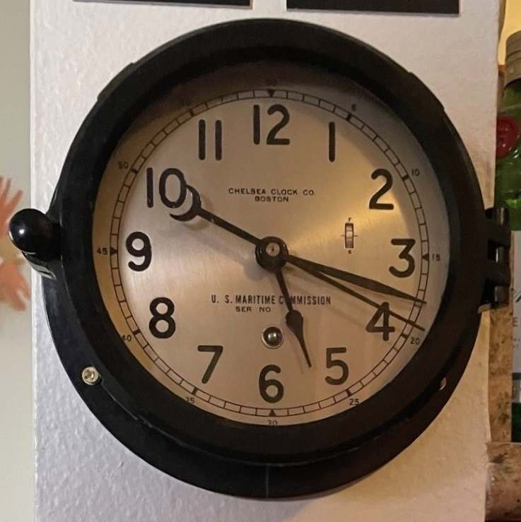

Josh B. Posted December 16, 2024 #16 Posted December 16, 2024 On 12/13/2024 at 2:17 PM, aerialbridge said: Josh, it would be great to see that unique Chelsea clock in the 20s brass case with the 1930s dial that your grandfather gave you from the clock shop at SubBase New London, if you want to post it. As you know, when you write Chelsea to get a clock "birth certificate" they ask you to send both a picture of the movement serial # from the brass back plate and also the picture of the serial number hand etched on the back of the case for the phenolic and I believe stamped on the backs of the metal cases. River Rat, that's interesting that while they didn't initially send a certificate covering both case and movement where you had a marriage, they did when asked and gave delivery info for each. If not too much trouble, I'd be interested to see what that certificate from Chelsea looks like. Here you go! This is a photo from over 15 years ago and the backside shot I have looks like a thumbnail now and dont think it's useful here. You can see the dial was borrowed from a rear-winding deck clock, and an new hole was punched through the face to accommodate the mated movement's winding arbor. Note the seconds sub dial and even more amazing, the lever F/S adjustment that also needed to be mated up on this dial replacement. Chelsea had dated the case to the 1920s already and the naval observatory cartouche on the dial, said that part dated from the preWWII era. The hands may have been modified too. Chelsea clock images.pdf
Josh B. Posted December 16, 2024 #17 Posted December 16, 2024 JPEGS, but they're small. The PDF above has larger images. I don't know where the high-quality JPEGs went on my hard drive...sorry.
Josh B. Posted December 16, 2024 #18 Posted December 16, 2024 On 12/13/2024 at 2:17 PM, aerialbridge said: In the meantime, as an aside to Josh being a sub vet and his grandfather working as a contractor at the New London Sub Base, Please don't confuse me as a Veteran- I do not hold that distinction. My grandfathers on both sides were servicemen, and I grew up alongside both. One was in the submarine service (Senior Chief Petty Officer ) from Korea past Vietnam, then worked at Electric Boat in management for his second retirement. The other was 5th Army Airforce from end of WWII through early occupation (T-Sgt). After he returned home from Japan in 1947, he entered Waltham Watch's training school where he became certified in watchmaking. He was a phenomenal machinist and pursued clock-wheel cutting and brass stamping in parallel with watches and clock repair. He ran the clock/engraving and jewelry group at the NEX at NLON for around 15years, I believe. When they dissolved the clock and watch part of the operation, he continued servicing clocks from his own independent shop about 25 minutes from the Navy Base. My interest in militaria comes from growing up with both men, hearing their stories, and of course hanging out all of their ex-servicemen friends who were close to our family (and who gave me stuff from their service time). I watched several nuclear subs slide down the ways at EB as a family guest, so that didn't hurt either! On 12/13/2024 at 2:17 PM, aerialbridge said: In my small Navy medal collection, I'm fortunate to own the full sized medals of the first commander at New London, CDR (later RADM) Yates Stirling, Jr. One day, I'll get around to posting those, but probably after I have them professionally reribboned to carefully match the lengths of the original ribbons, which are in tatters, with only two or three of the original seven medals still attached. I was able to purchase these through the goodness of another forum member, who acted as intermediary for the overseas collector who had last bought them at an auction. Unfortunately that foreign collector, given the substantial price I paid, was not considerate enough to send them in a Riker's mount or even try packing them carefully, so they arrived with the fragile ribbons trashed and mostly detached from the medals. Regardless, I'm glad to have Stirling's medals back in the USA, as I know he would have wanted, being the America First guy that he was. What a fantastic pickup. The Stirling family had storied run with the USN. Love to see them once you "fix" them. What a shame about the ribbons, but at least these medals still exist and weren't lost to time.
aerialbridge Posted December 16, 2024 #19 Posted December 16, 2024 Josh, that's a great clock. Looks like a Chelsea Mark 1 Deck Clock dial from the late 30s or early 40s put in a 20s case, just like you said. My buddy and I refer to the Chelsea and ST nickel plated brass cases for the Mark 1 Deck clocks before they went to the Phenolic to save the brass as "bunker busters". I'm glad you're familiar with the Stirlings. Absolutely, after I get them restored I'll send you a high res jpeg. Next to my mustang great-uncle's WWI M1852 sword and scabbard with his name acid etched by the Philly Army Navy store he bought it from, and the Dewey medal to the gun captain on Olympia who fired the first shot, the Stirling group of seven is top of my list. In case you're interested, Stirling's entertaining autobiography, "Memoirs of a Fighting Admiral", published in 1939, three years after his mandatory retirement at 64 is in the public domain and digitized for reading. https://penelope.uchicago.edu/Thayer/E/Gazetteer/People/Yates_Stirling/Sea_Duty/home.html
Josh B. Posted December 16, 2024 #20 Posted December 16, 2024 8 minutes ago, aerialbridge said: Josh, that's a great clock. Looks like a Chelsea Mark 1 Deck Clock dial from the late 30s or early 40s put in a 20s case, just like you said. My buddy and I refer to the Chelsea and ST nickel plated brass cases for the Mark 1 Deck clocks before they went to the Phenolic to save the brass as "bunker busters". I'm glad you're familiar with the Stirlings. Absolutely, after I get them restored I'll send you a high res jpeg. Next to my mustang great-uncle's WWI M1852 sword and scabbard with his name acid etched by the Philly Army Navy store he bought it from, and the Dewey medal to the gun captain on Olympia who fired the first shot, the Stirling group of seven is top of my list. In case you're interested, Stirling's entertaining autobiography, "Memoirs of a Fighting Admiral", published in 1939, three years after his mandatory retirement at 64 is in the public domain and digitized for reading. https://penelope.uchicago.edu/Thayer/E/Gazetteer/People/Yates_Stirling/Sea_Duty/home.html Yeah they weigh a ton. I have two other "heavy" bronze Chelsea's; both radio room clocks in blackened bronze finish with screw bezel cases and US Maritime Commission dials on them. I don't recall seeing that exact combination in Whitney's book, but its been many years since I last looked. I also have a WWII USN Chelsea Ships bell in a metal case that badly needs an overhaul. You don't see too many of those- I think the case was some kind of Zinc alloy. I have another ships bell, much cleaner, by Seth Thomas too but can't remember if it was USN or US Maritime Comm signed. And several phenolic case Chelsea's with straight time US Maritime Commission dials in various sizes. I gave a couple of those away as gifts over the years; one to family and one to an old boss who treated me well and who owned a few boats. My wife has said we need to put together the clock and barometer wall, then maybe decide to part with the rest. I'm getting there....hahaha. Thanks too for the link on the Stirling Memoir. Believe it or not, an official period copy of the original property deed/ sale of the land to the Navy for Subbase NLON (originally a coaling station and depot) appeared on Ebay several years ago. I don't think it sold for much and no idea how it made it onto the market. Someone must have cleaned out an old paperwork archive, maybe at Groton City hall or other local municipality office. I remember kind of wanting it but feeling poor at the time didn't pursue it. I wish I had now, many years later.
