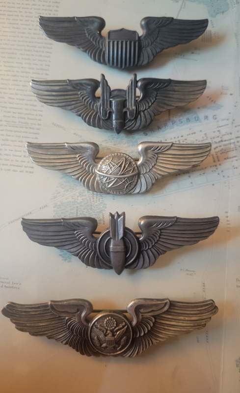

Here are the LeVelle wings I have found.  All are 3" wings with the exception of the aircrew which is 3 1/4".
5thwingmarty
LeVelle also had 3" Aircrew wings in the same pattern as the other wings, and also had 3" Aerial Gunner wings in the targetless pattern that were not hallmarked.  They also had 2" wings in at least some of the ratings including Pilot and Aerial Gunner.  Some of these 2" wings in this pattern are marked Goodwear Fabrics.
I find it fascinating the air crew pattern I posted was the only rating in that pattern.
