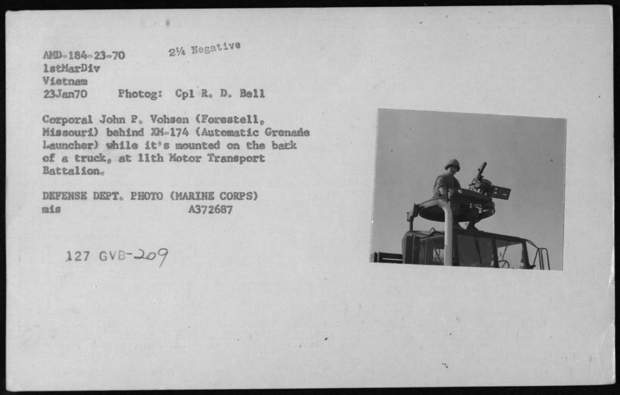

ordnance Posted July 16, 2024 #5 Posted July 16, 2024 Unfortunately, I can't help with that. The ACTIV report on the XM174 was dated November, 1968. For field testing, only 10 weapons were issued to units of the 4th and 25th Infantry Divisions and 5th Special Forces Group between May and September, 1968. None were tested by Marine Corps or Air Force units at that time unless it was under a separate program. The Army test troops generally liked it for base or vehicular use but not for use in the field, mainly because of the weight and awkwardness of sling carry. With a loaded 12-rd magazine the XM174 was 24 pounds and 45 pounds if the tripod was added. As you can see in the document attached, it was recommended for adoption. I don't know how many Aerojet ultimately made for the Government but several hundred at least. The photos I have of USMC or USAF use in Vietnam all seem to be from 1969 to 1971 or later so I assume distribution came after or at the same time as Army issue. They could have been guns shared by the Army or perhaps contracted directly by the other services but I have no evidence either way. I'll add a few photos including my all time favorite U.S. Military tech manual image from the pocket TM. Yes, that photo of the woman holding the XM174 is actually in the manual.
jd1 Posted July 16, 2024 Author #6 Posted July 16, 2024 Thanks! Great information. There are a few references in the Texas Tech Vietnam archives from the USMC. A few patrol AARs list it as being used on patrols, but nothing specific as to its effectiveness other than one I saw where it was fired against enemy troops. Another document is from a Marine service Bn being responsible for maintenance for it. Interesting system.
