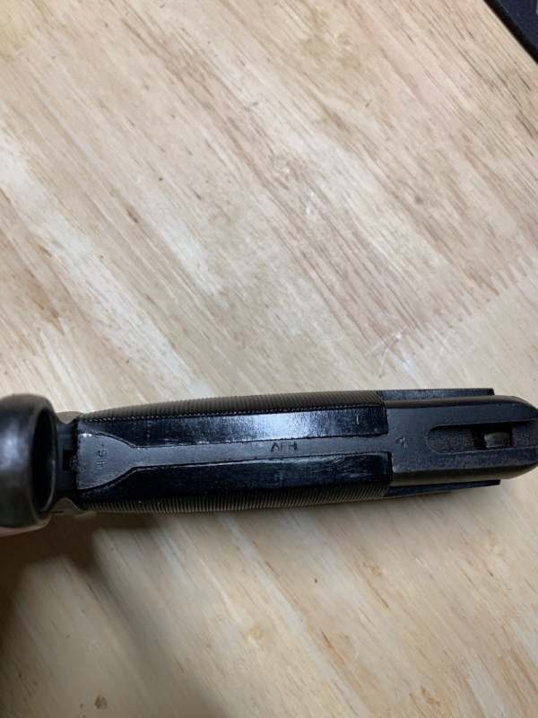

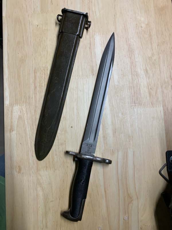

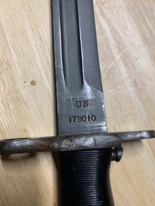

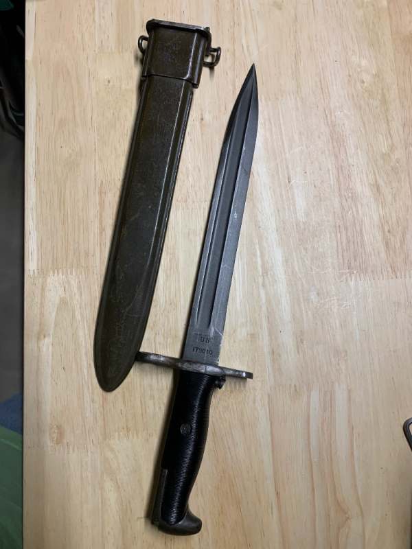

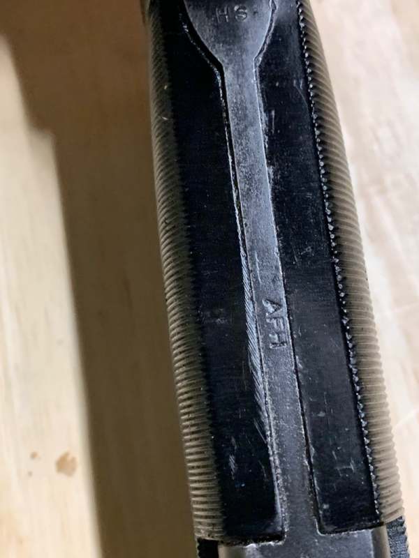

I am going to try and attach some photos for your review.  Please know that any and all input you can provide will be read with great interest and would be greatly appreciated.

Bad Primer- You have an original Rock Island M1905 that was cut down during WW2 by the American Fork & Hoe Co. (AFH). The bayonet was made in 1910, serial number is in the correct range for that year. The small "A" near the slot met it has the modified catch which was done in the 1910 time frame, early catches would break off. The "HS", I believe is for hardened steel, but can't recall for sure.  The bayonet was refinished, and appears to have never been issued.  After the cut down modification they were designated M1 Bayonets, some call the M1905E1.  SKIP
Welcome to the forum. Yes, this bayonet was probably used on an M1 Garand.
Now for some specifics. What you have is a 1910 dated Rock Island Arsenal 16-inch M1905 bayonet and in my opinion that was re-arsenaled with an upgrade of replacing the original wood handles to plastic handles sometime between 1938 and 1945. Also, in 1943 - 1945 the original 16-inch bayonet was cut down to 10-inches for use during WW2. This cutdown was performed by AFH (American Fork and Hoe) which was one of five companies contracted to cut down 16-inch bayonets. The plastic handles could have been replaced by AFH when they performed the cutdown to a 10-inch blade. The 10-inch bayonet was then used until 1953 as the standard M1 Garand Bayonet.
Here's an interesting timeline of the possible use of this bayonet.
1910 - 1937 (used as a 16-inch M1905 bayonet before, during, and after WW1 for the Springfield Model 1903 rifle.
1938 - 1943 (rearsenaled and used as a 16-inch Model 1905 bayonet for the Springfield Model 1903 rifle, M1 Garand, and the WW2 model 03A3 rifles.)
1943 - 1945 (Bayonet was cut down by AFH and used as a 10-inch bayonet for the Springfield Model 1903 rifle, M1 Garand, and the WW2 model 03A3 rifles)
1945 - 1953 (Bayonet used by the active-duty services on Springfield Model 1903 rifle, M1 Garand, and the WW2 model 03A3 rifles. This is the bayonet used on the M1 Garand during the Korean War) Specifically the M1 Garand was the primary infantryman rifle during this time.
1954 - present (Used by National Guard units, honor guards, ceremony guards. Still in use at some military funerals by the VFW and American Legion Posts)
So, in essence your bayonet served during WW1, WW2, and Korea.

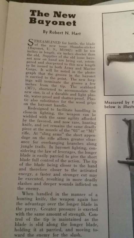

Here is an article in a WWII leatherneck magazine I had talking about the new M1 bayonets.

Agate Hunter - That article was really great to read.  Very cool to see an article from the era that explains why the bayonet I have is the length it now is.  Thanks very much!
