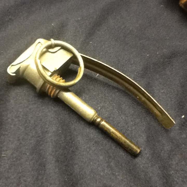

ww2collector1944 Posted September 23 Share #1 Posted September 23 Hey everyone, I purchased this from the vets grandson and wanted to reach out about its safety. I know this is a practice grenade and has had all of its internal contents removed. I have also noticed that the internal fuse has been clipped with wire cutters as well. My concern is the pin is still in the grenade and I am unable to unscrew the fuse from the grenade itself. It won’t budge. I wanted to double check that everything looked safe here. Link to comment
917601 Posted September 23 Share #2 Posted September 23 It is safe. The M10 series fuze ignitor is long, it extends almost down to the where the hole is. Your pictured example shows it has been discharged.Do a search here for an actual picture of a live M10 series fuze. Link to comment
917601 Posted September 23 Share #3 Posted September 23 Here is one. I posted it years ago. Link to comment

917601 Posted September 23 Share #7 Posted September 23 For info: Your fuze appears to have been “ deactivated “ the old GI way. I can see remnants of the lower fuze train. As an M10 series grenade was loaded with flash powder, a GI would unscrew the fuze assembly, pour out the powder, then screw it back in a few turns. They would pull the pin and toss it, the fuze would ignite, the lower fuze portion would fragment inside the grenade body, pressure would vent out the loosened threading. That is why we find some grenades “ blackened” around the upper most neck, usually covering the yellow band at the neck top, and they rattled when you shake them. That said, do NOT attempt that with a late war TNT filled grenade. Those fuze assemblies ( M6 series) were detonators, detonation was required to set off the TNT filling. M10 fuzes are ignitors, M6 fuzes are detonators. Link to comment
