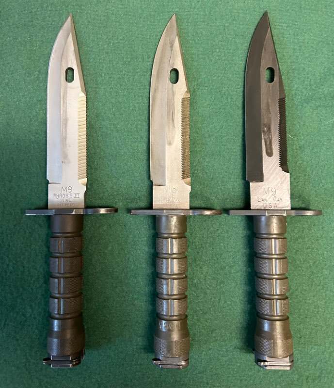

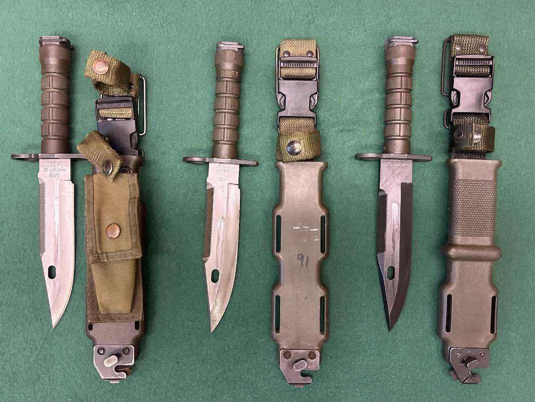

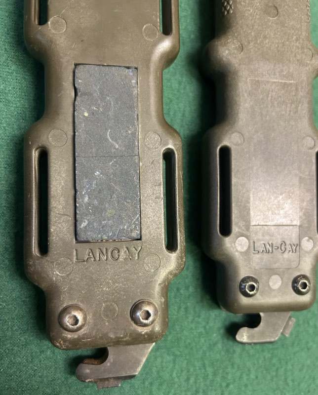

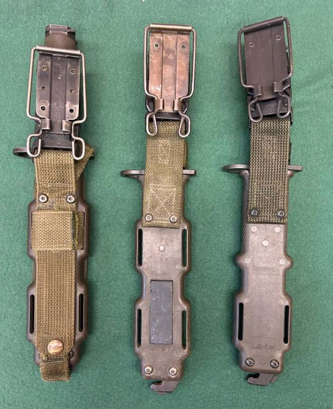

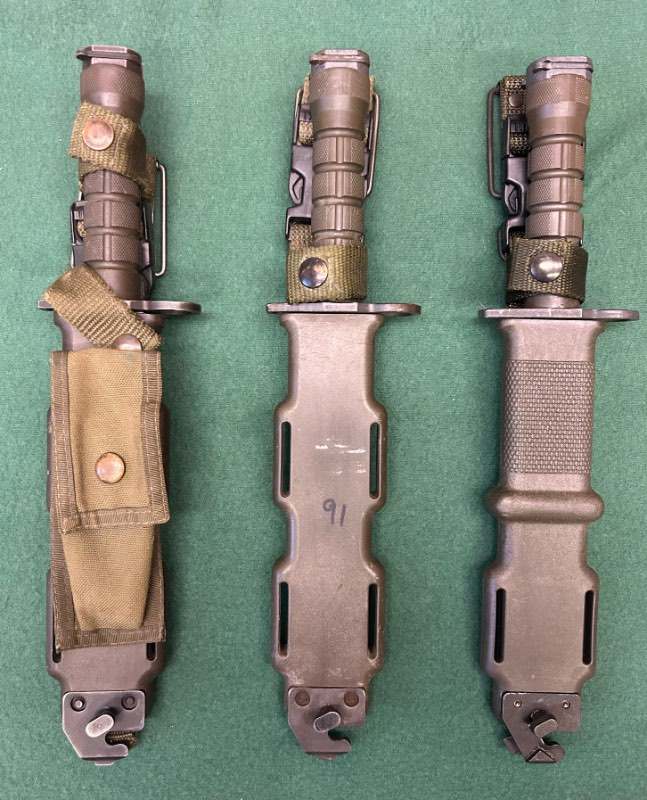

Random Posted September 25, 2023 #3 Posted September 25, 2023 Here’s my 3 examples of US Army issued, from oldest style sheath to the newer style.
Random Posted September 25, 2023 #4 Posted September 25, 2023 Left is right is early to late M9s: from late 1980s Phrobis III, to the middle one marked “LANCAY” from the 1992-93 era, to the late 1990s “LAN-CAY” (with hyphen) with subtle changes along the way. The marking on the scabbards also changed between 1992-93 and the late 1990s. Hope that info helps
