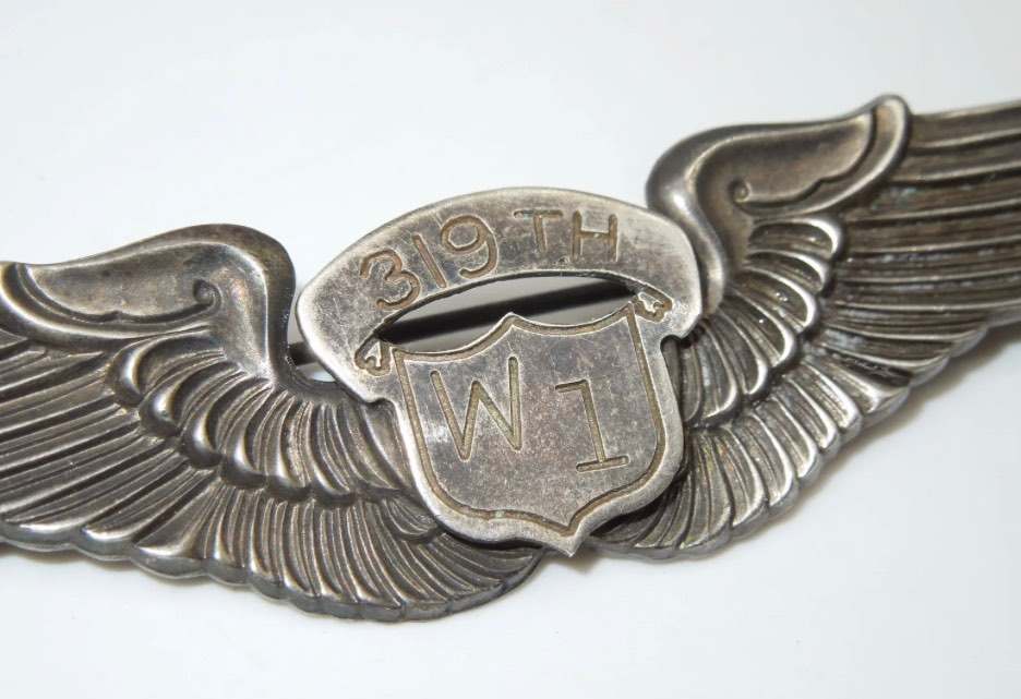

Noelle Posted July 14, 2023 #1 Posted July 14, 2023 The feathers look very odd, the scroll looks sloppy, the 1 looks too wide…. I can identify the standard lozenge wings from 10 paces, and could identify a W-6 at this point thanks to having one, but the other classes I’m not so sure of yet. So I defer to you fine folks since my coffers runneth dry for my exhibit right now and I can’t afford needless risks for a while.
bschwartz Posted July 14, 2023 #2 Posted July 14, 2023 Well the base wing looks to be a repro of a Meyer pelican beak pattern so that's a bad sign to begin with. The scroll on the shield looks wrong as well. I don't believe any of the class wings used this Meyer pattern wing as its base.
Noelle Posted July 14, 2023 Author #3 Posted July 14, 2023 4 hours ago, bschwartz said: Well the base wing looks to be a repro of a Meyer pelican beak pattern so that's a bad sign to begin with. The scroll on the shield looks wrong as well. I don't believe any of the class wings used this Meyer pattern wing as its base. So possibly not even a genuine base. Ouch. I thought that perhaps another genuine wing, though the wrong one, was used, but if even the base is possibly fake, then that’s just salt on an open wound. Is there any good and quick resource to find out the different wing patterns? I don’t know how to describe then when one looks wrong to begin with, like this one. That is the sloppiest scroll I’ve seen. Aside from the ends, the engraving (which obviously shouldn’t be engraving) is shaky. I’ve been surprised at how often WASP wings auctioned even by reputable places end up being fakes. Some I’m able to be 100% sure of beyond all doubt—always the lozenge—though with the shields, I still doubt my own judgement and would prefer to ask. At this point, I’ve seen more fakes being auctioned than real ones, which just makes me feel beyond fortunate to own the ones that I do. I’m going to see what I can find about this Meyer pelican beak pattern. Thanks, Bob.
5thwingmarty Posted July 15, 2023 #4 Posted July 15, 2023 The book "More Silver Wings, Pinks & Greens" has photos of real WASP class wings and identifies the known base wing makers for the wings shown. Although the first two classes look like they used Gemsco pattern base wings with cut down shields, the base wings used were actually made shieldless as also used to make cadet cap badges and and other two-piece wings with the attached center devices. Marty

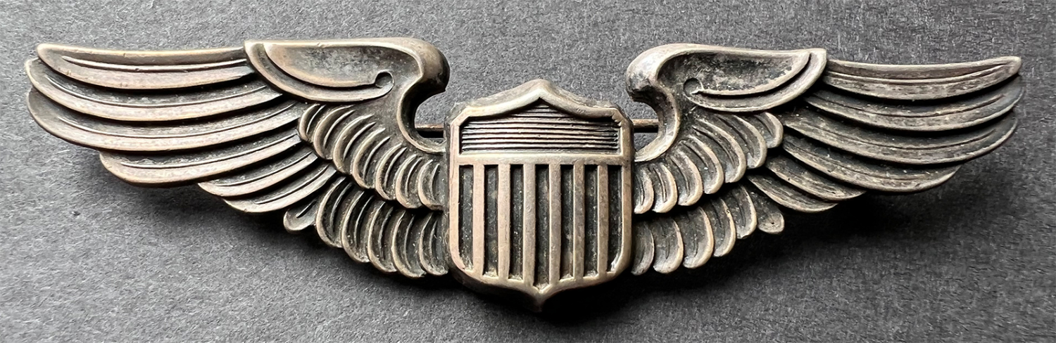

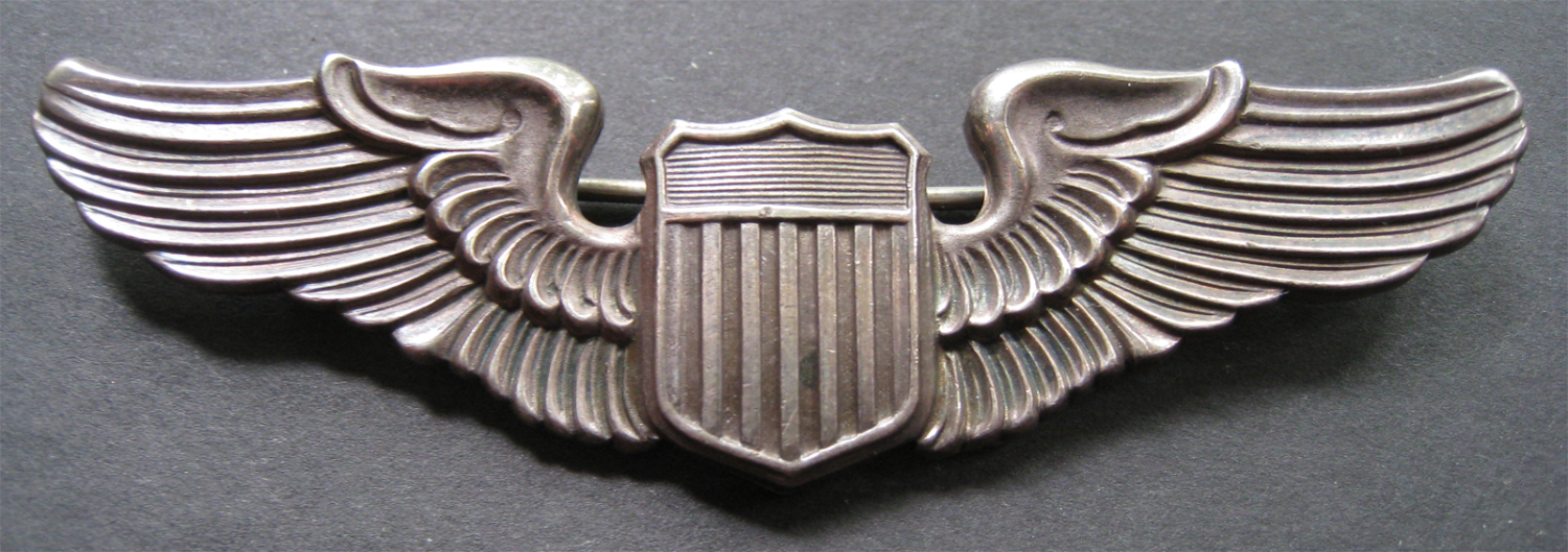

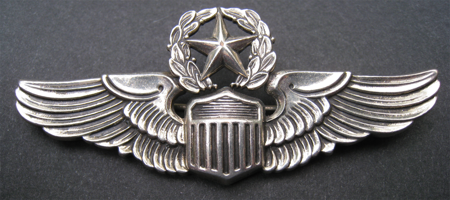

bschwartz Posted July 16, 2023 #7 Posted July 16, 2023 And a quick note on the pelican beak wings, the LGB wing has the standard pelican beak shape that was used by other manufacturers like Amico and even Meyer. However, Meyer has two pelican beak wings. One with that extra little peak in the middle and the more standard no peak design. The only other manufacturer to have that little peak is Gemsco with their very late to post WW2 wings (my feeling on timeframe, still need documentation). The Gemsco wings are much larger than the similar pattern peaked Meyer wings. If you look at my AAF pilot wing page you will find many other pelican beak pattern wings. http://www.ww2wings.com/wings/usaaf/usaafpilot.shtml LGB pelican beak - http://www.ww2wings.com/wings/usaaf/pilot/balfouraafpilot.shtml Meyer with the extra peak - http://www.ww2wings.com/wings/usaaf/pilot/meyeraafpilot.shtml Meyer without the peak - http://www.ww2wings.com/wings/usaaf/commandpilot/meyeraafcommandpilotsmshld.shtml Gemsco with the extra peak - http://www.ww2wings.com/wings/usaaf/aircrew/gemscopatternaafcrew.shtml Amico - http://www.ww2wings.com/wings/usaaf/pilot/amicoaafpilot.shtml

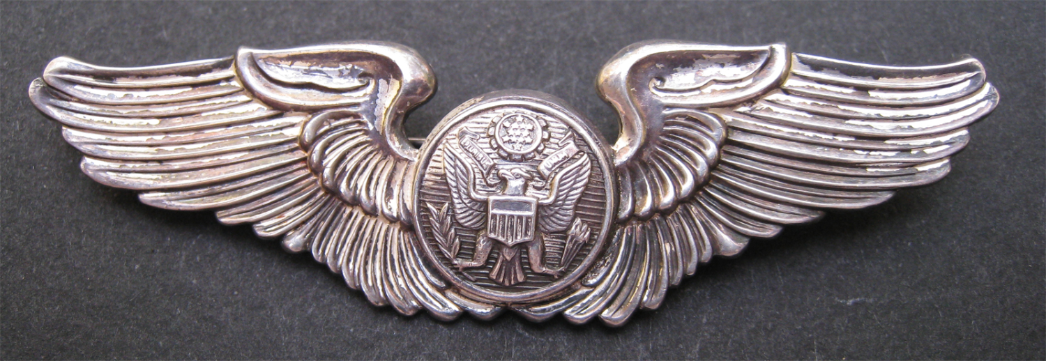

jeff41st Posted July 16, 2023 #8 Posted July 16, 2023 "Extra peak" is also on the LeVelle & Co. air crew wings http://www.ww2wings.com/wings/usaaf/aircrew/jfaircrew.shtml
bschwartz Posted July 16, 2023 #9 Posted July 16, 2023 1 hour ago, jeff41st said: "Extra peak" is also on the LeVelle & Co. air crew wings http://www.ww2wings.com/wings/usaaf/aircrew/jfaircrew.shtml Excellent catch Jeff. Totally spaced that one even though you sent it to me for my site. My bad. It's getting hard to remember everything that's up there!
Noelle Posted August 21, 2023 Author #10 Posted August 21, 2023 The listing was updated to reflect post-WWII repro, and closed at $350: https://www.liveauctioneers.com/item/154915609_wwii-type-postwar-319th-w1-womens-army-pilot-wasp-sterling-wing
