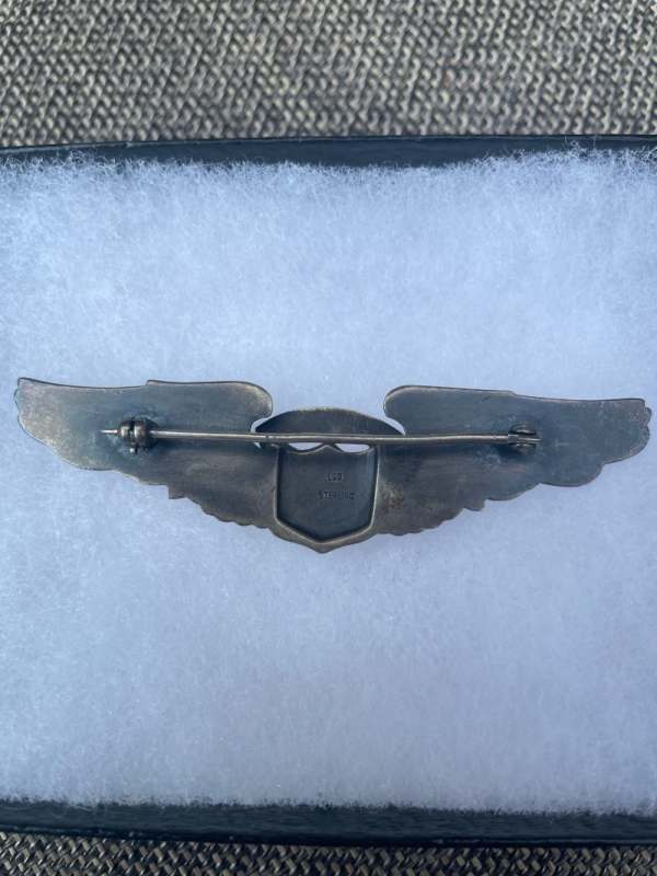

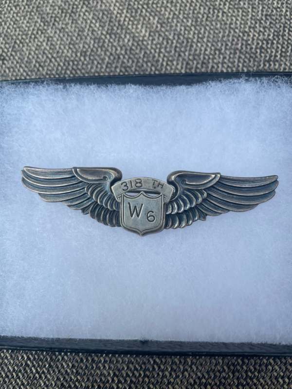

Austin R Posted June 18 Share #1 Posted June 18 I’ve had these wings for some time now. I previously compared them to a few other examples and thought they were authentic. I recently decided to part with them. However, I was informed that they were not authentic. Before casting them into the regret pile. I wanted to get confirmation they were inauthentic. Any information or guidance to references would be appreciated. thank you, Austin Link to comment Share on other sites More sharing options...

5thwingmarty Posted June 19 Share #3 Posted June 19 It is my understanding that the 43-W6 wings were like those of the prior two classes where the base wing used was the Bell Observer wing. The 6 also looks undersized, and there is a bevel to the edge of the shield that looks larger than real examples. I would say no good as well. Link to comment Share on other sites More sharing options...
rathbonemuseum.com Posted June 19 Share #4 Posted June 19 This is what an authentic W-6 class wing should look like, per the comments Marty made above. Wing is from an attributed WASP W-6 graduate and was sold as part of her estate. Link to comment Share on other sites More sharing options...

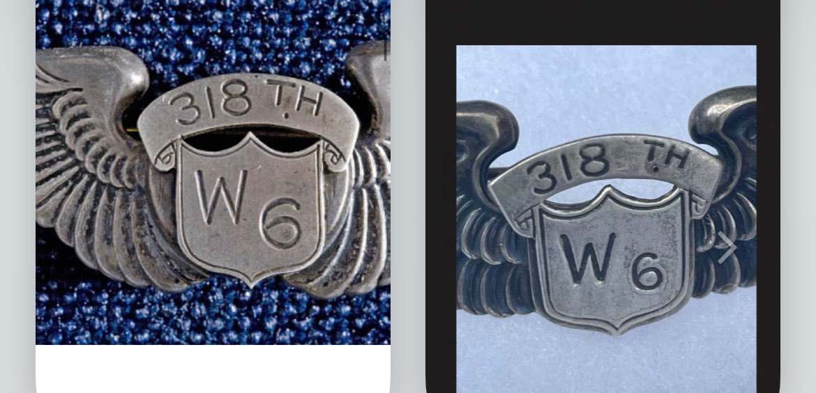

Austin R Posted June 19 Author Share #5 Posted June 19 Thank you both for your insight. I found another W-6 wing that was donated to the Smithsonian by a WASP. There are definitely key differences in the thickness of the engraving, scroll, and letters. Looks like it’s going into the regret pile. Thanks all! Link to comment Share on other sites More sharing options...
rathbonemuseum.com Posted June 19 Share #6 Posted June 19 Also note it is mounted on a different manufacturers base wing that is a cut down observer wing, not a cut down pilot wing. Link to comment Share on other sites More sharing options...

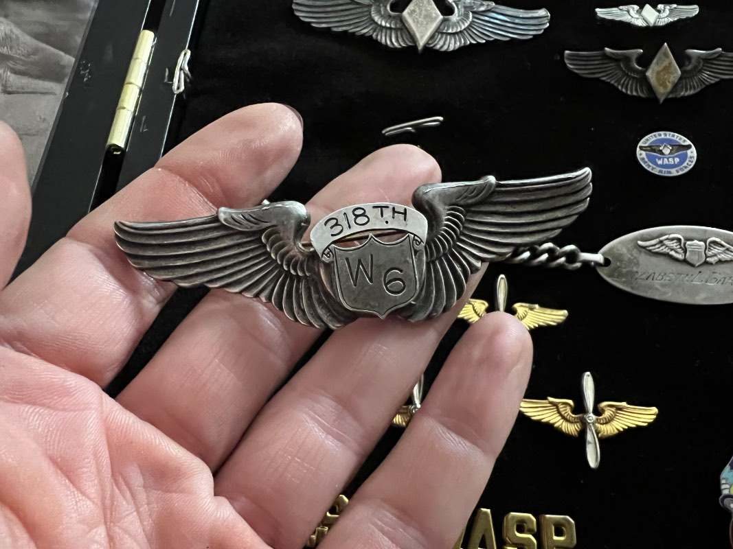

Noelle Posted June 20 Share #7 Posted June 20 On 6/18/2023 at 3:49 PM, Austin R said: I’ve had these wings for some time now. I previously compared them to a few other examples and thought they were authentic. I recently decided to part with them. However, I was informed that they were not authentic. Before casting them into the regret pile. I wanted to get confirmation they were inauthentic. Any information or guidance to references would be appreciated. thank you, Austin I have all of Elizabeth “Libby” Gardner’s pins, including her W6. The whole thing is verifiable as legit. The 6 is too small. The TH is too small. The 318 are off. The wing base is entirely wrong. What you could so is, if possible have “copy” engraved on then, or etch it deeply yourself, and sell then as a replica since there are people who look for stand-ins in their collections to take the place of what they don’t have, and there are reenactors who like to use wings other than the standard lozenge wings. (I used this real set, which got a lot of attention.). I’d rather have someone looking for a replica to buy from you than to find Joe. I do want to than you for wanting to make sure you aren’t inadvertently putting a replica out there as authentic. There are a lot of sellers who don’t care, even when they’re told. A stupid seller on Mercari keeps trying to get me to buy some wings that are so fake that a dead man whose eyes were eaten out by birds could tell. So it’s nice seeing someone br proactive. Link to comment Share on other sites More sharing options...
