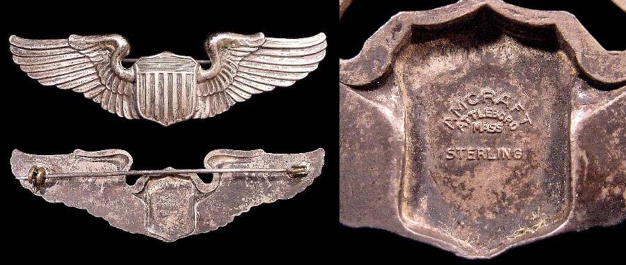

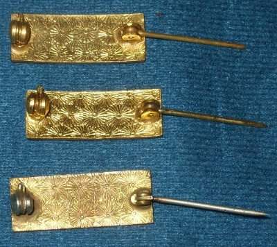

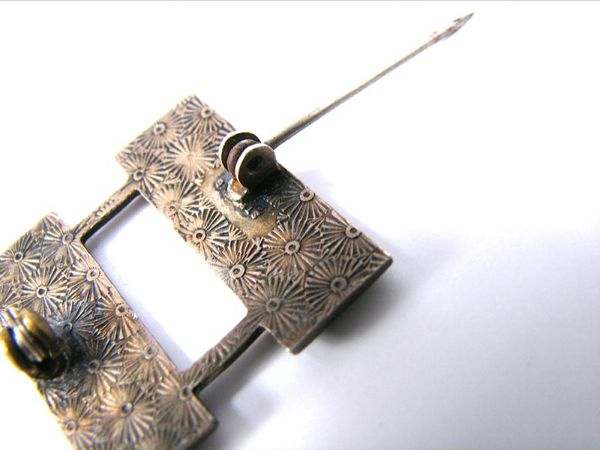

Amcraft of Attleboro, Mass was apparently providing military insignia of all forms prior to WW2. The Starburst or "snow-flake" pattern is shown here. Typically seen in pre-war insignia, in particular Amcraft used this pattern in its prewar wings and insignia. Attleboro's jewelry industry began in 1780; silverware, scientific instruments, and fabricated metal products were also made. Have found nothing much regards the Company's history -hopefully someone can fill-in the gaps. s/f Darrell
from the collection of Andrew
unmarked version from the collection of Keith

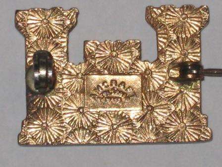

A new addition, from the collection of Andrew AKA "reinking71" Note, this hallmark shares the "acid test" mark.

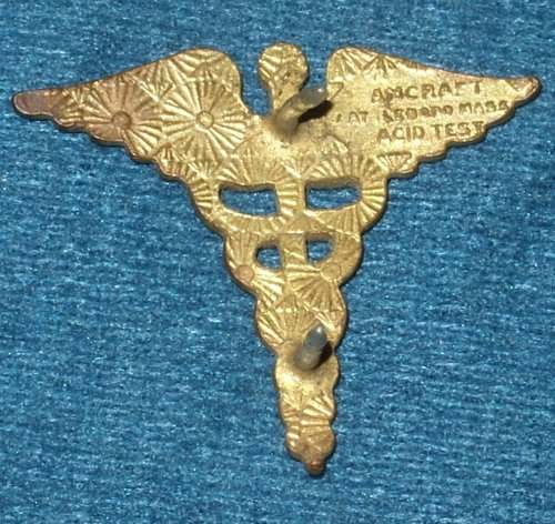

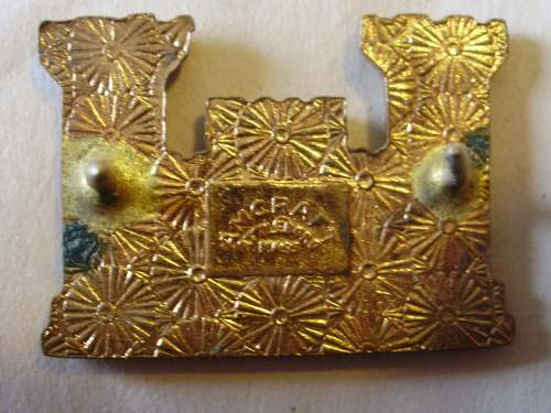

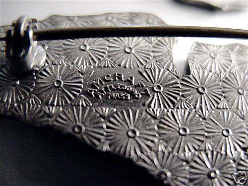

Here is the Amcraft hallmark on the back of a medic insignia

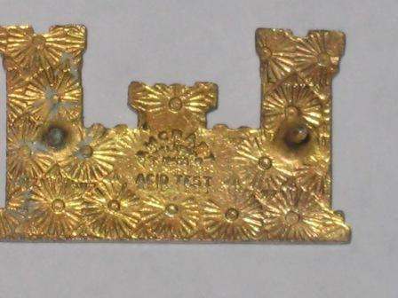

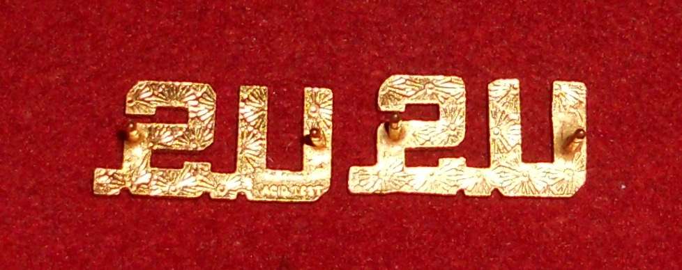

and three more snowflake patterns on the back of what I assume are unmarked amcraft pieces

AMCRAFT SNOWFLAKE PATTERN WING - from collection of member "joshypogi"

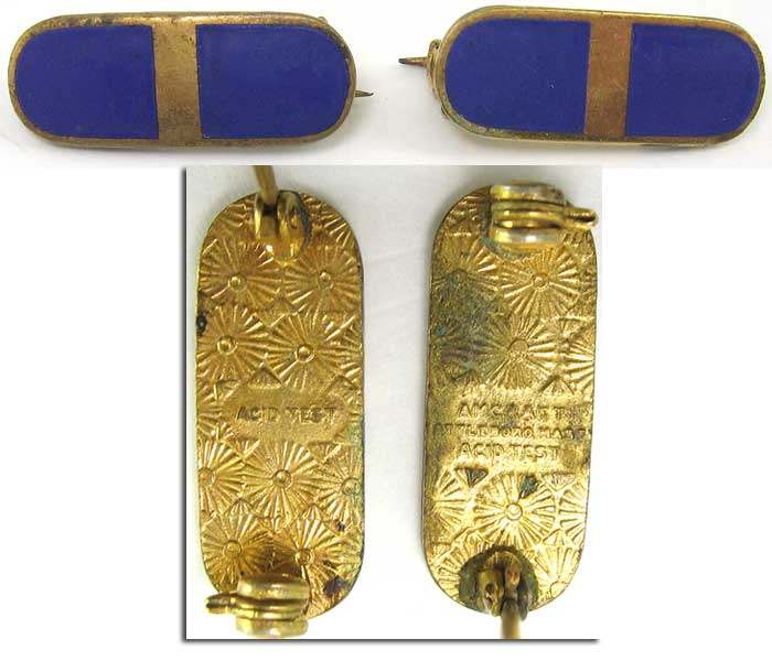

US Officers Collar Devices with the "Acid test" mark along with the star burst pattern

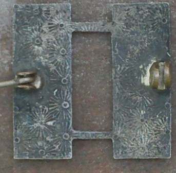

Here are my contributions.
Captain bars. Marked sterling but how the pin is put it its covering it up.

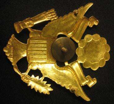

I believe this unmarked cap device is Amcraft based on the excellent quality of the plating, detail and being marked "ACIDTEST", even though it does not have the snowflake pattern. Gemsco of the same period is very similar, but with some differences that cause me to believe it is not a Gemsco. The Gemsco post end is concave, whereas this is convex, and the great seal motto lettering is taller on this than Gemsco pieces, which also used the "ACIDTEST" marking.

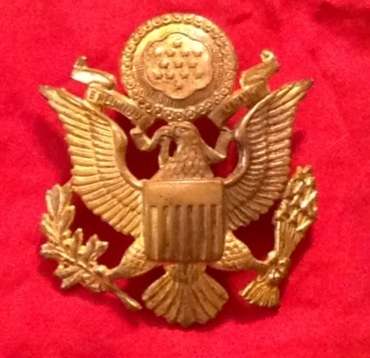

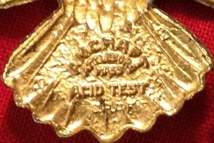

AMCRAFT US Army officer's hat eagle. There are no snow flakes but it does have a good solid AMCRAFT logo on the eagle's tail.

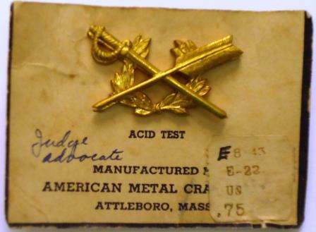

Beautiful Amcraft Judge Advocate General wit the snowflake back, marked AMCRAFT and Acid Test
