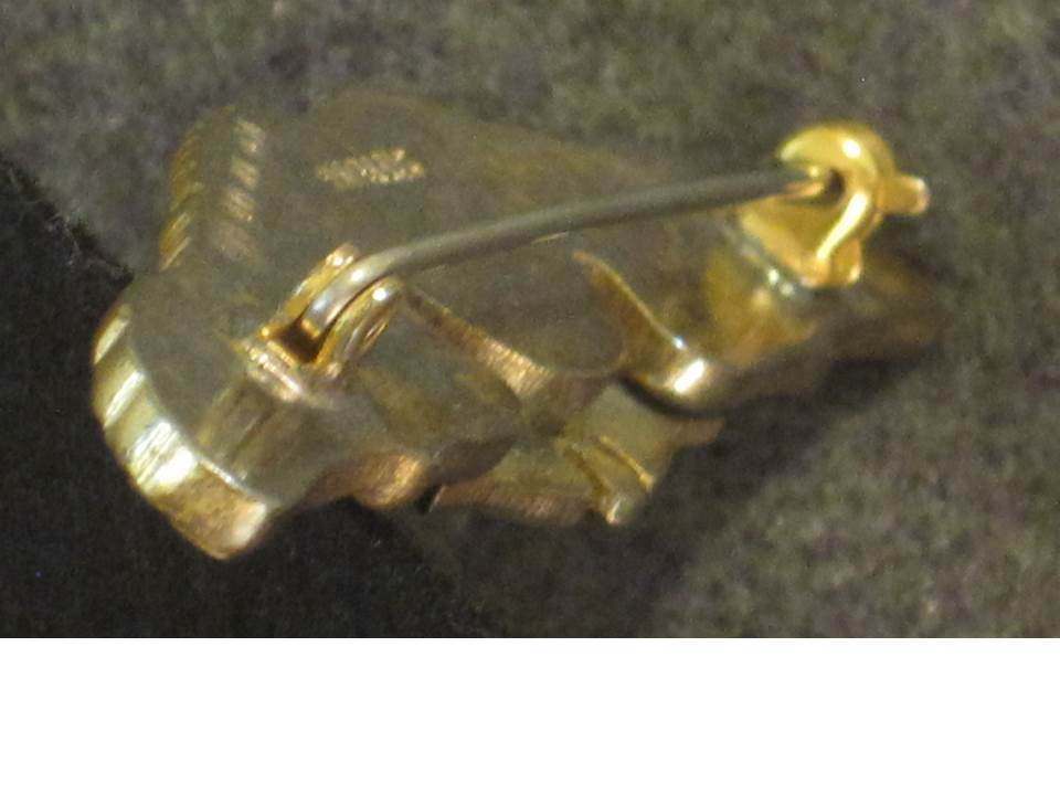

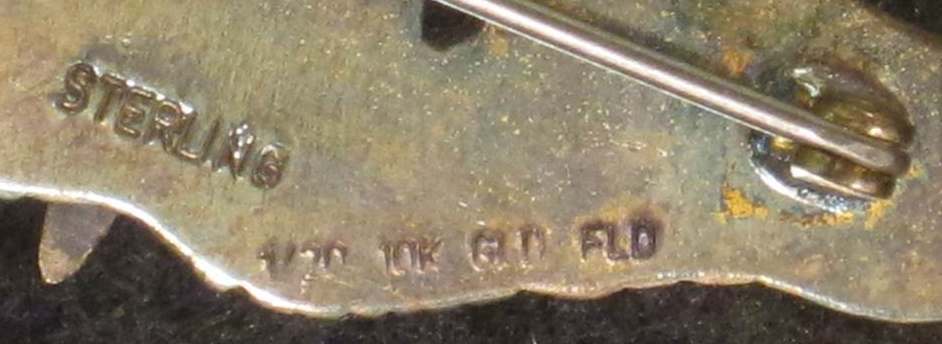

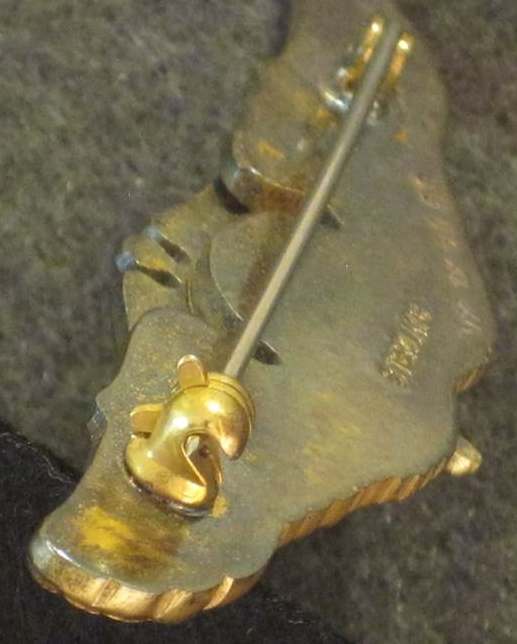

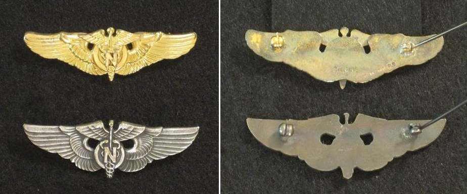

Scott C. Posted May 5, 2023 #1 Posted May 5, 2023 Would like opinions on my two Flight Nurse wings. The gold is three-pieces (wing/caduceus/'N'), with reverse stamped STERLING at the lower center, and 1/20 10K GLD FLD along the bottom right wing. The silver wing is all one piece, with the reverse stamped STERLING in the center. Thoughts?
rathbonemuseum.com Posted May 5, 2023 #2 Posted May 5, 2023 Hi Scott. I don't recognize either pattern and do not match any at http://ww2wings.com/wings/usaaf/usaafflightnurse.shtml. That isn't to say they are wrong, just not ones I am familiar with. The gold one I would want to see better detail and especially of how the hinge is attached to the base on the wing. The photo is a little tough to tell but I am leaning towards that being a modern NS Meyer restrike with the incorrect hinge mount (a two footed base) and the uncammed pin. Hopefully someone has more information to offer on these.
Steve D. Posted May 5, 2023 #3 Posted May 5, 2023 Hi Scott, I have a fairly advanced collection of Flight Nurse uniforms including 7 different versions of original wings. Unfortunately, I don't believe that your wings are original WWII issue.

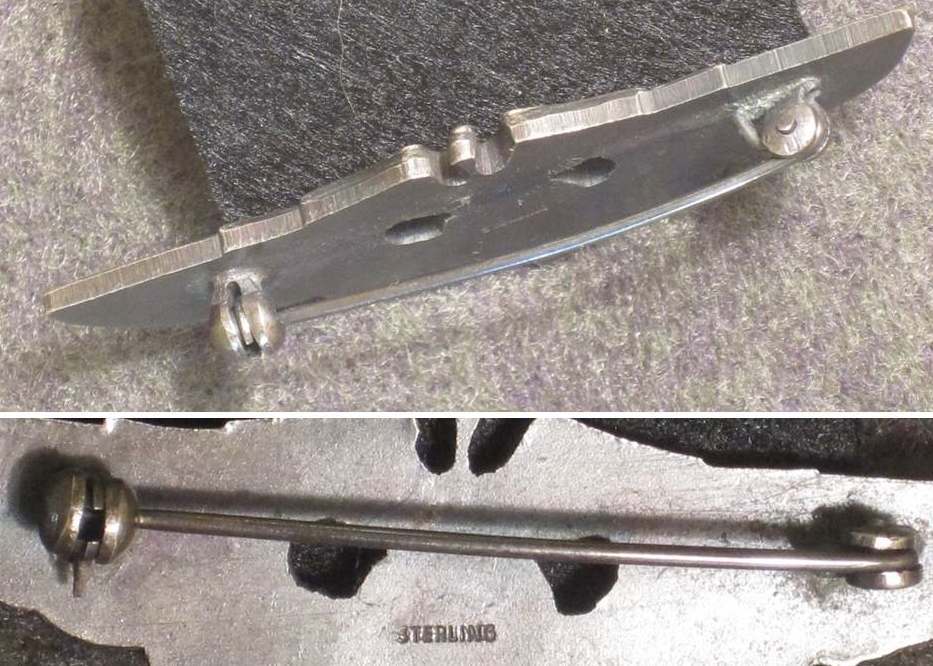

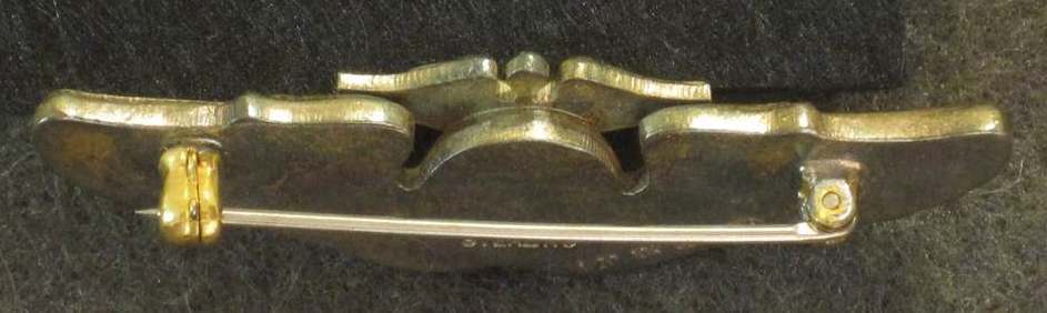

Scott C. Posted May 7, 2023 Author #5 Posted May 7, 2023 More detailed pics of both, just in case . . .
5thwingmarty Posted May 8, 2023 #6 Posted May 8, 2023 The gold wing does look like a Meyer restrike to me as well. The silver wing is a bit of a puzzler. I don't recognize the pattern either, but it does look like a die-struck wing. If I saw the silver wing for a reasonable price I would pick it up unless someone else identifies it as a known fake.
