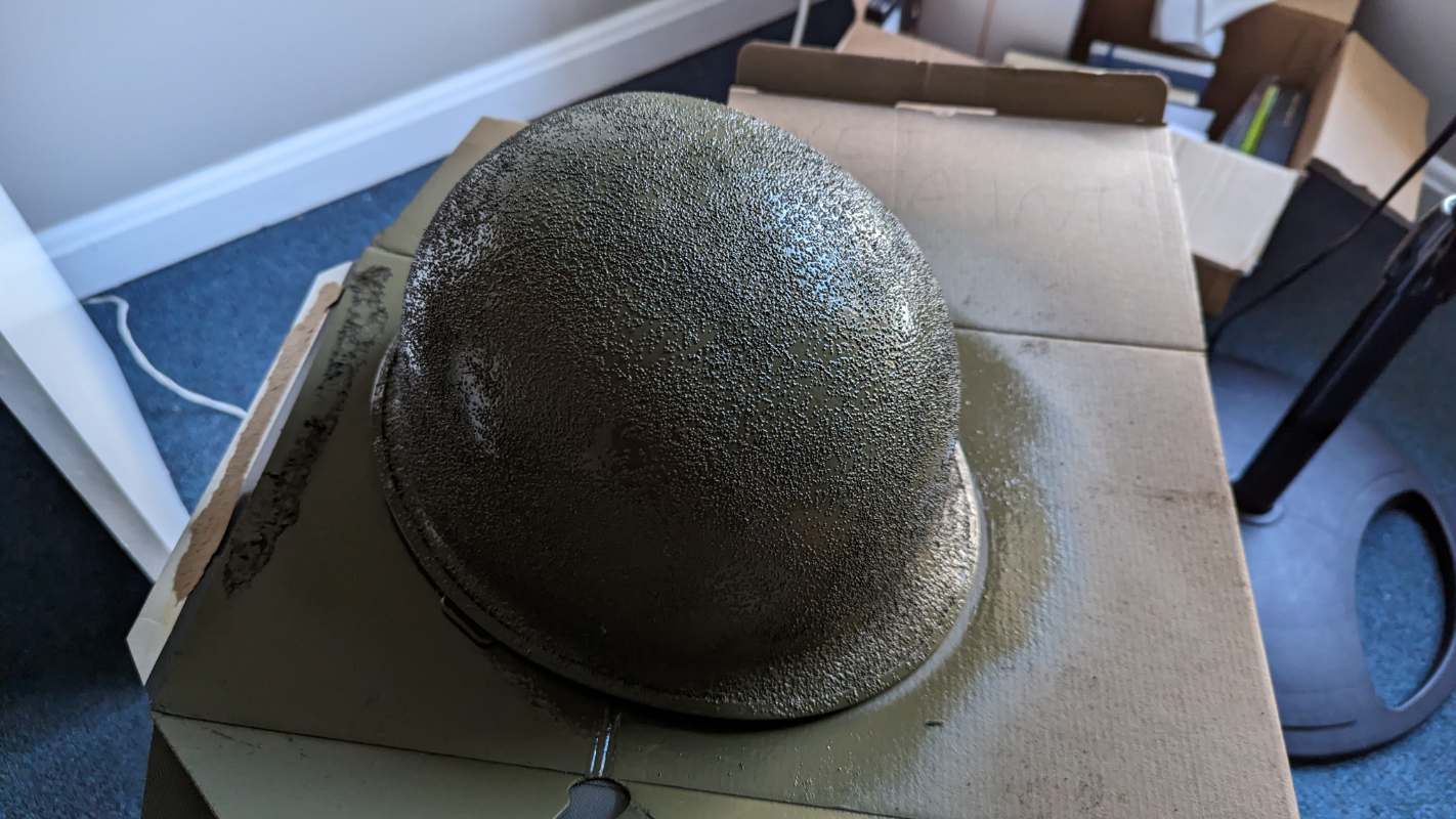

Got some sand for free from a coworker so I decided to go ahead and texture the helmets. It's a gorgeous day for it so, carpe diem!
I tested my technique on my liner first, which will also be stripped and repainted so I didn't mind it. It has some texture already but this was just practice and it will be repainted anyway, with no texture.
The technique? I grabbed a small handful of a and, sprayed a wet coat of primer and blew the sand onto the wet primer. Honestly it worked way better than I expected it to. Pretty much all of the sand stuck to the primer which meant more went on than I wanted.
My initial reaction to this was to try again, with less sand in my hand and further away. But that was before I realized that I could just brush off extra once it was dry. However the second version of the technique seemed like a good idea to stick with anyway.
I went pretty liberal with the sand, especially on the Brodie helmet. I assumed that in WW1 they were not concerned with how much sand was on there, as long as it was. Photos seem to corroborate this anyway.
Yes, the dried sand on the side of the M1 does look like what you are thinking it looks like. It was all primered over anyway.
As for the M1, I did not want to use too much as I have an unissued (or reconditioned right before the M1 was phased out) post-Vietnam shell and liner, with a TON of sand on it, and I did not want my helmet to look like this one. Not only do I not really care for this look, but also I don't need two that look like this.
After the sand was blown on, I went inside and took a shower since I did this immediately when I got home. Once I was done with that I adjusted the sand levels on both helmets, trying to mitigate "hotspots" where there were small areas with lots of sand on them, and other areas which didn't have enough, using a wire brush and more primer/sand, respectively.
Once that process was done, I sprayed over all of it with one last light coat of primer and they are drying outside as I am writing this post.
Fingers crossed that the surplus store I am going to tomorrow will have the paint I need. They probably won't, but that would be pretty cool if I don't have to spend $13 on shipping.
That's all for today. Might post finished pics once the primer is dry later tonight.

I also decided to try spraying more green onto the helmet and blowing sand on, and adjusting on the fly. It worked but I think it needs another top coat as it comes on much easier than the primed sand. Either way, i have two cans of OD 319 so if I need to redo it I will.
I will say the sand is much more consistent now. I was worried about putting too much sand on that I didn't put enough on. This is more than I thought I would like but I think it actually looks pretty good in practice. I think I was hoping for more of a cork finish than the sand finish, which makes no sense but I don't know what I was going for. This looks great though. I am excited to see it with the MP markings.

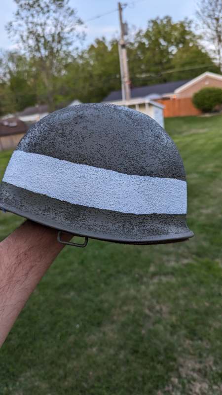

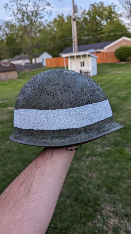

We got paint on the M1917 today, and I used up the last of the first can of OD 319 on the M1. Mrs. DimensionPizza helped out with the M1917.
If we were any good at this, we would have had to make a family business out of this. Thankfully this is amateur hour, and I don't have any pressure to make these look perfect.
The field drab is definitely lighter than I thought it would be. It's a very yellowy brown. I was expecting a darker brown, but also the only color pictures online are of 100 year old examples that have, well, aged 100 years. I assume this is correct and this is the shade I have seen these helmets are supposed to be painted in, so I guess it's fine.
We got the first coat sprayed on, then did some shopping. We came back home to put our things up, and sprayed another coat on, then went to lunch and shopped around some more. Came back, put paint on the inside of the M1917 and used the last of the first can of OD 319 to build up layers. They are currently drying in our spare bedroom.
The paint dries darker than it goes on, and the texture of the helmet also helps it look a bit darker. I am not unhappy with the color, but it wasn't what I was expecting.
The paint also went on very wet on the M1, and a bit pooled around the front of the brim. That's what we call operator error, so I don't have anyone else to blame but myself.
Might post pictures once they have dried after a while, maybe tomorrow morning. Thanks again for reading, and special thanks to my fiancée for her extensive help and support with this project.

As promised here are pictures of the dried helmet. The field drab continued to darken as it dried overnight.
Link to comment
DimensionPizza
Some photos would probably help, right? Thumb slipped and I can't delete that comment.
USPS says the liner should be delivered today for the M1917 but I will be waiting to install it for a nicer day. The missus wants to help with that too.I  am considering redoing it with the sawdust finish but I am unsure of what I want to do yet.
Also the field drab continued to darken as it dried over night and now looks more in line with what I was expecting. Maybe still a little lighter than I thought but the examples around today are all battle worn, dirty, and obviously aged as opposed to brand new.

Today I decided to take initiative and paint the white onto the M1.
Masking was quite a chore, I don't know exactly how long it took, I think about 45 minutes to an hour.
Using this as a guide, incidentally sourced from USMF (thanks guys), I masked off the general dimensions for the lettering first.
I then started on the bottom of the stripe.
Then, I started on the top of the stripe but I did not get any more pictures of the process since my fiancée wanted to video chat for a bit.
After I finished the masking for the stripe I began painting it in white with satin finish acrylic. Definitely not the best choice but I don't think the tape would have held long enough to get flat white oil paint from the craft store. You know, because bright white paint needs that extra bit of light dispersion. It isn't too much shinier than the OD paint and it looks fine.
I then masked off the vertical parts of the MP and painted them, then did the other parts by hand. No pictures of this process, I was in the zone.
They looked pretty rough and needed some touch ups. The stripes also needed just a little bit of help. Here is before...
...and after.
