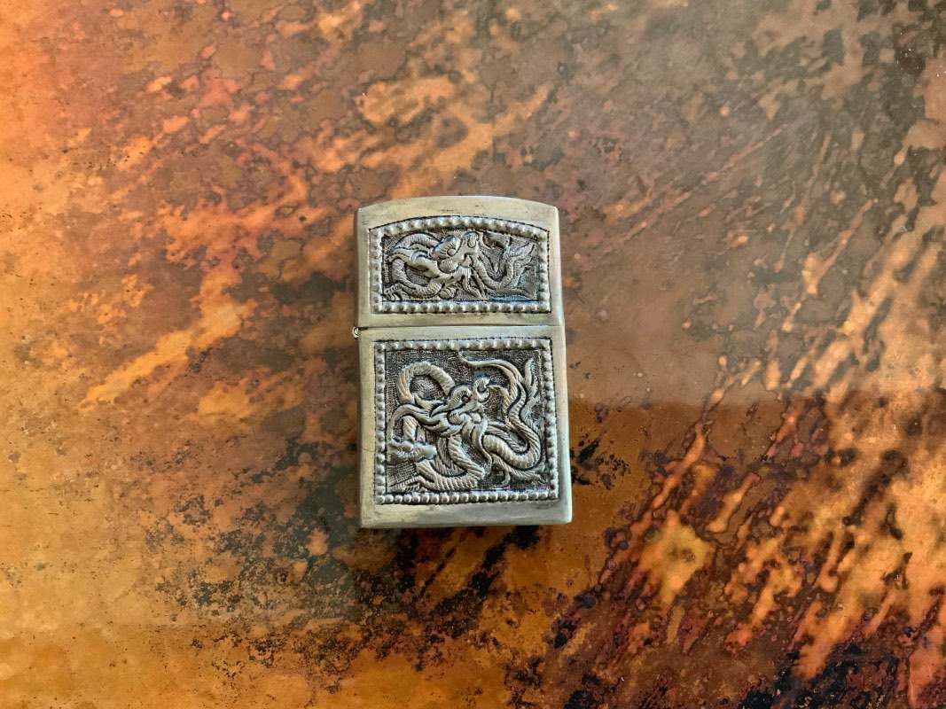

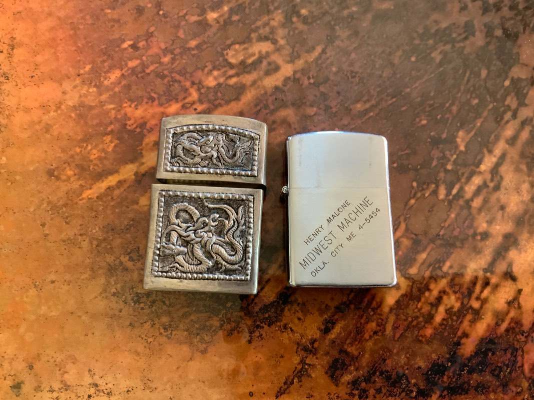

These Vietnamese-made Sterling silver lighter covers come up occasionally. I bought this particular one in a Vietnamese ville in 1969. It is essentially a thin silver two-piece shell that fits over a lighter:
The usual designs are dragons and/or floral designs. The two I have are both bottom-marked “Viet Nam” and “Ster”.

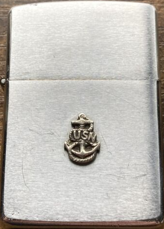

@Cobra 6 Actual Firstly thanks for the guide, it's helped me dodge a few close calls where I nearly ended up forking out for fakes! I'd appreciate your thoughts on this one:
https://www.ebay.co.uk/itm/304902775353
image.png.2013ae8d2498b1c57ce63dd6f1f92b71.pngimage.png.ca5e856b13ff51bdccf8ce4e3d586125.png
Now it's obviously not claiming to be Vietnam lighter. I believe it's a real zippo and legit stamp + the insert seems to match.
I'm wondering if you or others know anything more about the USN badge on it and what might be the origins of a lighter like this?

Hello, Tim. Thanks for the kind words. And, you’re correct: that is a legitimate Zippo with correct Zippo style date code and insert (red felt is a little rarer, but still accurate). Yokota57 has also checked in with me and he agrees about the authenticity of this Zippo.
The insignia is for a US Navy Chief Petty Officer (CPO) and is most probably something added on later. Still legitimate, but not soldered on by Zippo. These kinds of additions are pretty common. I’ve even done it myself by having jump wings soldered on to a Zippo. No worries. By the way, the price seems a bit high. Something like this would have been better priced at £30 to £40.

That's helpful, thank you, I've been off learning about CPOs now! When you say they're pretty common and that it's still legitimate, could you share any more information on what the origins of that might be? Is it usually something done by individuals or by third parties looking to sell them on? Or in bulk for servicemen to then purchase?
I take what you're saying to mean that it's not scrupulously done to try and make a quick buck on ebay but curious for any more details!

By “pretty common” I meant that many people add to or personalize their Zippos, Tim. If you look over one of the other threads on this Forum on lighters you’ll see plenty of examples. I referred to this one on this thread’s first page:
Yokota57 also has some excellent threads with many examples of different lighters and their engravings and attachments.
I’m just speculating, but my guess would be that your lighter could have had that CPO insignia added by someone proud to be promoted versus being added on to sell on eBay or another such site. Usually such additions, in the past, would have been soldered on. But, now with “super glues”, it is equally possible that this was the attachment method.

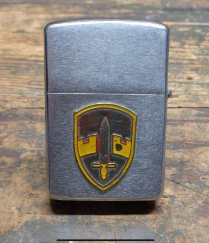

Here’s an authentic Zippo on eBay that illustrates what the “real deal” should look like:
MACV Advisory Team 95 was at Bien Hoa. I believe that “T.M. 95” is a simple typo. It should have been “TM 95”. (After I got out of the field I was in a MACV Team and we never used the abbreviation “T.M.” for “Team.” However, perhaps others that served in MACV can give me some insight: might have been a local practice). And, “G-5” is for “Civil Affairs”.

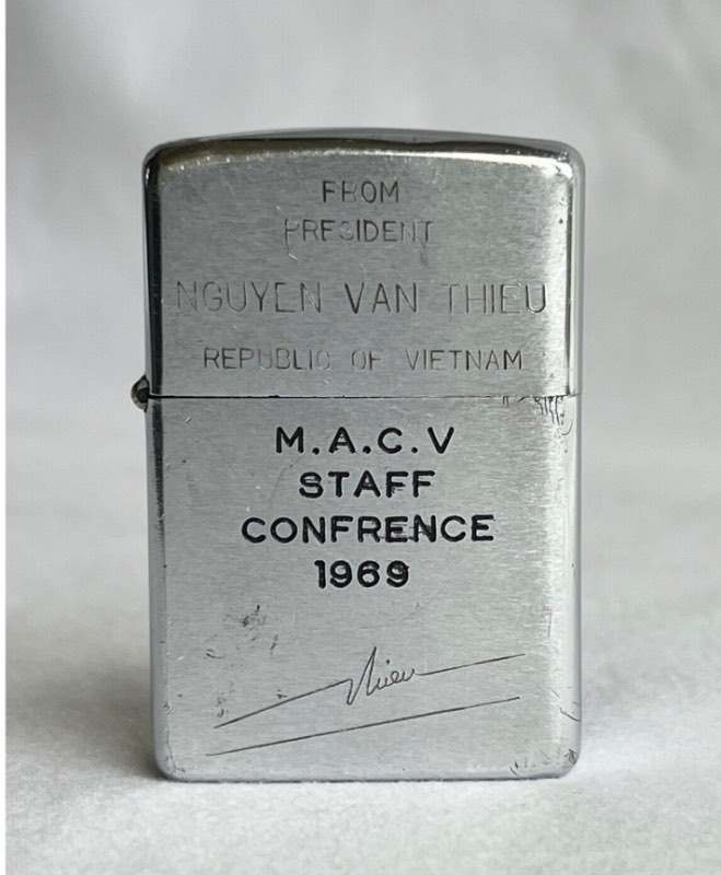

On eBay there’s now an interesting fake:
Let’s take it apart: 1) Inconsistent spacing between the lines on the top portion , 2) “M.A.C.V” missing the final period as is common with the European style of punctuation; such as the French taught in Vietnam, 3) Wobbly black paint-filled letters on the bottom portion, 4) The word “CONFRENCE” should be spelled “CONFERENCE”.
The Thieu signature at the bottom looks good. In fact, the top portion with “From President Nguyen Van Thieu, Republic of Vietnam” and the signature at the bottom appear to have been loosely copied from an authentic Zippo:

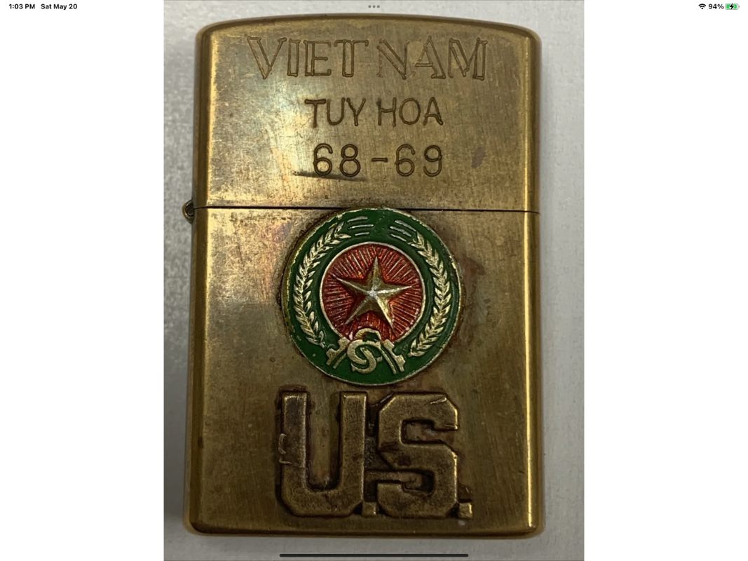

Wow, those are ugly, Yokota57. Thanks for posting them. Here’s another eBay fake:
The usual wobbly lettering and artificial aging with the chrome totally removed. However, this has an interesting nonsensical twist: above the letters “U.S.” is the seal for the North Vietnamese Cảnh Sát (Security Forces). Go figure.
Here’s the reverse:
A saying that makes no sense, apostrophes that look hand engraved, etc. Meanwhile, the Zippo logo on the bottom is engraved instead of the way it should be, stamped:

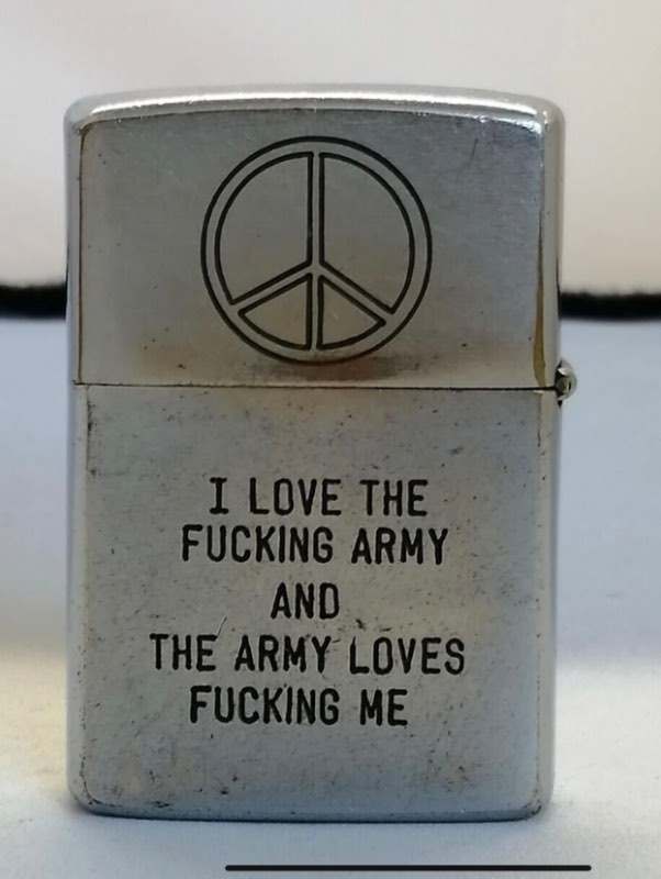

Here’s another fake on eBay:
Indicators: paint-filled and wobbly letters, sloppy spacing of letters and words, etc.
Here’s the reverse:
Indicators: incorrectly quoted song lyrics (it should be “It’s been a hard day’s night …). Also the missing “g” from the word “workin_”. The spacing between “workin” and “like” is wrong, too. And the word “a” is missing between “like” and “dog”.
Another indicator is that any time you see a supposed Vietnam-engraved Zippo on a “bed” of similar ones; that’s a bad sign. By the way, if you want this gem it is for sale for only $532.92 plus $35 shipping from Japan.

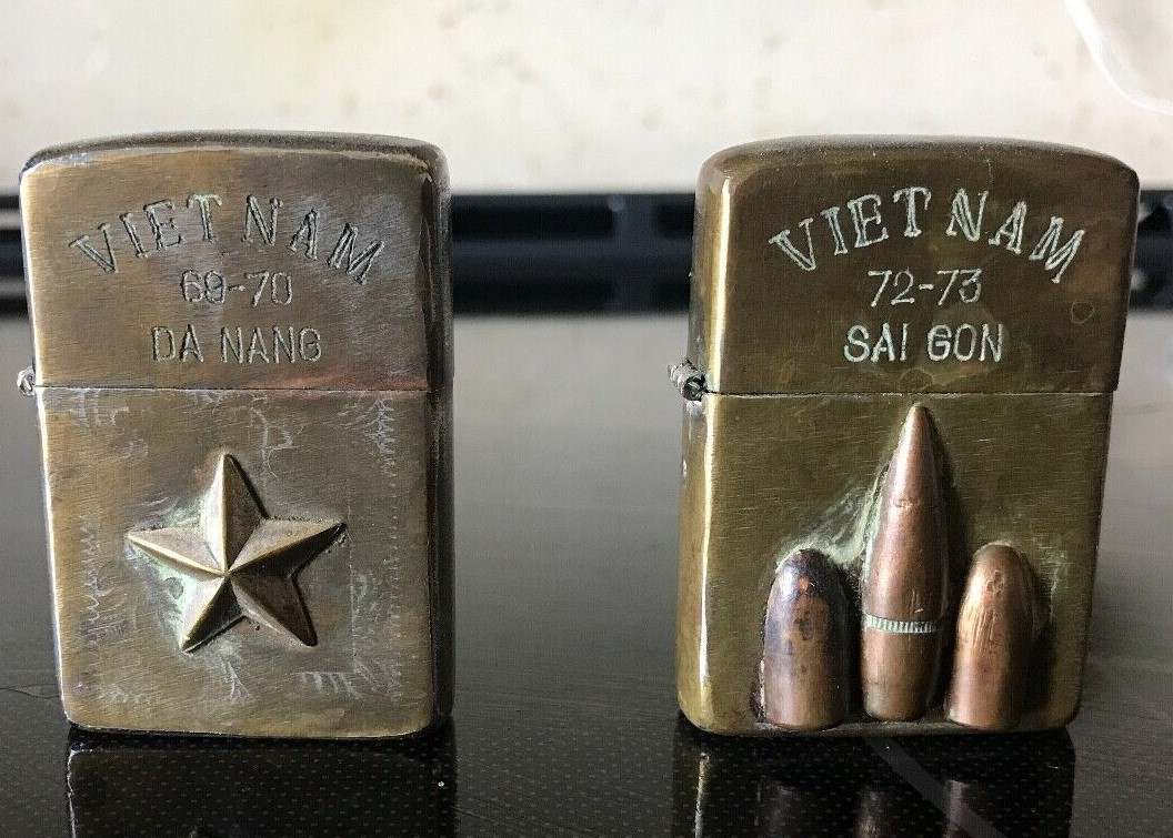

A troubling new trend: I’m seeing several fake “made in Vietnam” Zippos on eBay that do not have paint in the letters. Here’s an example:
Cobra 6 Actual

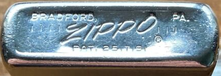

Fortunately many of these fake Zippos have engraved Zippo logos, instead of stamped:

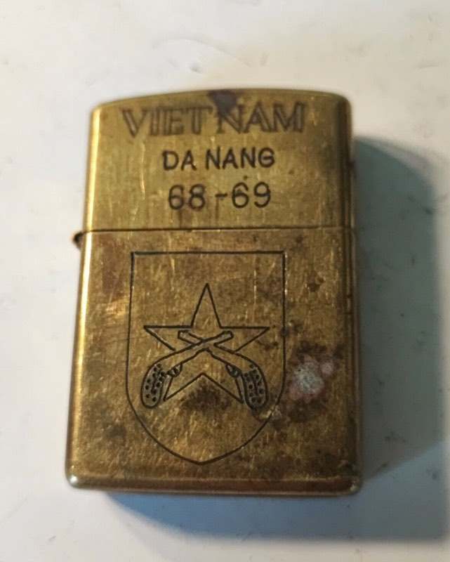

Another day, another fake:
All of the usual indicators, plus this lighter uses an approximation of a South Vietnamese military police patch design instead of a U.S. one. All on a brass case (remember, brass Zippos were not made during the period we were in Vietnam).
Cobra 6 Actual
Here’s the flip side, with the usual nonsensical saying:
And you can have this beauty for only $158.97 plus ~$30 shipping!
