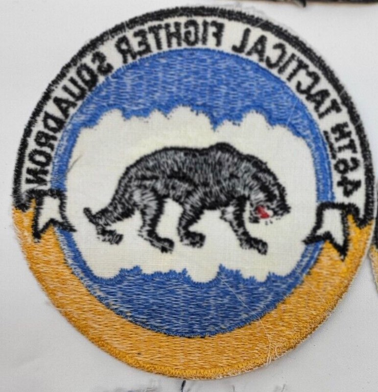

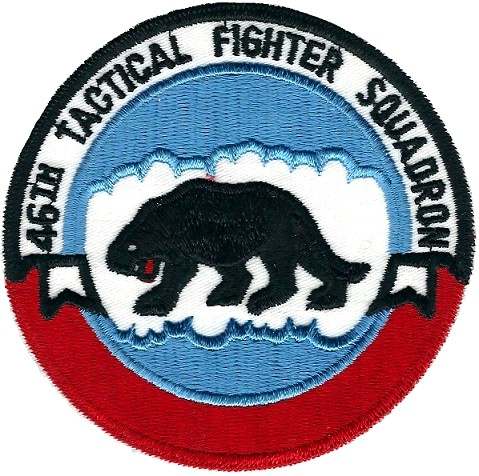

wk4045 Posted March 8 Share #1 Posted March 8 Can you help me to find the timeframe of this 46th TFS patch? What is the difference between the yellow and tbe red version? Thanks Link to comment Share on other sites More sharing options...

wk4045 Posted March 8 Author Share #5 Posted March 8 Thank you. I think this patch is from the 1960s here is a picture of the back Link to comment Share on other sites More sharing options...

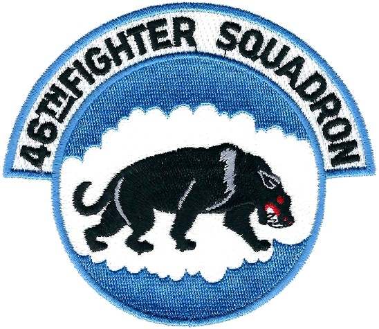

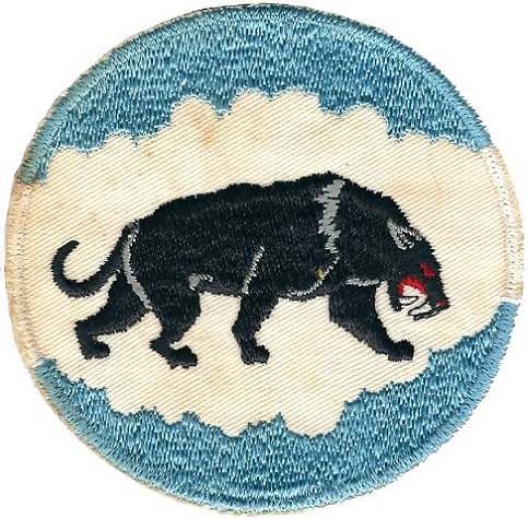

Randy Posted March 8 Share #6 Posted March 8 More specifically, this yellow 46th Tactical Fighter Squadron version was used 62-71 at MacDill AFB, with F-4 aircraft. Yours is US made, there is a Japanese version used early to mid 60s. The red may have first appeared when the 46th TFS was reactivated in 1975 at Grissom AFB flying A-37s. Deactivated again in 1978. Activated as the 46th Tactical Fighter Training Squadron in 1983 at Barksdale AFB with A-10s. Red was used for sure during this time frame, and even though it was a TFTS they used TFS on their patch the whole time until 1992-1993 when Tactical was dropped and the unit again deactivated. The top pic is TFS era, middle is TFTS and bottom is FS. Not sure if FTS was an official designation as all other TFTS units were know as just FS. Randy Link to comment Share on other sites More sharing options...
