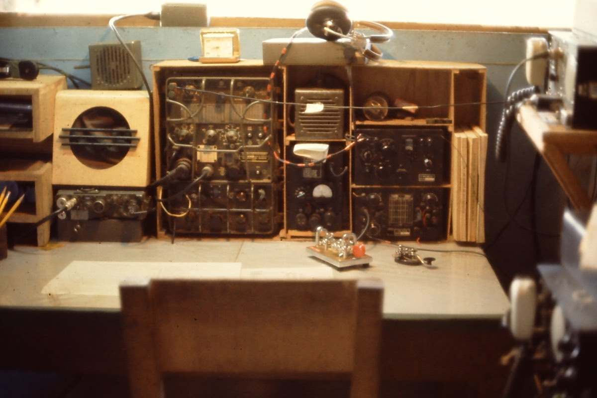

John051 Posted March 11 Share #4 Posted March 11 I was a radio operator in Vietnam 1963 and 1964. I used a Vibroplex Original bug and J45 leg key. Others with used a table mounted key. Link to comment Share on other sites More sharing options...

Historiker Posted March 14 Author Share #6 Posted March 14 On 3/10/2023 at 10:23 PM, John051 said: Thanks for this info, and for the photos. Looks like maybe a J-36 next to your Vibroplex? This is the most recent summary I've found in print about post WWII keys, so I really appreciate you sharing your experience: https://radionerds.com/images/9/9e/Telegraph_key.pdf Link to comment Share on other sites More sharing options...
