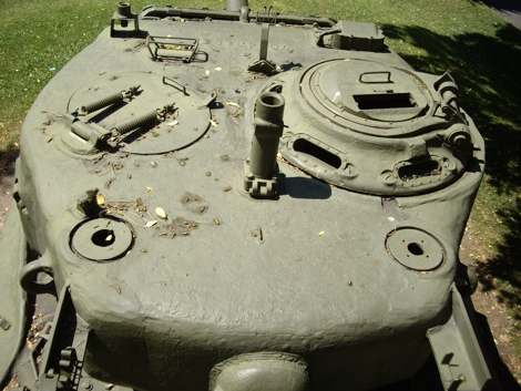

It appears that, in some cases, the .50 caliber machine gun is mounted in such a way as to place the muzzle close to the Commander's hatch. This seems to be most common when the 50 caliber is mounted between the Commander's and Loader's hatches. If the 50 is fired wouldn't the muzzle blast make the Tank Commander's position untenable?

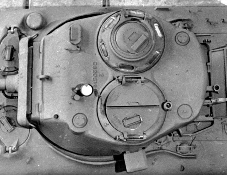

Depends on the mounting point.

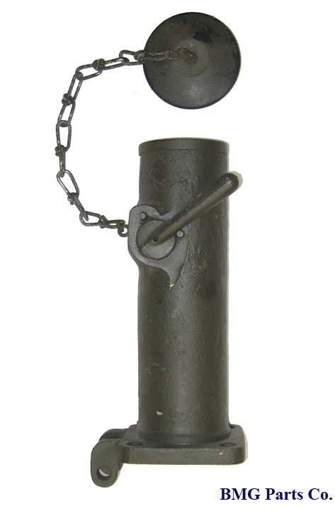

Some M4series had a pintle mounted between the Cdr and loaders hatches or even to the rear from the factory (M4 105mm variant). They could and were relocated by crews to suit, some to the front of the Cdr hatch Esp. when the Vision cupola was used as it didn't have the integral Gun mount in the hatch ring.  It was a relatively simple mod of welding a plate to hold the hinged pintle mount where you needed it. there was also a storage pintle for the receiver and mount cradle to the rear on late 75mm and 76mm turrets
