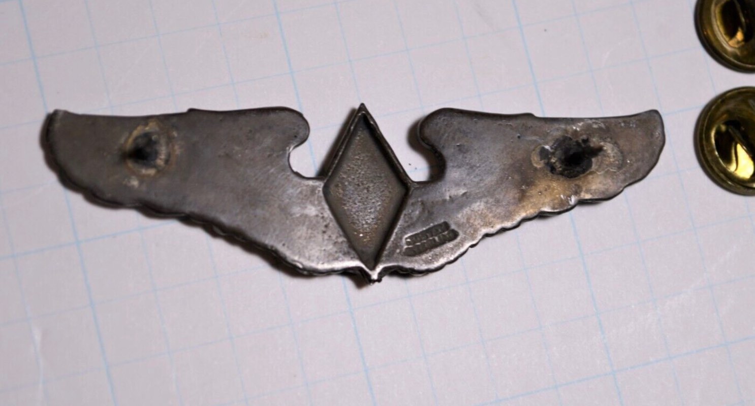

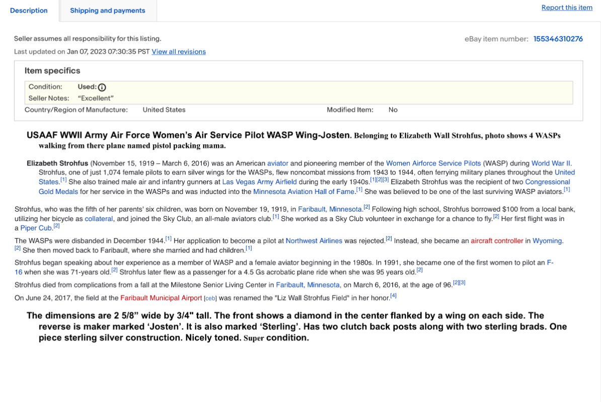

Noelle Posted January 7 Share #1 Posted January 7 Obviously the current wing pin on eBay is a fake. It wasn’t owned by Elizabeth Wall Strohfus, and isn’t even the right size, and it’s pitted, which shouldn’t happen with stamped silver. But the photos, which do look authentic and are shown as some sort of evidence, made me wonder this. What counts, and how can you know that the documentation and accompanying pin actually go together? Link to comment Share on other sites More sharing options...
The Rooster Posted January 7 Share #2 Posted January 7 Nothing that I see actually ties this Woman to this wing. Unless Im missing something? Further more it looks like a cast wing that some one braised posts onto, in a very sloppy manner and the clutches are modern not period correct. The patina, sulfer turns a wing black after 80 years and not gray. Looks like a phony cast clunker artificially aged. I have some original photos of a wasp pilot. Anyone can pair a photo with a wing real or fake and claim it came from a pilot. The only real way to tell is if it comes from a family member. Link to comment Share on other sites More sharing options...
manayunkman Posted January 8 Share #3 Posted January 8 There is no way to establish a connection here. You need evidence of a connection. Link to comment Share on other sites More sharing options...
cwnorma Posted January 8 Share #4 Posted January 8 @Noelle, This has been a tactic of some unscrupulous people in this hobby for decades. Find some documentation and/or period photos, pair it with a fake badge and voila: "Documented grouping." To answer your question, there really is no single standard by which something becomes documented. You have to use your judgement and ultimately all the puzzle pieces should fit neatly together. If the items have been together for many decades, rarely will they not complement each other. In this case, the faker is trying to back the uneducated into a sale by using some real documentation to entice them into accepting the fake badge (ostensibly the money piece). He hopes his pigeon will be convinced to look past the badge's problems because of its association with the ancillary material. To be honest, because of your correct analysis of the badge above, you have demonstrated that you are already too sophisticated a collector for this type of faker. He is hoping for a less educated and discerning pigeon to come along that he can hang his dreck upon. A real badge stands on its own and the documentation only serves to add value to the group. Chris Link to comment Share on other sites More sharing options...
