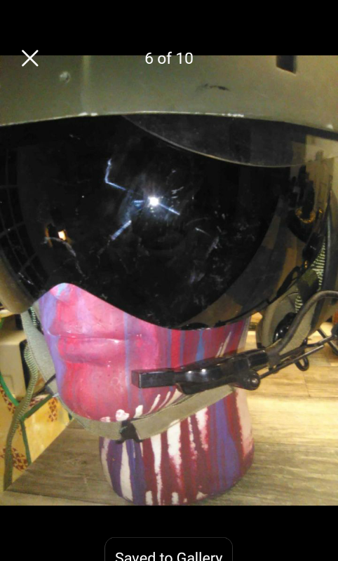

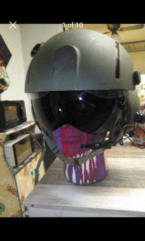

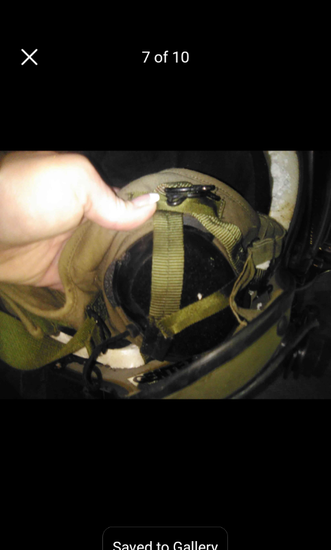

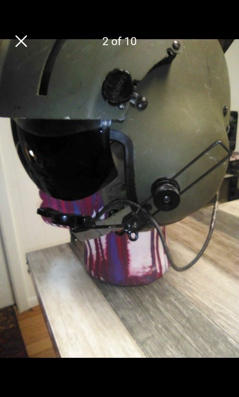

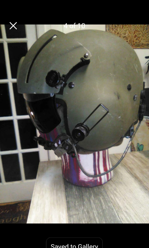

ShibaLegend Posted November 23, 2022 Share #1 Posted November 23, 2022 Someone near me is selling this. What model of flight helmet is this and when was it used based on the pics? Link to comment Share on other sites More sharing options...
doyler Posted November 23, 2022 Share #2 Posted November 23, 2022 Looks like a Gentex SPH4 dual visor 1980s-90s The center raised rib is for a NVG bracket I recall. Link to comment Share on other sites More sharing options...
mohawkALSE Posted November 23, 2022 Share #3 Posted November 23, 2022 That is an SPH-4B, earliest it could possibly be is from later 1991 and on. It is a correct SPH-4B as well and not just an SPH-4 with the 4B dual visor assembly. Has the correct color shell, and ear cup retention assembly aside from the dual visor housing making it a factory B. There should be a tag inside near one of the ear domes with the spec info. Edit to note these were used early 90s into the early 2000s as they were being replaced by the new HGU-56/P. Those dymo labels at the back corner should have the ALSE next inspection due date on it to give you an idea when that one was last used. Also to add to that, these helmets are actually still used, but modified a little by Army Special Operations Aviation in the H-6 series helicopters. Link to comment Share on other sites More sharing options...

Vark_07 Posted November 24, 2022 Share #7 Posted November 24, 2022 Concur, a genuine SPH-4B from the 90's, with the specific dual-visor housing designed to host the ANVIS-6 NVG mount. 150$ is a killer price considering what's available on the used / auction market and prices asked nowadays, I'd definitely NOT pass on that if I were you ! (even if the 90's are not your cup of tea) Link to comment Share on other sites More sharing options...
