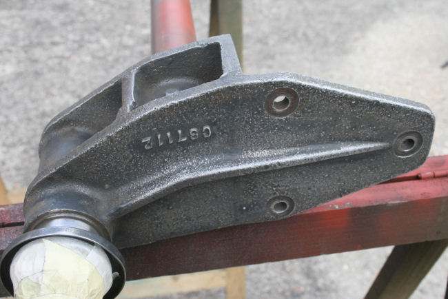

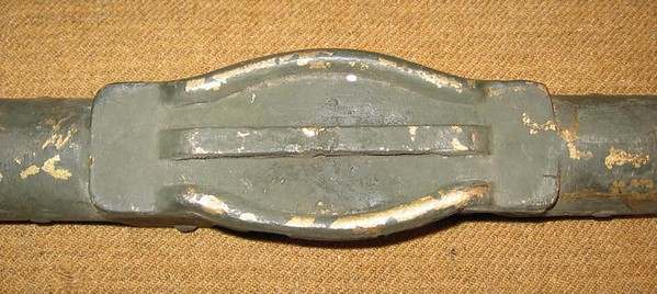

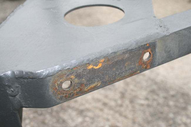

Johan Willaert Posted May 17, 2011 #52 Posted May 17, 2011 Original flat OD on the axle underneath the Swiss gray.... again no primer

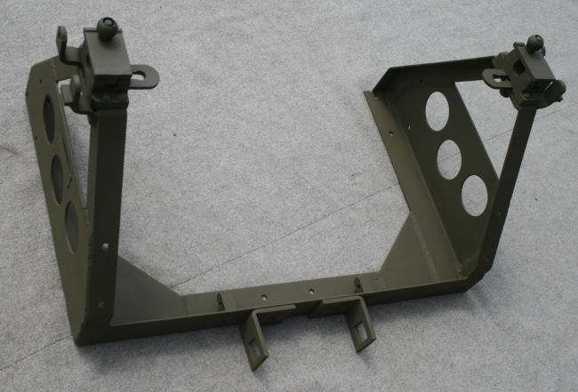

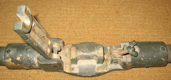

Johan Willaert Posted May 17, 2011 #53 Posted May 17, 2011 Spindle brackets.... Seems the Swiss took the carts apart to paint them...

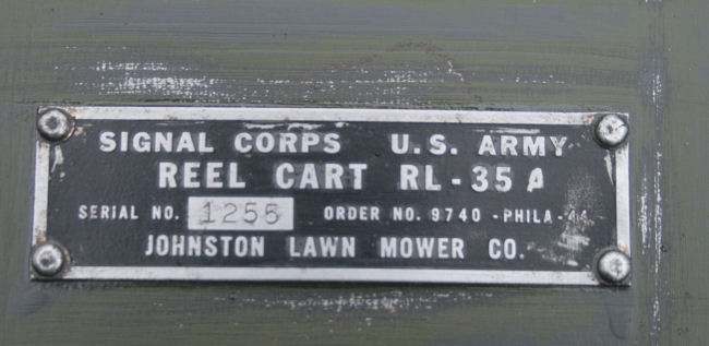

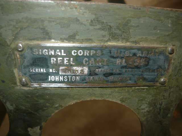

Johan Willaert Posted May 17, 2011 #54 Posted May 17, 2011 At least the dataplate's still readable, albeit a bit scratched...

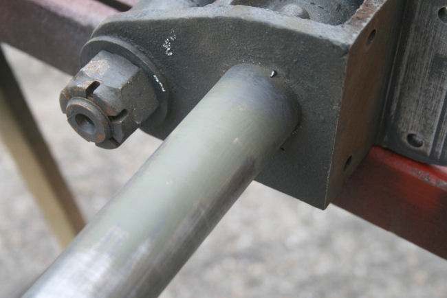

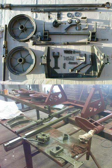

Broccoli Posted May 18, 2011 #56 Posted May 18, 2011 Hello Johan, nice job! I have the axle brackets from cast iron, too.. I did not know that the wheels on utility carts have no bearings! It's really interesting.. On my cart there were parts panted just Swiss grey with no OD under, it looks the Swiss army had a little more time to paint it than the WWII manufacturer It seemed, that there was some light green primer on the wheels under the OD... but I haven't found any primer on other parts.. but I painted it all parts with a red primer... and dissembled, I hope you won't punish me for that... I have left the original OD on the inner part of the rim... your dataplte looks very good, mine still has a little bits of grey paint left. Sending here a photo of the cart dessembled as you got on your web I really like the tires! Frankie

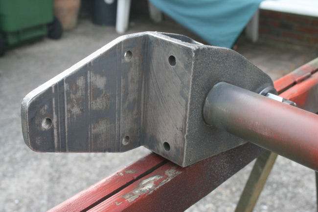

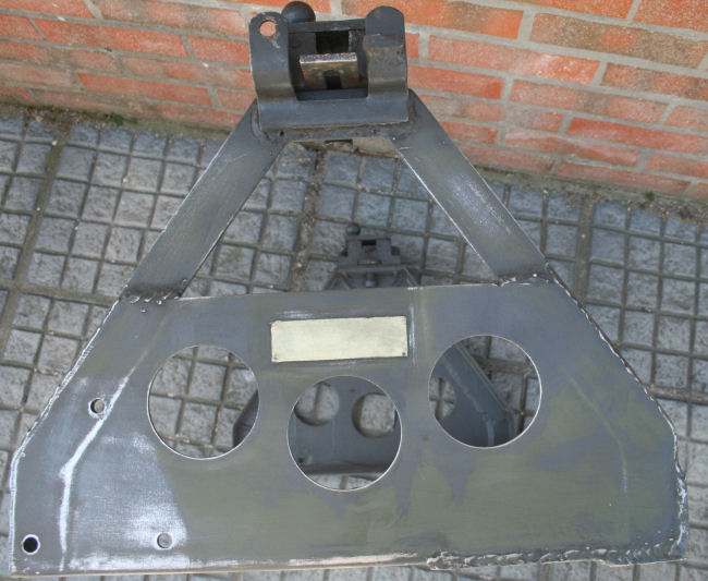

Johan Willaert Posted May 25, 2011 #59 Posted May 25, 2011 More proof that the Swiss took it apart to repaint it in gray, but that these were originally painted OD after assembly...

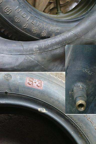

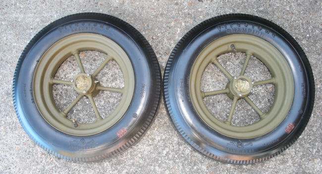

Johan Willaert Posted May 25, 2011 #60 Posted May 25, 2011 Today upon assembling the rims and tires, I noticed yet another difference between the two original tires on this cart... Both are Firestone Champions, but the font of the name is larger on one tire than on the other...

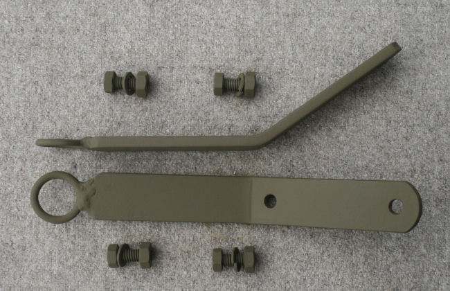

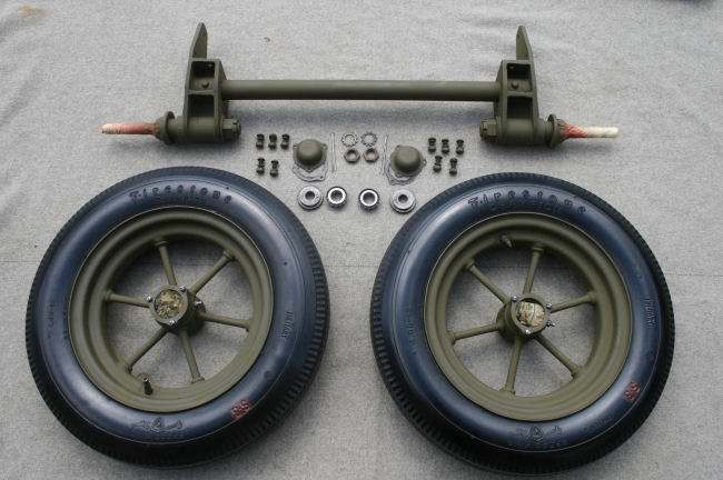

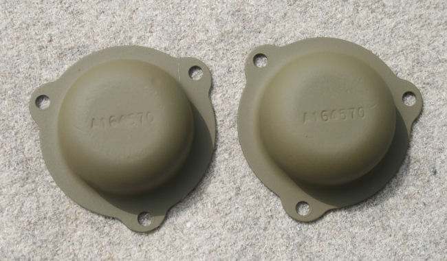

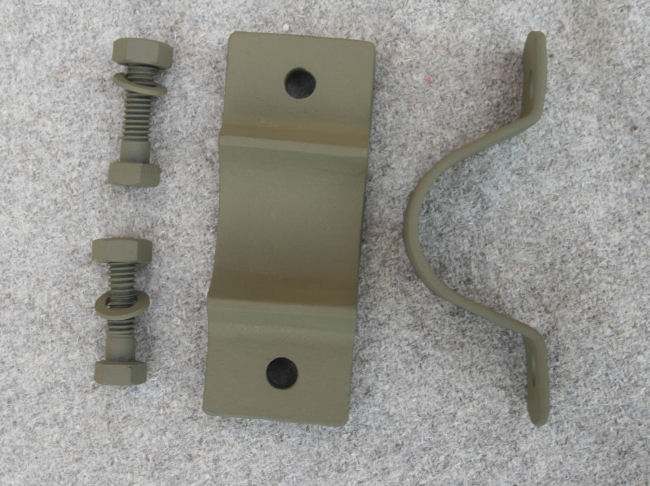

Johan Willaert Posted May 29, 2011 #63 Posted May 29, 2011 All painted and awaiting assembly.... Some pictures of parts as reference or for those that like details....

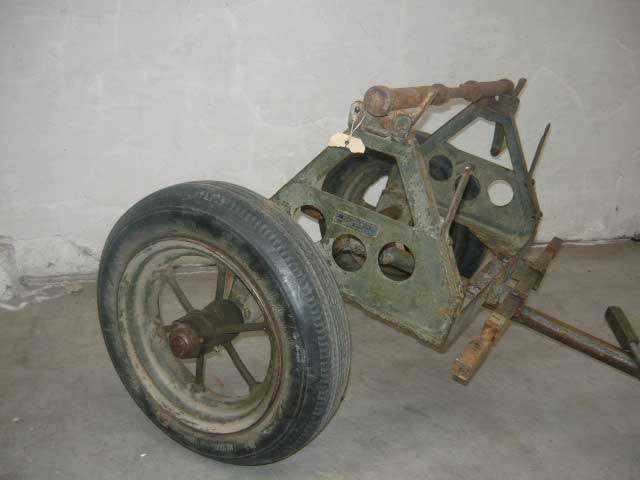

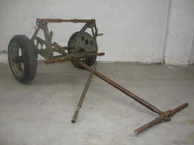

Guest csmchris Posted June 20, 2011 #67 Posted June 20, 2011 Hi there everyone. I'm a new member from across the sea and have just brought a RL-35 Signal Corp Wire cart. It is almost there althou missing the DL- 4 reels and rl-27 bits. The ones that came with it are wrong. i'm having a terrible job trying to locate over here in the UK, and being a serving soldier don't get that time to look round. Any idea's or leads folks CSMChris
Johan Willaert Posted June 20, 2011 #68 Posted June 20, 2011 Wasn'this on milweb? Anyway you have at least one GC15 crank and the RL27. They are attached on the top of the frame where they shouldn't be. The separate axle laying on the floor and the one currently attached to the front of the cart are/is the one that should go up there. DR4 are around at swap meets or militaria shows... GC15 and the GC10 Brakes are quite hard but not impossible to find... Let me know if you'll be at Beltring next month. Maybe we can meet up and talk reelcarts... JOhan
Guest csmchris Posted June 20, 2011 #69 Posted June 20, 2011 Hi JOhan, thanks mate, yes this was the one on Milweb, the two axles on the front front will not fit onto the top as the round part that sits into the spindels are not long enough. they have no serial marking on so think they maybe post war. the hand crank has a circular hole that fits into the handel and will go into the front. i will be at Beltring next month from the thursday till sunday and will have the cart there with me. I would love to talk carts and find out a little more about them. csmchris
Johan Willaert Posted June 20, 2011 #70 Posted June 20, 2011 Strange and maybe not that visible on these pictures. I will be in Beltring on the Saturday. I will gladly try to come over and see the cart and see if I can help you. Will contact you a couple of days before. Johan
Guest csmchris Posted June 21, 2011 #71 Posted June 21, 2011 thanks mate that would be great. any info gladly accepted. csmchris

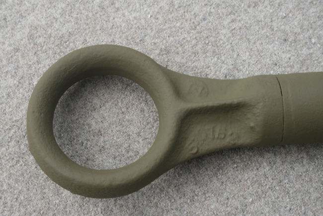

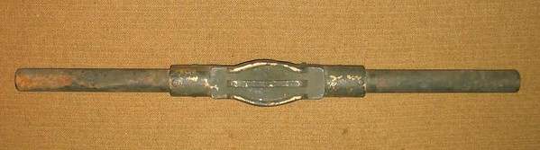

craig johnson Posted July 27, 2011 #74 Posted July 27, 2011 Looking for an original RL-35 Drawbar. Must be all steel with no brass parts. Thanks Brass example :thumbdown: :thumbdown: :thumbdown:
