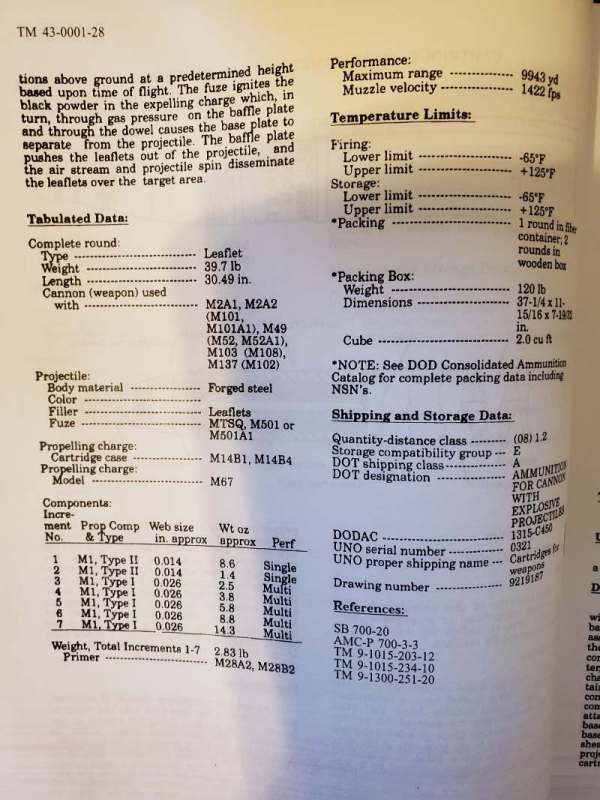

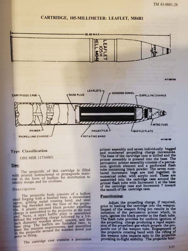

According to TM 43-0001-28 Army Ammunition Data Sheets your round is in fact a leaflet projectile and uses either Fuze MTSQ M501 or M501A1.  Color on the data sheet is blank , so no help there.  I have found no smoke round using that nomenclature in 105mm.
