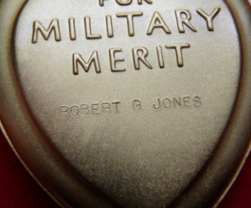

WWII hand engraved - Peele (lots of different engraving hands on wwii period)
WWII large machine engraved - Willett

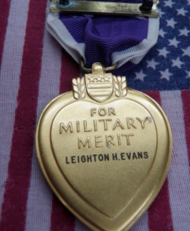

WWII small machine engraved - Evans
WWII Pantograph engraved - Jones
Post WWII 46-47 script engraved - Hedge

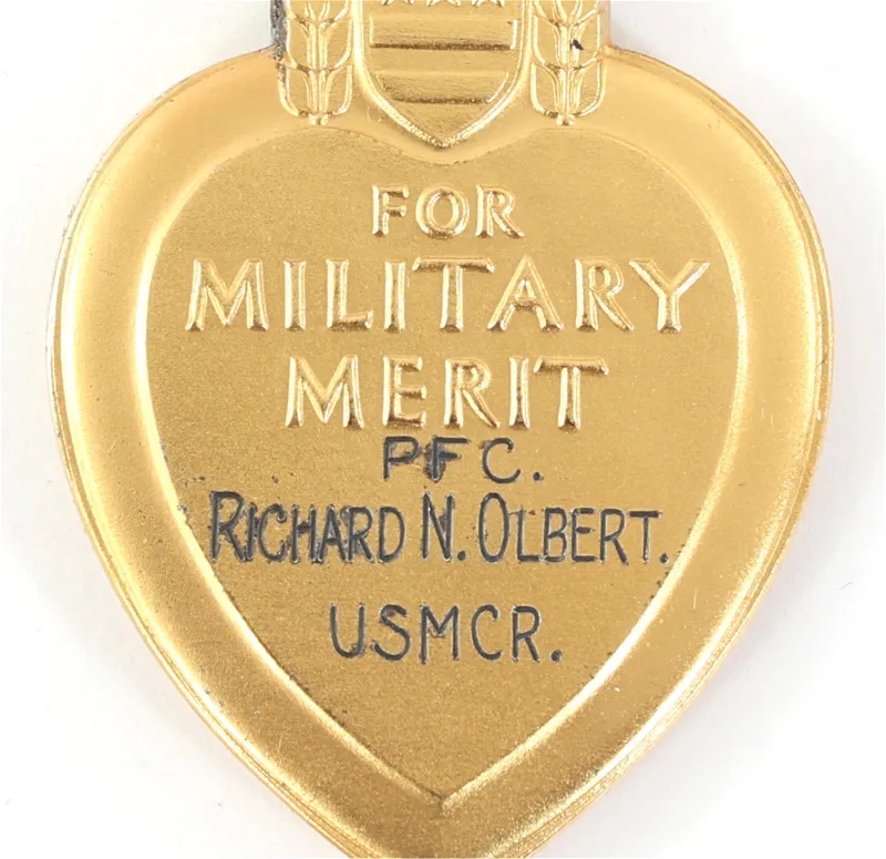

Another USMC fake engraving that has popped up? Again at an Auction House on LiveAuctioneers.
This time, a Navy Cross group to 2nd Marine Raider Battalion, Pvt. Richard N. Olbert.
What does everyone think? Personally, I wouldn't touch it with a 10ft pole..

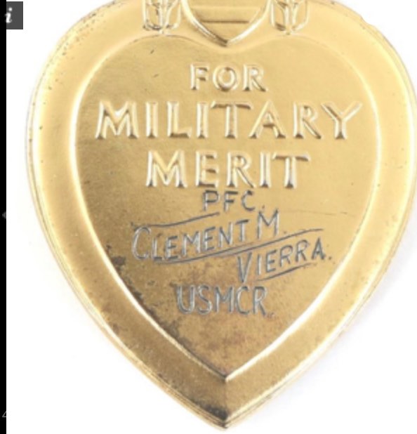

The following are back up for sale by Centurion Auctions on LiveAuctioneers..
WWII USMC PARAMARINE PURPLE HEART KIA NAMED GROUP
WWII USMC Named Purple Heart and Silver Star Grouping. Named to Private First Class Clement M. Vierra.
He served with Company C, 1st Parachute Battalion, 1st Parachute Regiment, 1st Marine Amphibious Corps, FMF in the battle of Bougainville, Solomon Islands where he was killed in action on November 29th, 1943.

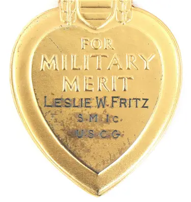

Another high end fake grouping? Also being sold by Centurion Auction.
WWII US COAST GUARD KIA NAMED D-DAY MEDAL GROUPING
WWII US Coast Guardsman Omaha Beach D-Day Landing KIA Named Medal Grouping. Named to USCG Seaman First Class Leslie W. Fritz. Killed in Action on June 6th,1945 during Omaha Beach Landing.

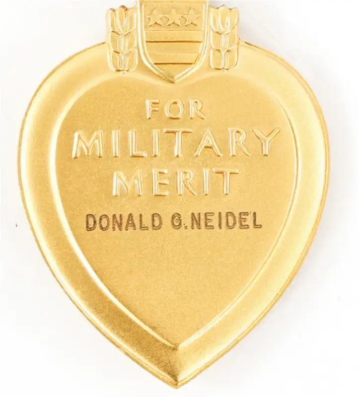

Also questionable? It doesn't look like the usual small machine engraving I'm used seeing on WWII KIA's.
Brother grouping to Tech. Sergeant Harold J. and Technician 5th Grade Donald G. Neidel, who served with the 96th Infantry Division and 4th Corps?

I owned this group years ago. It’s 100% right. Unfortunately, whoever owned it after I did lost the huge amount of original documentation and paperwork that came with his group.
Donald was in an Engineer Maintenance co in the ETO. Harold was in the 96th.
It appears that the Auction House has removed the bad engraved USMC Purple Hearts.
Might have gotten word that they were fakes?

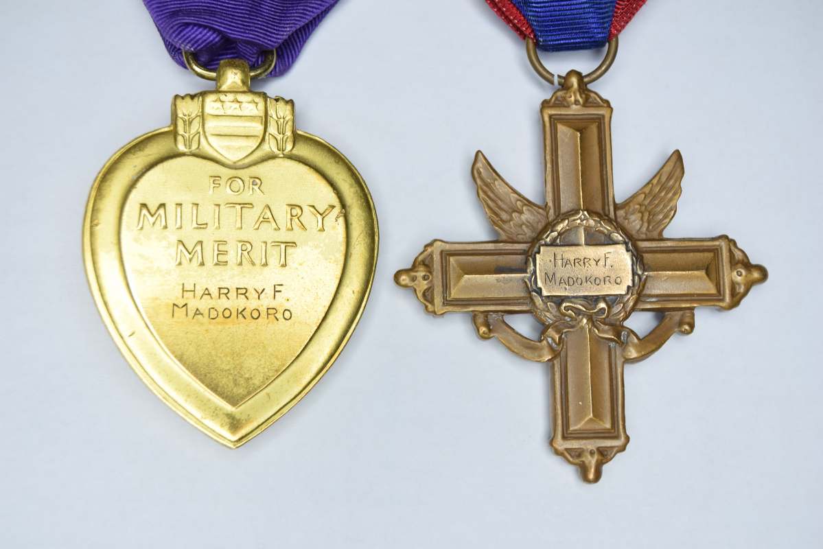

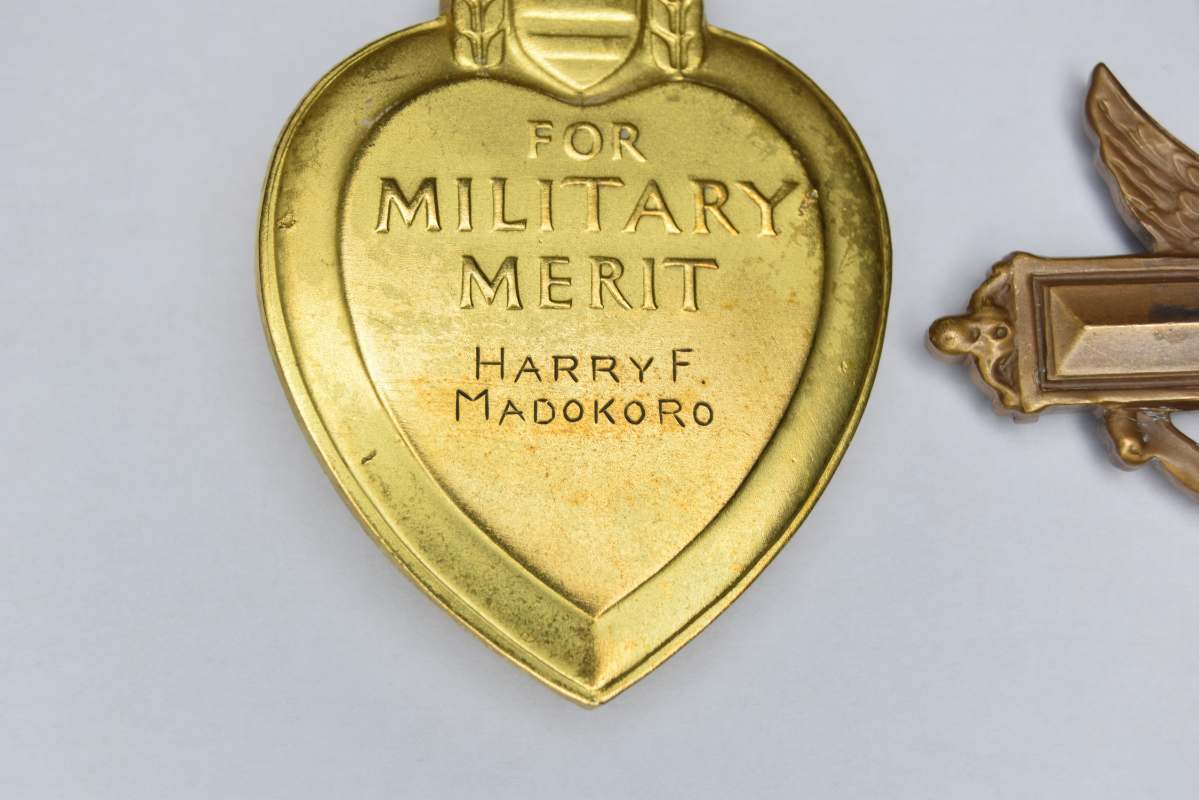

I'm not wild about Harry, even without a loupe or microscope.   Compare the M  and K where the diagonals have a gap to the W in the other medal.  Compare the two "A"s in Lang to the two "A"s in Harry medal.  Compare the first two "R"s that don't look too bad to the last "R".   Compare the overall uniform thickness of the cuts in Arrington medal to Harry, particularly the two verticals in the "H" and the "A" preceding the two "R"s.   Overall,  I see an assured, smoothness and even pressure applied for the cuts of the other two medals that just ain't in Harry's.  Also, unless I missed it,  neither of the two guys who have professionally studied a lot of US PH and valor award engraving and are commenting on this post, have given Harry's group of two medals the Good Housekeeping Seal, despite it being posted twice. 🙄

Madokoro's group has been discussed on this forum and others, and that grouping does not have any fans among those of us who study engraving.
