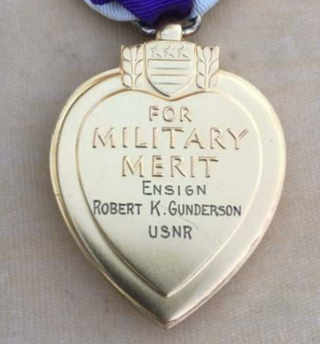

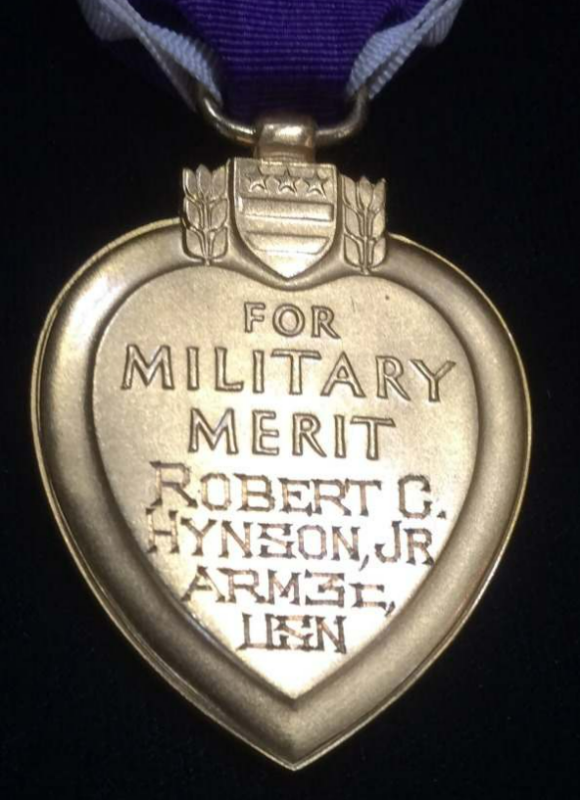

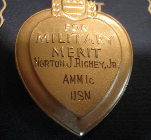

This is the engraving style that I have only ever seen on USN PH's engraved this late (Aug 1946 + )
On the other hand this Purple Heart was engraved / issued in Nov 1945 .
The Scarlet Pimpernel
Nice medals Kurt!

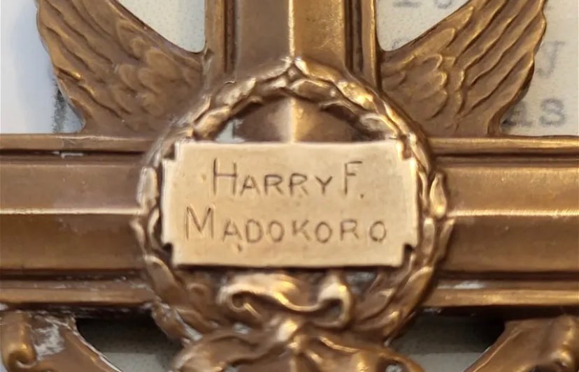

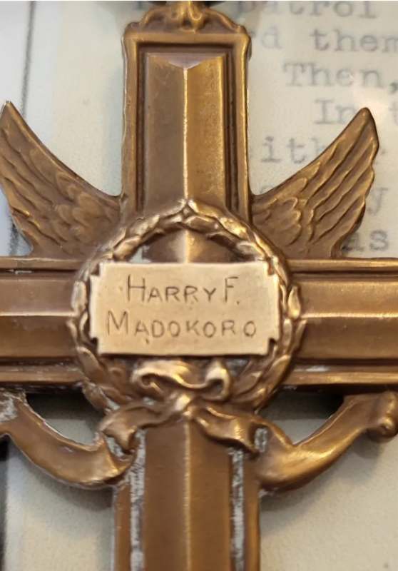

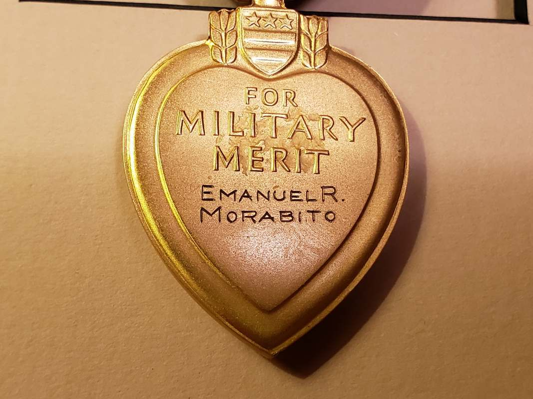

Here are a few others I'd like to have double checked.
Thanks all!

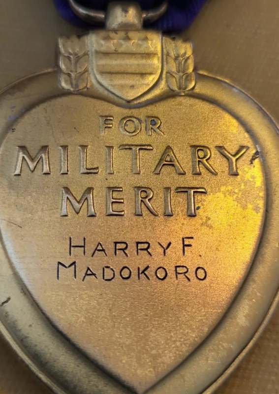

The engraving on all of these look fine.
The Madokoro medals look like this same hand I believe.
Personally I would not bid on that 442 group…but that is just me…to each their own…I don’t believe this looks like the same hand as Morabito

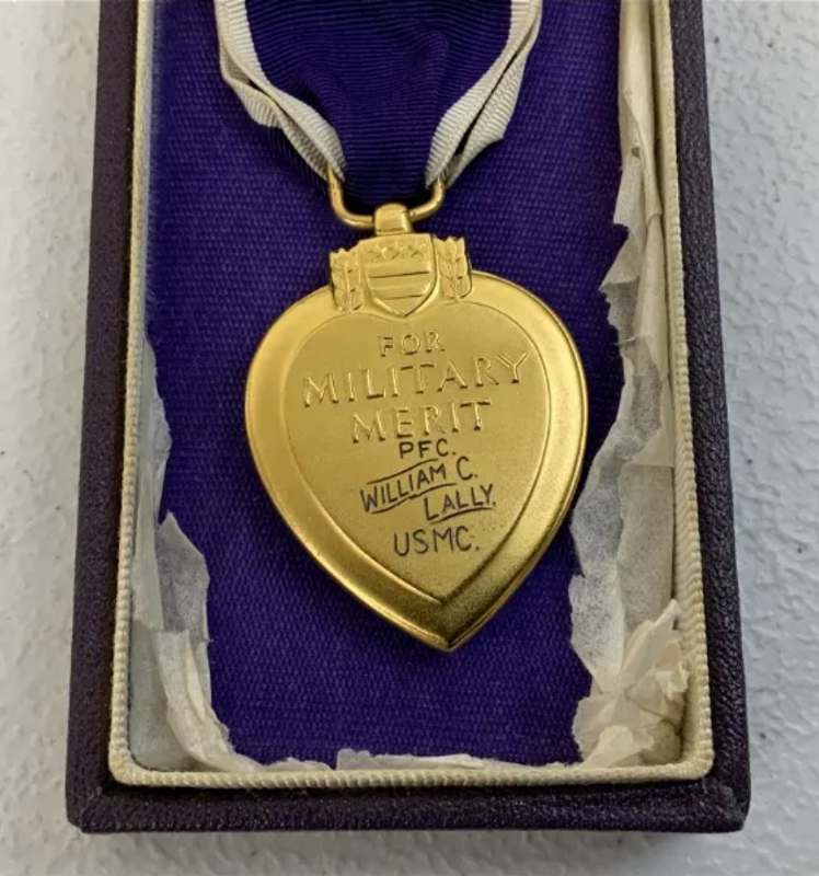

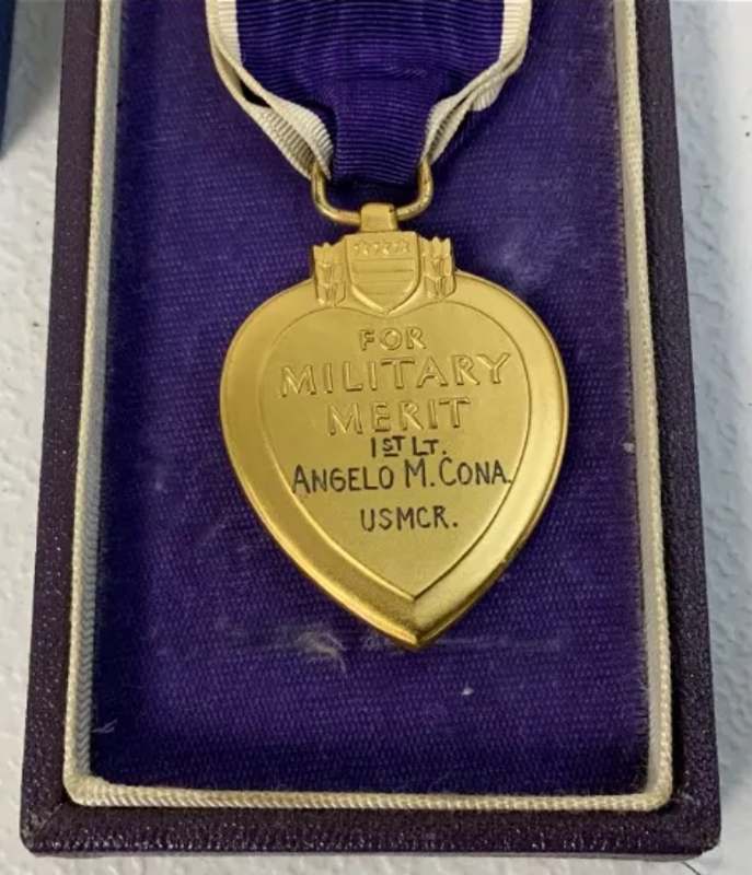

Looking for opinions on this one, never have dipped my toe into the USMC pond, so not as familiar with what to look for as I would like to be.
Looks like a nice slant engraving style on a Navy/USMC type 2, wrapped brooch heart. It's also in the correct, short titled case.

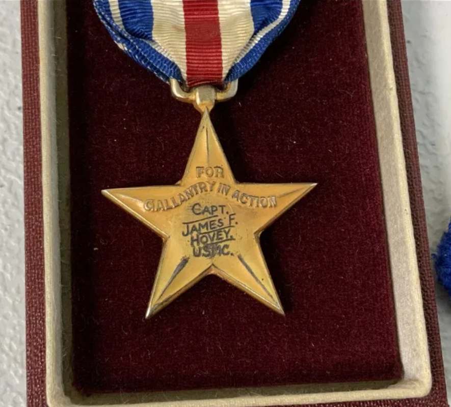

On 12/4/2022 at 4:09 AM, S1991 said:
Double checking this KIA Marine on Tinian. Knowing lately lots of fake Marine Corps/Navy engraved medals have showed up..
So, whats your opinion on it?
I'm not an expert on medal engravings, but it does seem a little odd to me there's significant wear on the reverse of the Silver Star Medal planchet, and the ribbon drape is super crisp and looks like it could have never been worn.
It wouldn't have been worn, at least by Hovey. He was KIA. For some reason these Navy/USMC Silver Stars and early Army types show more wear and darkening than the later Army types.
Basic Rifleman
Yeah... I probably should have phrased that differently.... I do know the KIA medal group would not have been worn by the recipient. I'm also aware there is toning or patina that forms on some of these earlier SSM's; I have several. I was just trying to verbalize my thoughts about what appears to be inconsistent wear or aging between the medal and the drape in the case of the Hovey group. I should have also likely not commented in this particular thread about anything other than the medal engravings.... I'll haze myself later:)

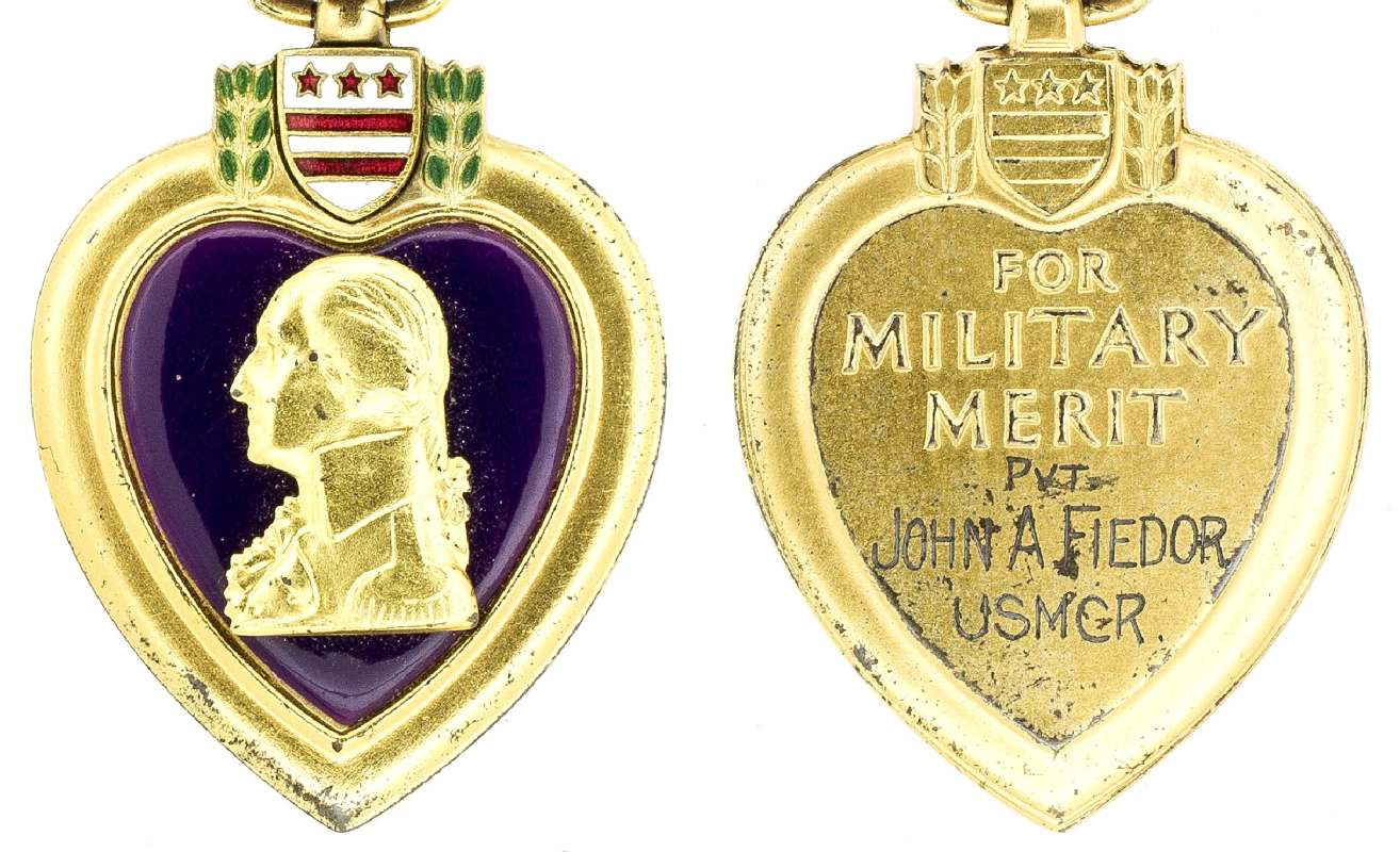

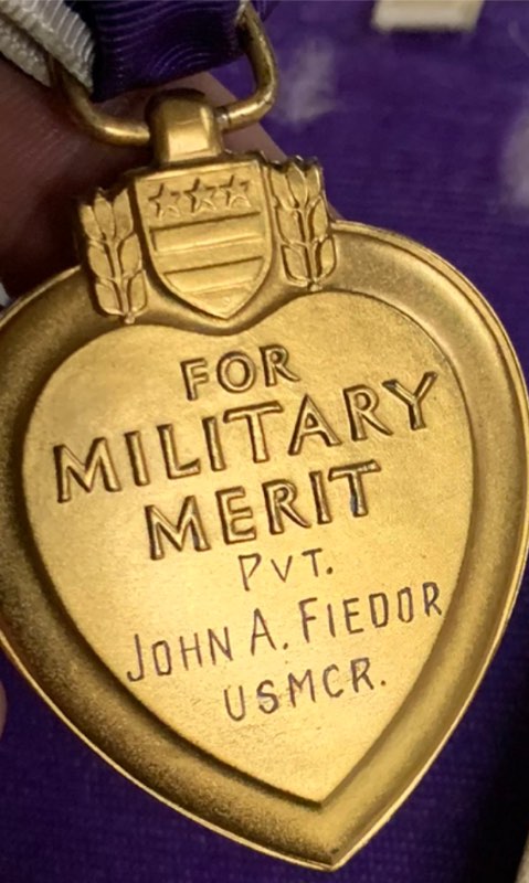

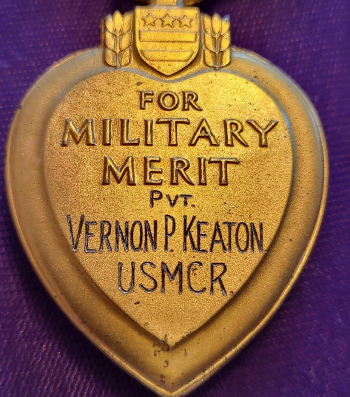

What does everyone think of this one? It’s a type 1 in an early purple box.
Fools rush in, yada, yada.  I'll go first, knowing 50/50 chance the PH experts see things differently, and of course, their opinion on PH engraving much more weight than mine.   I'm thumbs down if its a stand alone item without  ironclad provenance like out of the woodwork,  or other really strong corroborating material.    It seems like an unsure hand with uneven pressure.  The two low case "O"s for comparison don't look at all similar as I'd expect from a skilled engraver who's been laying down letters all day on lots of medals.   All the letters look sloppy to me.  That second "O" looks really bad.  The characters, particularly the PVT have an overall look reminiscent to me of the faux Egyptian Hieroglyphics using the Western alphabet.   IMFO.   Next...
Here's Fiedor's actual, issued, Purple Heart. The one above is not official engraving. That said, did someone in the family have a second one made for another person? I have a group in my book where there were two unofficial PHs made by the family and then one official Purple Heart. Are the others "fakes"? No, they're just privately engraved. The issue with this one comes in with provenance. For that one group, all of the medals stayed together through the years and thus, they had good provenance as coming from the family. When you have one randomly pop up...there's no clue where it came from.
Note also, a medal engraved like this, privately, is different than a second official issue medal for the next of kin. Different topic, and those did happen, fairly frequently as I've seen. This is not one of them.
Hope that helps!
