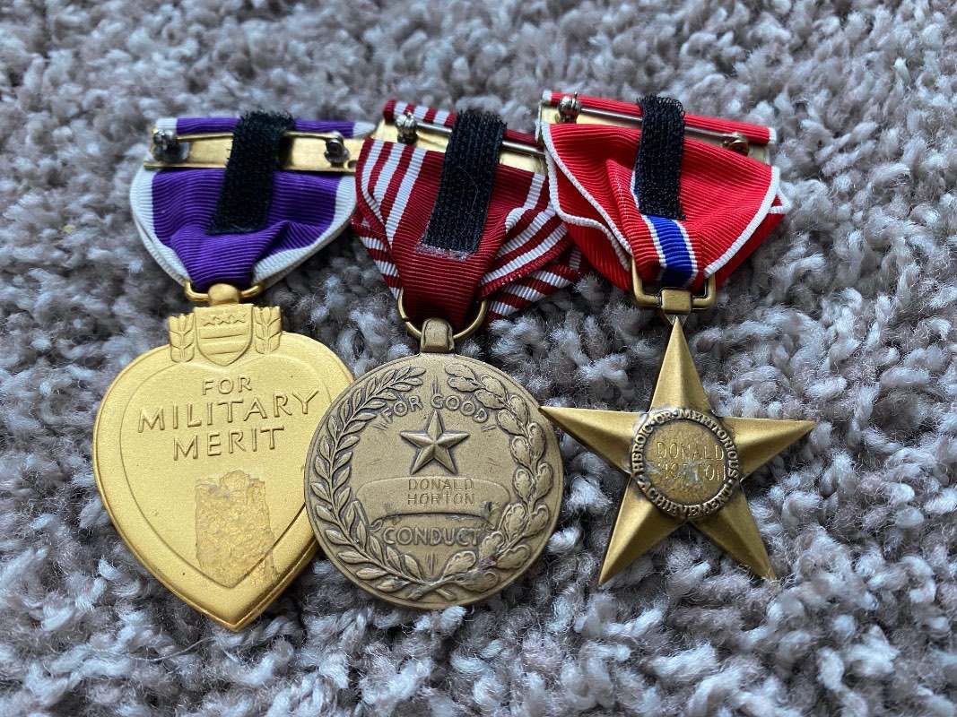

What are your thoughts on the engraving on this pair? Obviously these are post WW2 reissue medals, but I am not sure whether the engraving is government issue or privately done.

The two on the right are more modern day crimp brooch. The heart is a WWII, slot brooch period piece.
These do look like 1980s official government replacements.

Thank you for your input! I could not find another example of these "slanted Os" elsewhere. I will need to go through some of my replacement groupings to make sure.

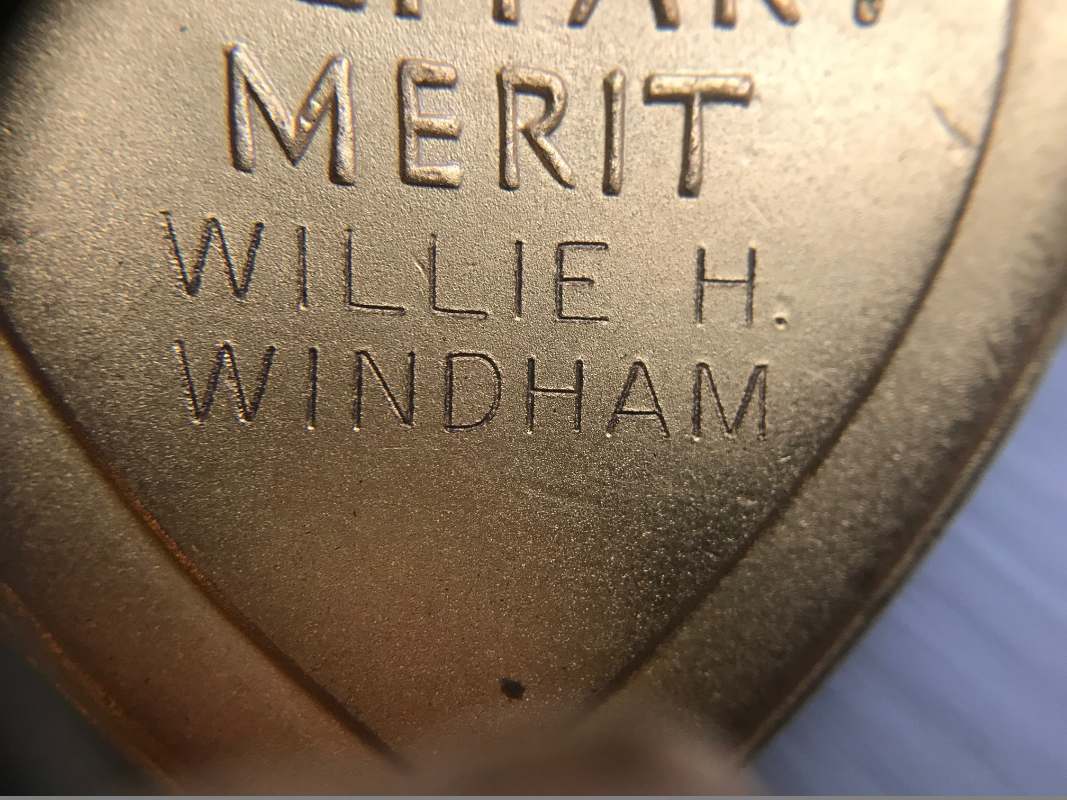

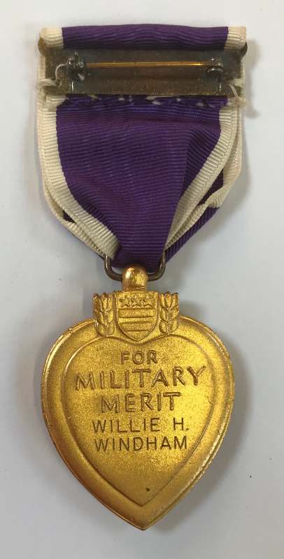

Here's a PH named to "Willie H Windham" which looks very much to me as a WW2 made PH, that has been taken from old QM stock and issued ( as a replacement or even first award?) maybe around 1991 to the recipient as a late claim award? I assume it would have been sent in a modern Arrow-type case and not a "coffin" case. SSgt Windham died in 1993, so the period for it's issuance would be about right. He was wounded 29th March 1945 whilst serving with Co.E 507th PIR having been a jumper in Operation Varsity.
Dave, can you corroborate that's a govt issue medal...and the type of engraving method? (Your detailed analysis on the whole subject really is second to none!)1607275060_WindhamPHname1944robbinsbrooch.jpg.b27bd07c7b6b34e0dd8138960b05bcd3.jpg1526027968_Windhamnaming.jpg.64bf389189b06127f3ba60f48e41052b.jpg
Another question strikes me though; I bought this PH happy in the knowledge that it's a "modern" issue, albeit on a WW2- made PH (which is some recompense) and bearing in mind that he likely never even received a PH during WW2, which would probably have been unnamed anyway..? To that end I'm still happy that I have a WW2 vet's medal. I have in a different life, I also collected British Victorian medals, which were very rarely issued later after such a long period of time! Hypothetically if I were collecting say, Waterloo medals and was offered one to a man who only received it fifty years later, I wouldn't neccessarily turn it down! (Not that that ever happened...it's just to illustrate the point) But this is another discussion topic I guess......R
Well, I am not Dave but I can help on this one.
Yes, the engraving is officially government done on replacement awards, and from the time period you mentioned, 1990's would be about right. And yes, most likely an Arrow case.
He may well have gotten a Purple Heart in WW2, it would have been un-named most likely, and for many reasons he may have gotten a replacement set; lost the original, stolen, burned in a house fire, who knows. He or his family may even have the original and just asked for and got a replacement set of medals too. It is a regular thing.

This medal has been re-ribboned. It was probably part of the huge lot of named medals the PQMD sold in the early 1990s as scrap ( They had no ribbons or suspensions). They made their way onto the market and people added ribbons and brooches to them. I personally saw big baggies of planchettes from this sale people were selling later on.

I agree with what's been previously said. The engraving could be 80s or 90s official engraving, but someone definitely added an old brooch and ribbon to it in order to pass it off as a WW2 era medal (especially if he was a 507th veteran).
Was it a scrap one? I don't know. It could have possibly been something he was reissued before passing away...not impossible at all. But it definitely didn't come with the brooch or ribbon that's on it currently.

That said, do you therefore think it's ok to restore an "original" suspension ring/ribbon assembly to it, more fitting to an early nineties issue PH? This would certainly put it "more" right and is easily done. (I already have a mint condition cardboard boxed/cased dated refurbished WW2 PH set to compare to and use as a template). I ask, because I have restored orpahn British Victorian planchettes in the past with correct suspension and clasps, where the medal merits it; this, in our fraternity, is perfectly acceptable and (to me) pays considerable respect to the medal and the man behind it. Not so worried about the economics-it's the story after all!

Personal opinion...I think restoring it to what it was (or should have been) originally is absolutely fine.

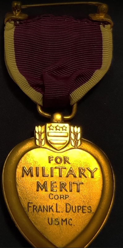

Interested in opinions on this medal and telegram.  Seen several USMC KIA PHs recently up for sale and a few have been questionable.  Thanks in advance.

Looks 100% right.
I agree Swabbie. Looks spot on to me as well. If you know how to decode WU telegrams, you can see that it too is an original. This Marine looks to be a Midway casualty.

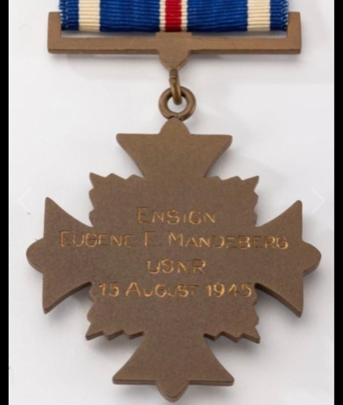

I would love to get everybody’s opinions on this group. Seems odd to me this is a type II medal when his official date of death is August 1946. It should be a type III with plain engraving.
The Scarlet Pimpernel
Type 1 and type 2 hearts were awarded in Vietnam and WWII Army types awarded up through OIF, as I'm sure you know. I think it shows that there are no absolutes with these. The engraving looks good on them.
Just looking at the "3" and the "1945"  they look kinda funky. These two look like they were done privately.
