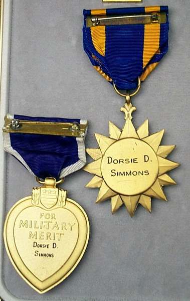

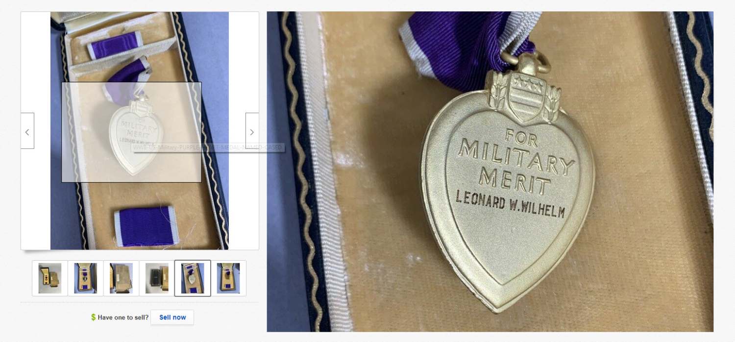

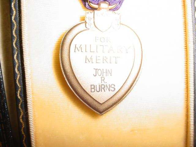

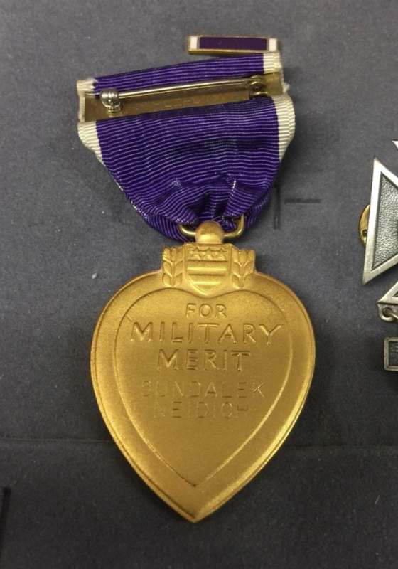

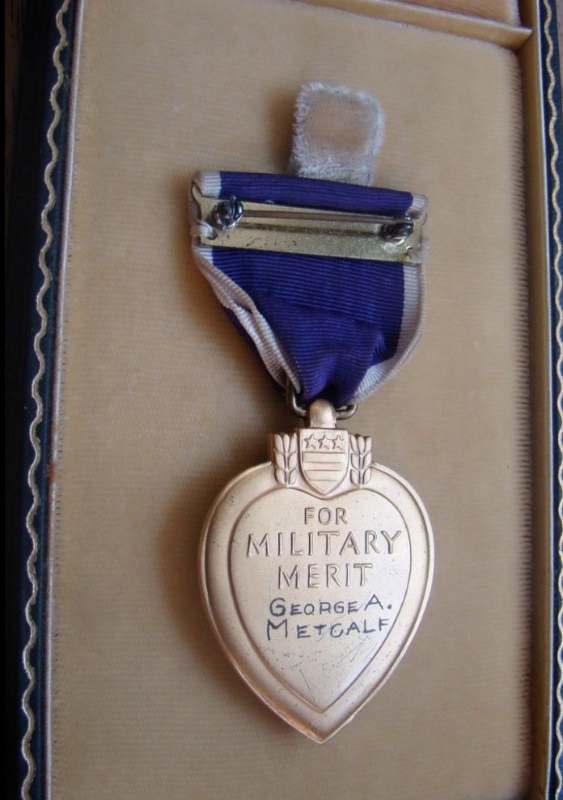

Dave Posted September 3, 2022 Author Share Posted September 3, 2022 Here's another one-looker. This is exactly what I'd expect to see with a 100% right and correctly engraved Purple Heart. Link to comment Share on other sites More sharing options...

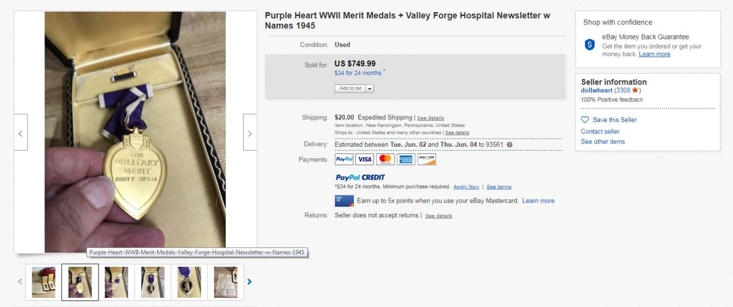

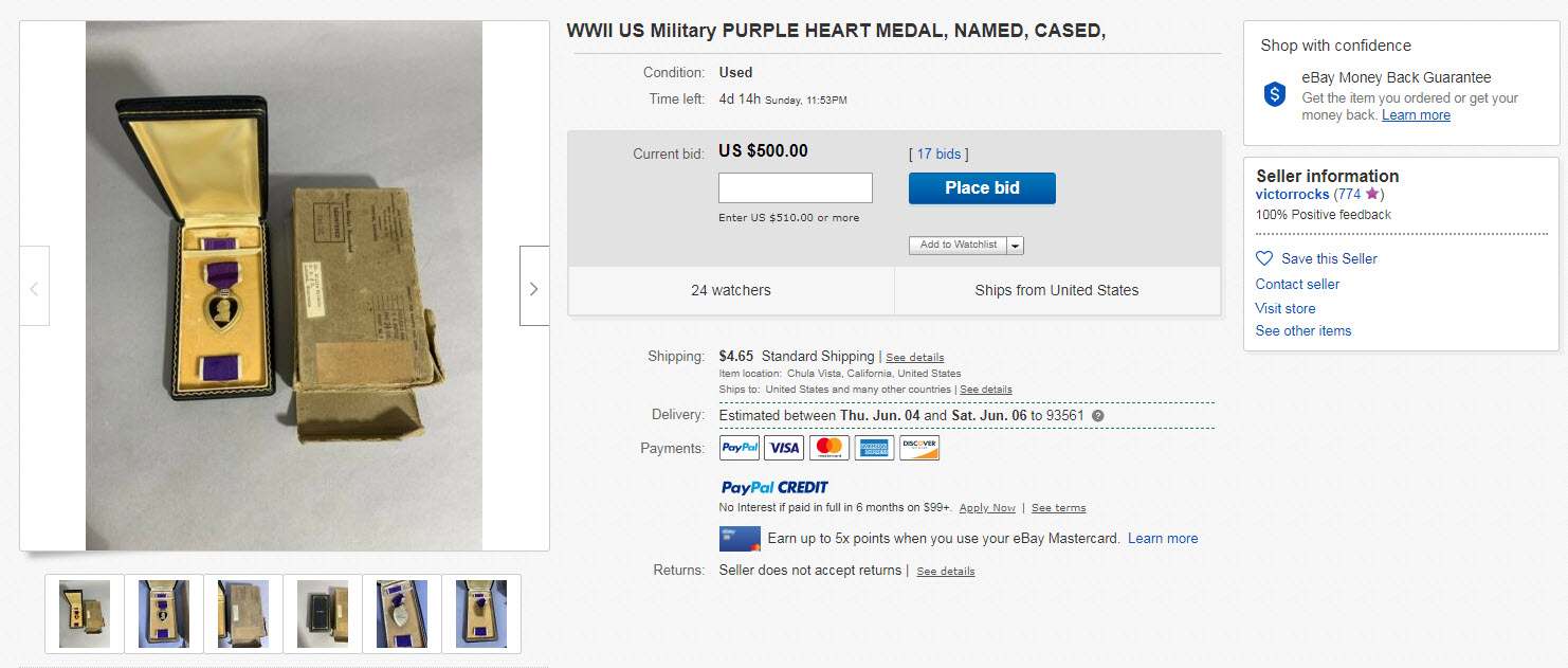

Dave Posted September 3, 2022 Author Share Posted September 3, 2022 This isn't a bad one, but it's a replacement Purple Heart from the 50s or 60s. The soldier probably never got the medal to begin with, so he requested one later. Pretty common. Not sure why it jumped to the final price though. Link to comment Share on other sites More sharing options...

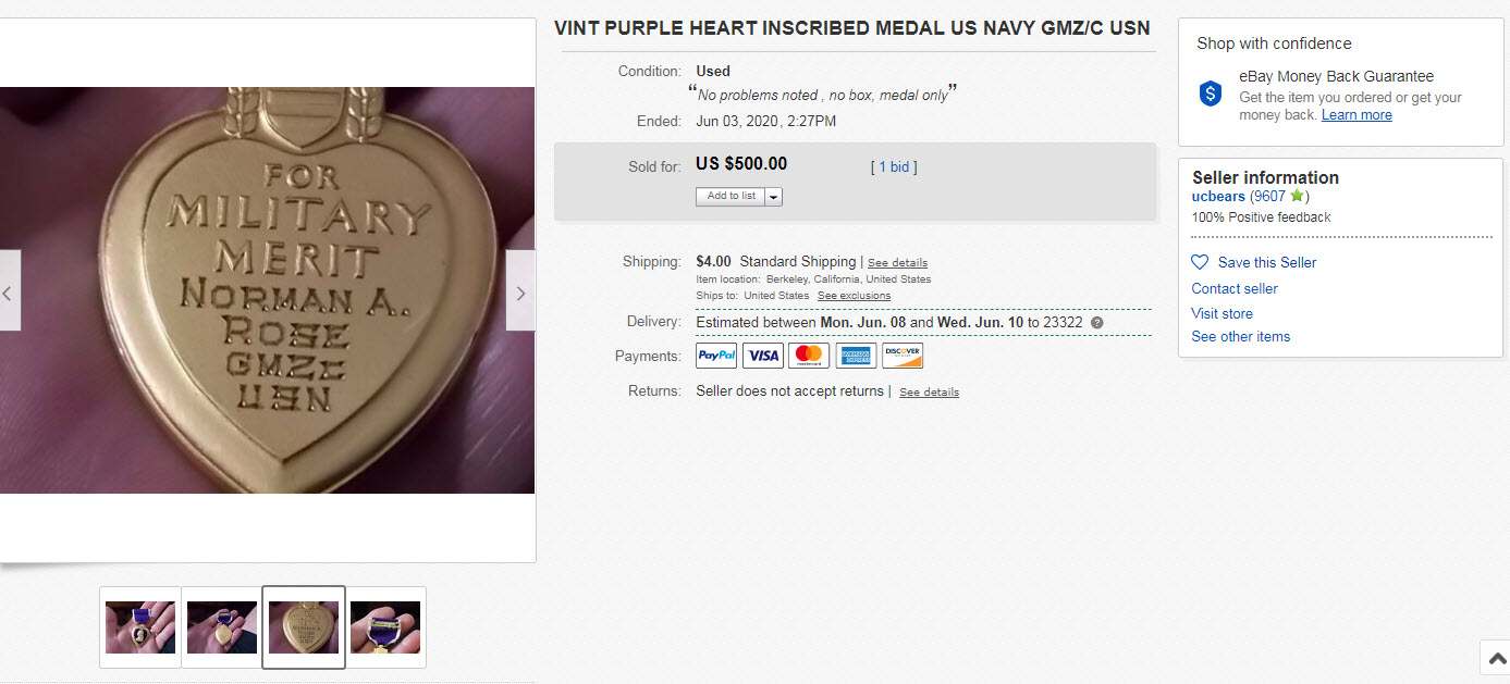

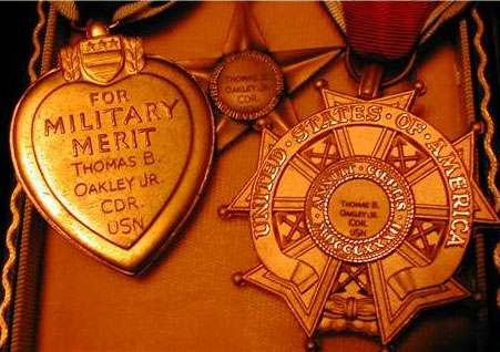

Dave Posted September 3, 2022 Author Share Posted September 3, 2022 Again, a one-looker. Exactly what I'd expect to see in a Navy Purple Heart. Link to comment Share on other sites More sharing options...

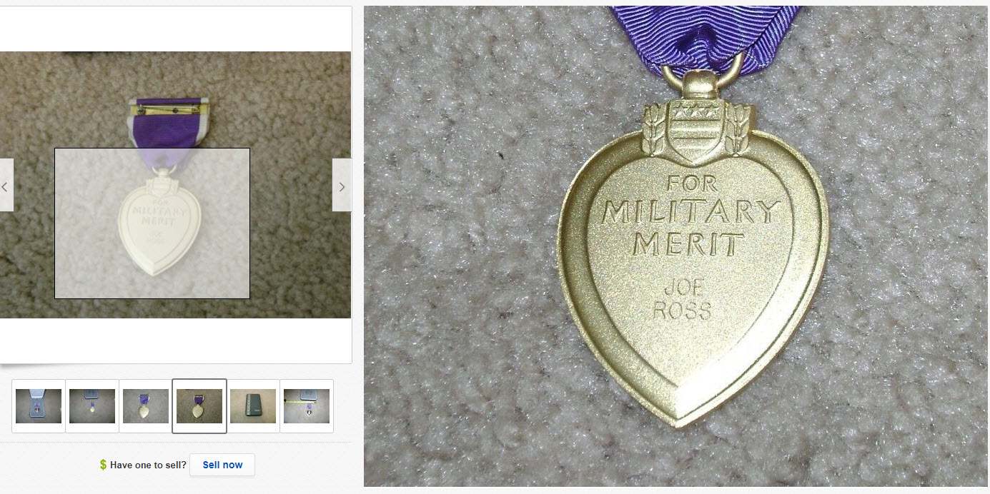

Dave Posted September 3, 2022 Author Share Posted September 3, 2022 Again, not WW2, but official government engraving on a new, replacement, award. Link to comment Share on other sites More sharing options...

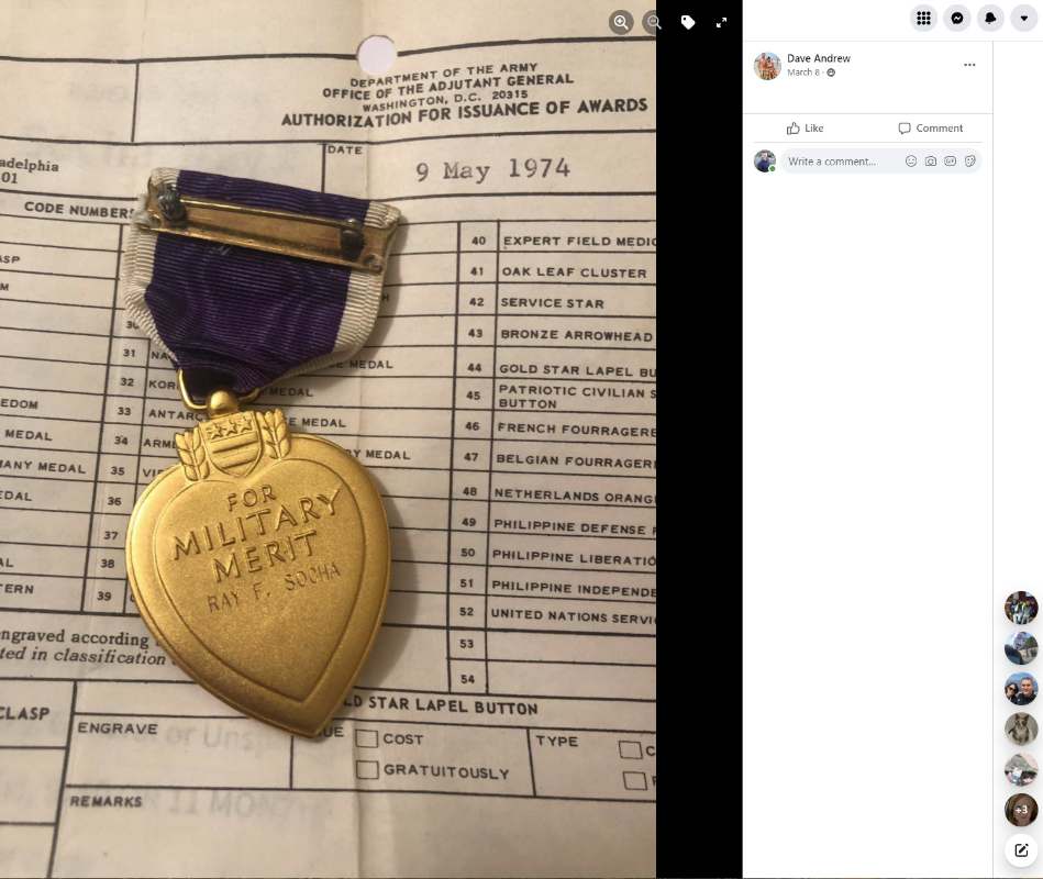

Dave Posted September 3, 2022 Author Share Posted September 3, 2022 I really like collecting images of awards with dated documents. This helps everyone in the community know what the government was engraving at an exact time period. Here's a Purple Heart dating from 1974. Link to comment Share on other sites More sharing options...

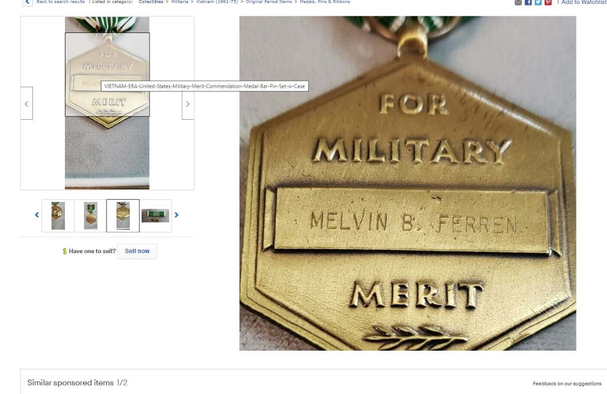

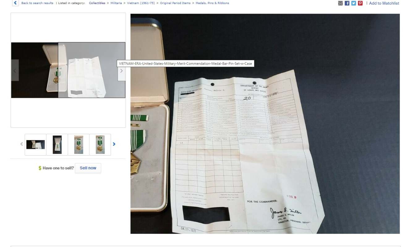

Dave Posted September 3, 2022 Author Share Posted September 3, 2022 Now, an ARCOM dating from 1979. It shows the government was still using pantographs with a diamond drag tip at the end of the 70s for engraving. Link to comment Share on other sites More sharing options...

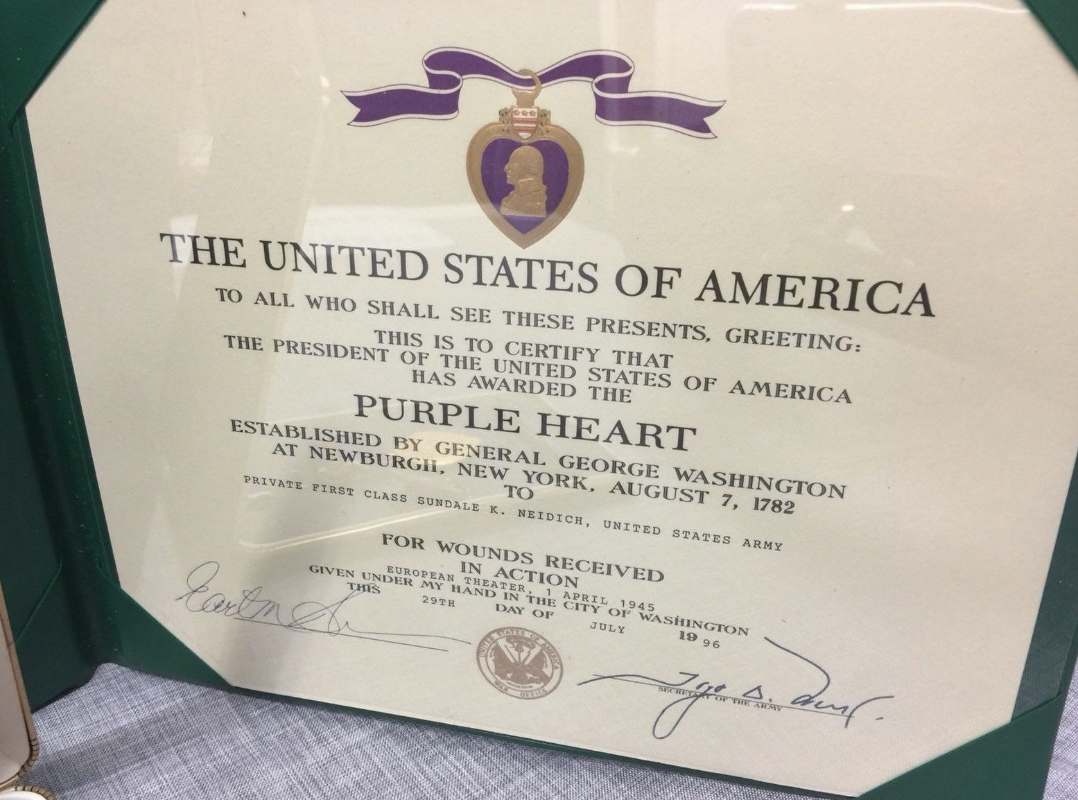

Dave Posted September 3, 2022 Author Share Posted September 3, 2022 Here's a replacement Purple Heart from 1996. Link to comment Share on other sites More sharing options...

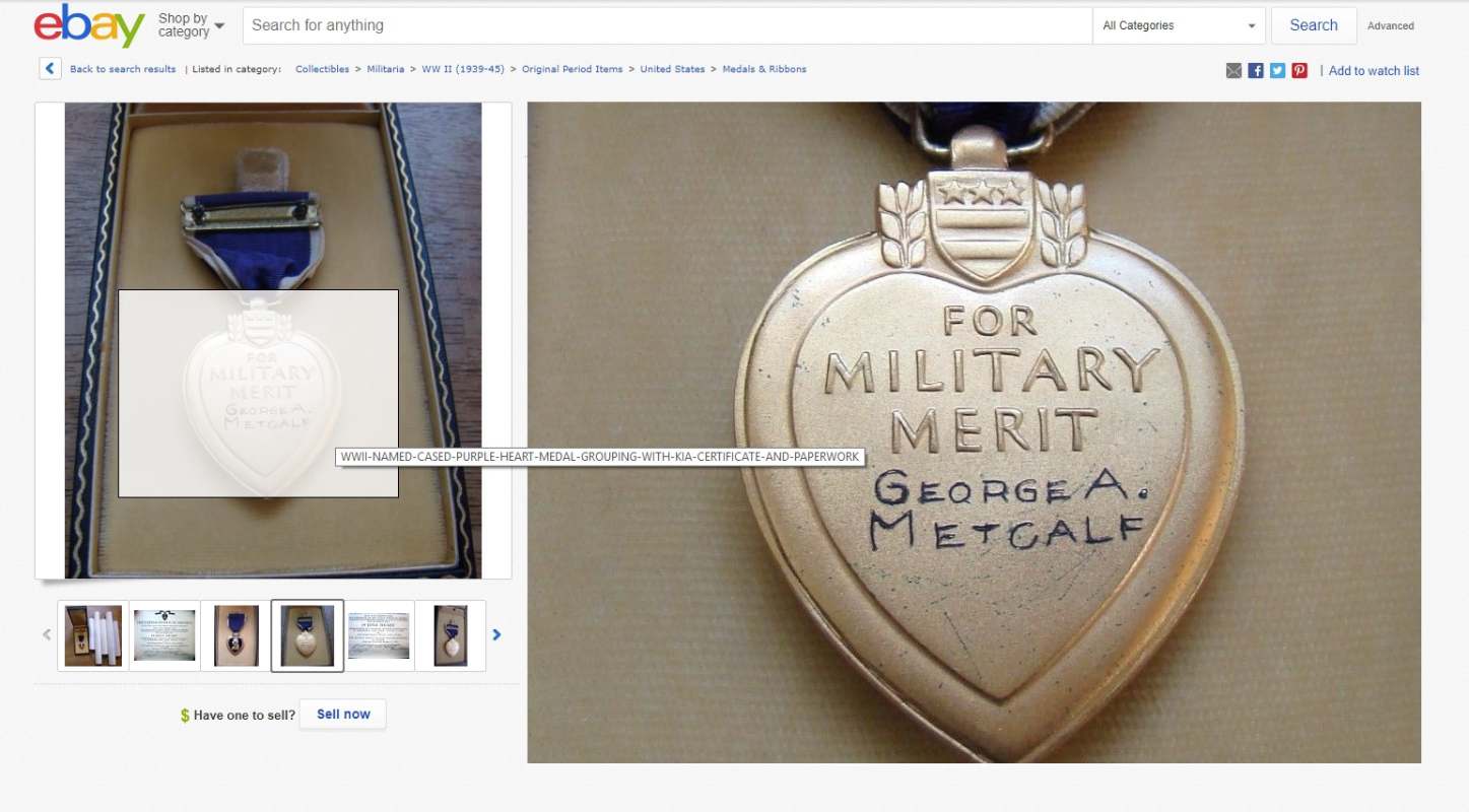

Dave Posted September 3, 2022 Author Share Posted September 3, 2022 Someone at some point was churning these fakes out left and right as can be seen by earlier ones in this thread. There are a LOT of these out there, and they're all fake. Link to comment Share on other sites More sharing options...
Dave Posted September 3, 2022 Author Share Posted September 3, 2022 Good golly...I had forgotten how many of these were out there! More bad engraving. Link to comment Share on other sites More sharing options...

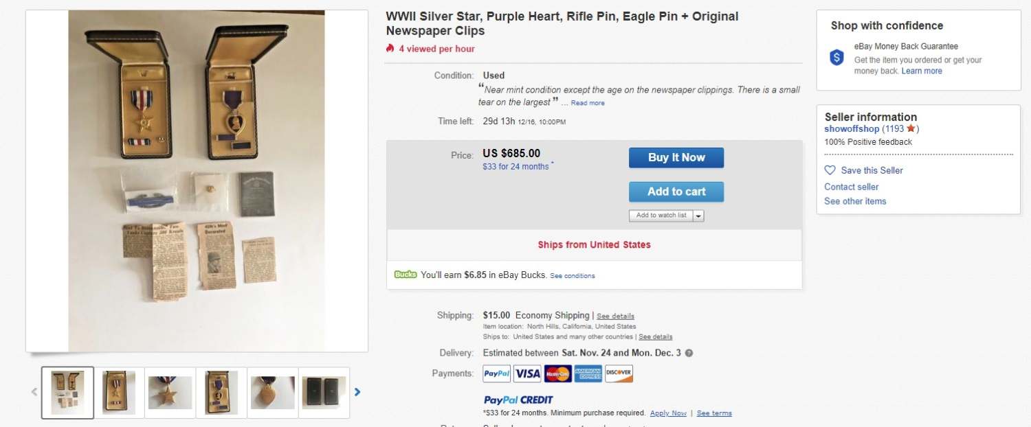

Dave Posted September 3, 2022 Author Share Posted September 3, 2022 This was a strange lot. The Silver Star was odd and the Purple Heart was most definitely a recent replacement. The group was being sold (IIRC) by the recipient's daughter, so it was just rather strange. Link to comment Share on other sites More sharing options...

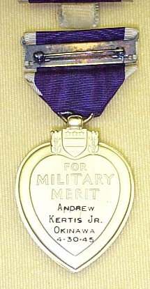

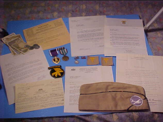

KASTAUFFER Posted September 3, 2022 Share Posted September 3, 2022 November 2005: Here's an interesting lot named to a Leonard J. McGee, a Captain in the 194th Glider Infantry Regiment, who was killed in action March 24, 1945. While the paperwork, cap, and patch look genuine, the Purple Heart is obviously privately engraved. Officially engraved Purple Hearts as issued to a serviceman's next of kin were never engraved with date or theatre of operations, as this one is. This lot closed for $610.00. Link to comment Share on other sites More sharing options...

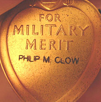

KASTAUFFER Posted September 3, 2022 Share Posted September 3, 2022 July 2005: Here's a Purple Heart that appeared for auction from a well known patch dealer. Philip M. Clow was a fighter pilot with the 51st Fighter Group, and the auction lot was sold with some original paperwork. Sadly, the medal itself is privately engraved. Since this is the first privately engraved medal that this particular seller has auctioned on eBay, I'll give him the benefit of the doubt and say he just doesn't recognize WWII engraving styles, This lot closed at $911. Link to comment Share on other sites More sharing options...

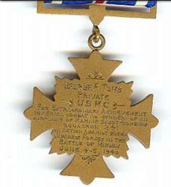

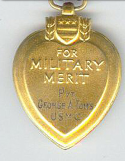

KASTAUFFER Posted September 3, 2022 Share Posted September 3, 2022 Here's a very famous fake medal group that originally surfaced in a well known medal dealer's catalog in the late 1980's. He received it on consignment and published it in his catalog. The lot was immediately withdrawn when the seller was contacted by the Toms family, who still had possession of the original medals, and the medals were returned to the consignor. This lot resurfaced in January 2005, being sold on eBay by a seller from Germany. The lot closed at $2864.00. ** This is a Frank Paulus group. The dealer that got burned by this was Al Gleim. Link to comment Share on other sites More sharing options...
