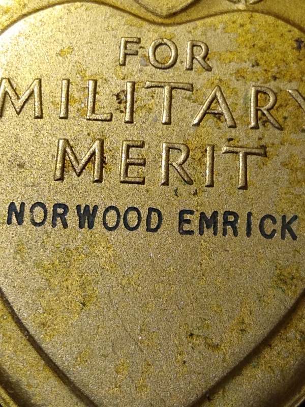

Hi,   I picked this one up today at the flea market.  For $40, there's gotta be something wrong with it, right?
So I got it home and looked him up on line, born in 1915 and died in 1995, and his grave marker shows he was a WW2 veteran, received a Purple Heart and was a POW. Also he is local to me so very excited about that.
Before I start doing more research, does the engraving look correct?
Thanks! Kim

Kim-
Nice pickup! The engraving almost looks like the not-so-great engraving that was used rarely during the Korean War. Or, it could be privately done. Either way, it looks good to me and I'd be happy with that purchase for sure.

Norwood Emrick was a WWII POW. The engraving on his PH actually looks like WWII official small machine engraving to me.
Kim, is it possible for you zoom in for a clear close up photograph of his name?  Curious to inspect the engraving details. Thanks!
The machine engraving on this piece should have a flat bottom with circular engraving swirls on the bottom easily visible under a loop .
Kastuffer and Mike, thanks for the replies!
Does this closer shot help?
Also a researcher replied to me in the Individual and Unit Research section with an article from the July 29, 1945 edition of the Dayton Journal Herald where Mr. Emrick talks about being a paratrooper, multiple jumps, captured in Belgium and then held on Jersey Island, one of the channel islands! But no unit! Makes me wonder how he found himself held there as a prisoner rather than on the mainland??
Not that it matters much but I did purchase this from a seller in Urbana, Ohio, about 20-ish miles from Dayton, Ohio, Mr. Emrick's hometown.

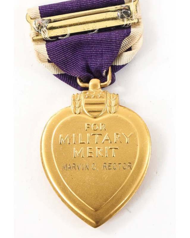

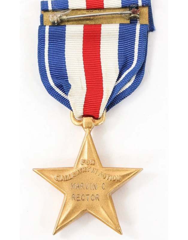

Hello, I am interested in this set of medals but I don't know if they are ww2 original. I have done some online research on the soldier. On FindaGrace it says he received the Purple Heart and Silver Star.
I wanted to get some opinions on the engravings.
Thanks

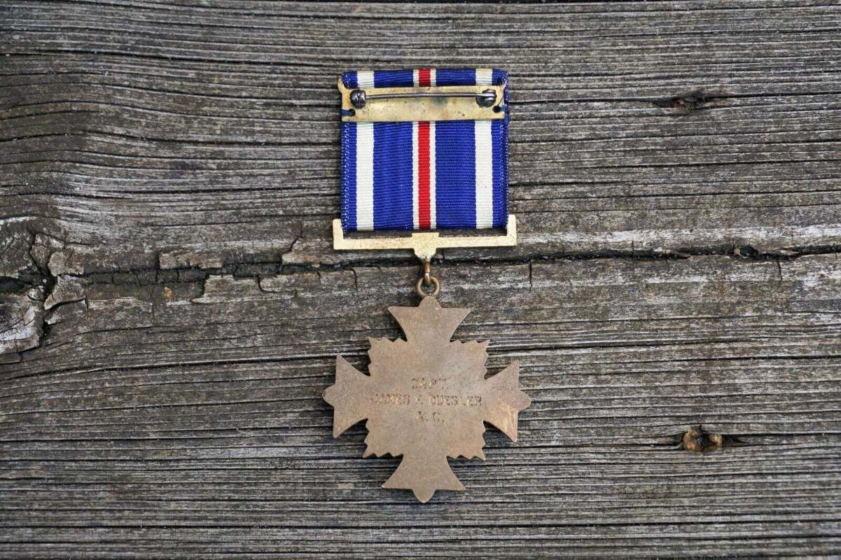

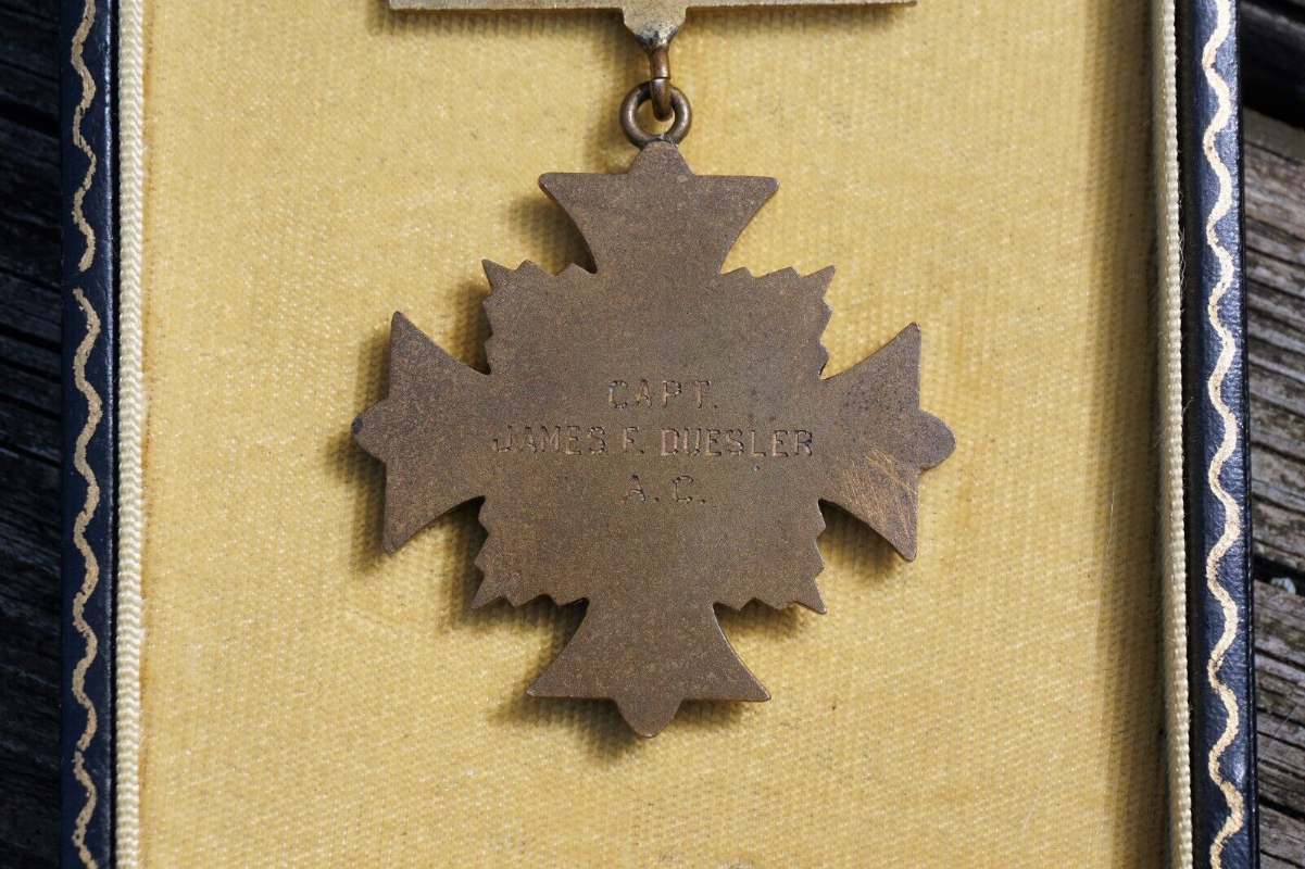

Hello. I recently saw this WWII Distinguished Flying Cross online and am wondering if the engraving is official. The engraving seems to be handmade but has blocky letters instead of the smoother ones found on other examples on the forum. The medal also seems to be much darker than the hanger, is this normal?
The DFC would have been engraved in the 1945-46 time frame and looks OK to me.

The engraving on these is not from WWII . Re-issues at best,
This is the auction desc:
WWII US ARMY NAMED SILVER STAR & PURPLE HEART
WWII US Army Named & Numbered Silver Star, Named Purple Heart, and Campaign Medals. Named to Marvin C. Rector. (1) Name Engraved & Serial Numbered Silver Star. "Marvin C. Rector" is engraved on the back and stamped "79915". (1) Name Engraved Purple Heart. "Marvin C. Rector" is engraved on the back. No number. (5) Good Conduct & Campaign Medals. - The II Corps began attacks across the Rapido River toward Monte Cassino on January 20, 1944. This action resulted in heavy casualties, and is considered to be one of the toughest battles in the Italian Campaign. Technician 5th Grade Marvin C. Rector, 19th Engineer Battalion was awarded the Silver Star by General Orders #29, Headquarters 11 Corps, for action at the Rapido River, his citation dated April 24, 1944, stating: For gallantry in action on ** and ** January, 1944, in the vicinity of ****, Italy. While his company was engaged in support of a forced crossing of the **** River, Corporal Rector voluntarily participated in an extremely hazardous mission of clearing a path through an antipersonnel minefield. During daylight, and under small arms and mortar fire, he aided in successfully clearing and marking a vitally necessary path to the river, in order that an attack could take place as planned. Again, on the evening of ** January, on the trail through the minefield, once more under fire, he found a soldier seriously wounded by a mine explosion. Voluntarily entering the minefield to obtain a stretcher lying there, he aided in evacuating the wounded man. The conduct of Corporal Rector during this action is deserving of the highest praise, and reflects credit upon himself, his unit, and the Armed Forces.
That's interesting to know. Thanks Kurt!

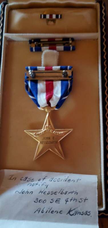

Hello. I came across this WWII Silver Star being offered for sale recently. Is this engraving official? Most of the silver star engraving photos I found on the forum seem to have the name engraved with a slant.

More knowledgeable folks are on this forum; however, it is hand engraved in a similar style to WWII PHs between 44 and 46. I want to say that the slant style of engraving on Silver Stars came out later in 46 or 47 when the Bronze Stars had the slanted style and were often issued for CIB or CMB that were authorized in 1947. Again, it is a SWAG on my part, but I would not mind purchasing it if the price was okay.

Ahh. Didn't know the slant style actually came out later. Good to know. Thanks John!
Guest Jetlady
These medals are original.  They were my fathers and I have been trying for over 50 years to get them back.  He lost them in an unfortunate circumstance.  My brother has reissues and they do not have serial numbers on them.  If anyone knows who bought these I wish to purchase them back.  PLEASE
Jetlady...
You should try messaging Snafu44 to see if he bought these two medals.
If you notice KASTAUFFER's comments, he mentions the engraving on these medals dates them to well after WW II....likely into the late 1960's to 1970's.  The "pin" on the Silver Star is also from this same era.
That said, your father or a family member probably received these in the 1960's to 1970's.  So they were "his", but not the ones he was originally given during or right after WW II.  This effects the value to collectors, but not to you, because these replacements are likely the medals you remember your father had.
This is important, because we would like to see you get these back, but not have to pay too much for them.
