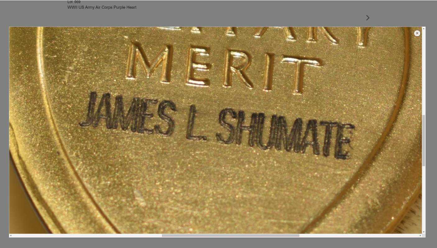

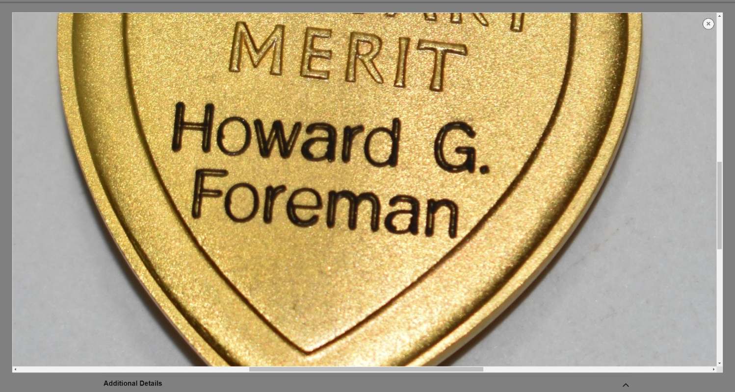

I'll get this kicked off with some of the bad engraving I've seen over time.

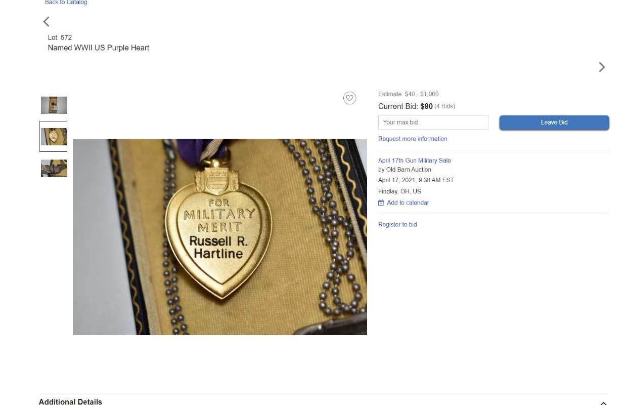

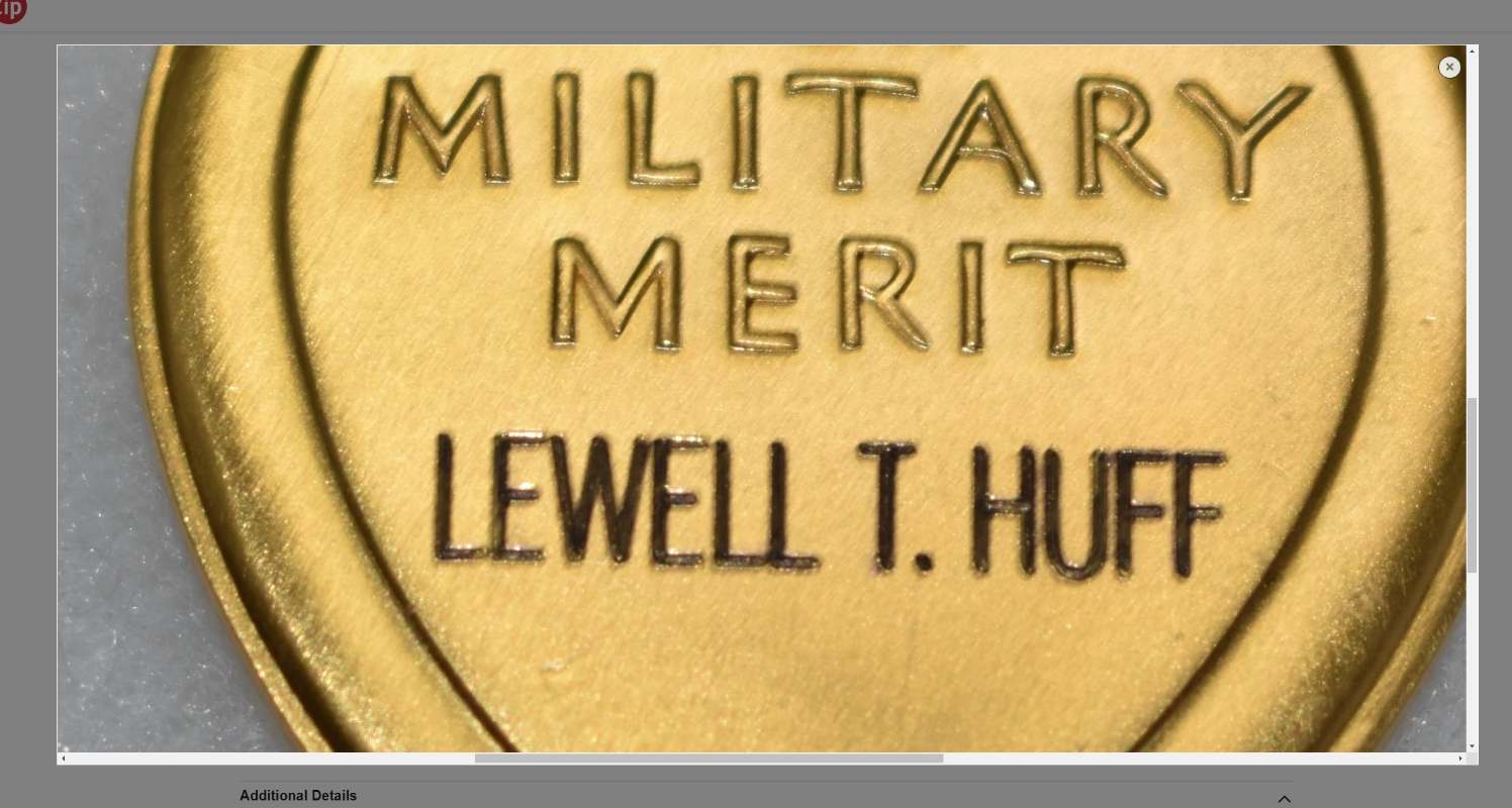

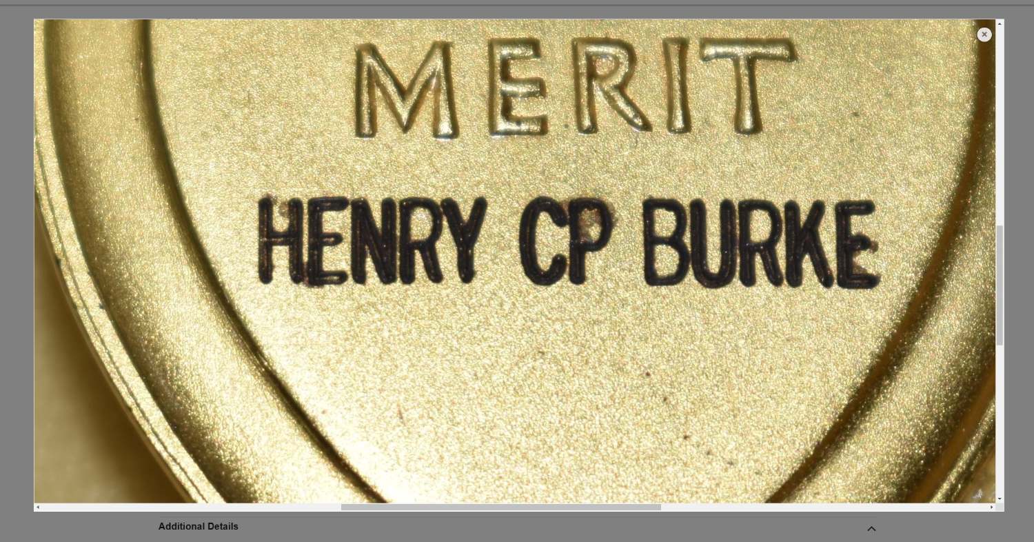

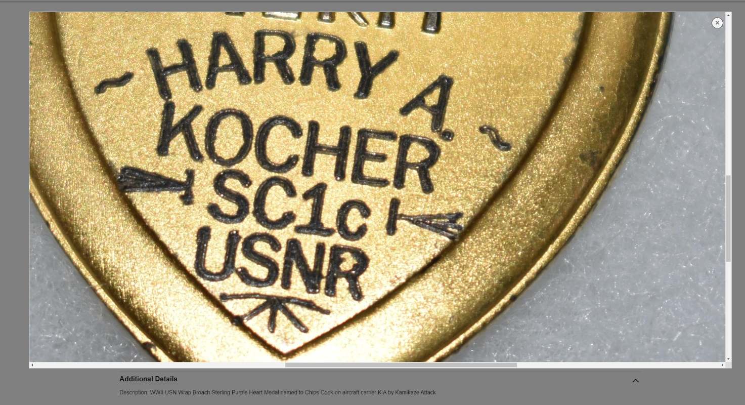

These medals were all offered in an auction in Ohio twice. They were sold and have since resurfaced in multiple locations. I consider these the "Ohio Auction" medals. These medals are engraved to James L. Shumate, Harry A. Kocher, Russell R. Hartline, Henry CP Burke, Leon A. Vaughn, Lewell T. Huff, William D. Lower, Howard G. Foreman, and Harold E. Frederickson.

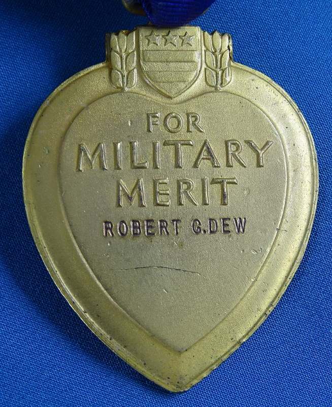

One of the few bad engravings found on a engraved WWII Bronze Star and Purple Heart to a 82nd Airborne Division KIA.
Robert G. Dew, the engraving on the Purple Heart has been confirmed as being a bad one. Not sure on the Bronze Star.

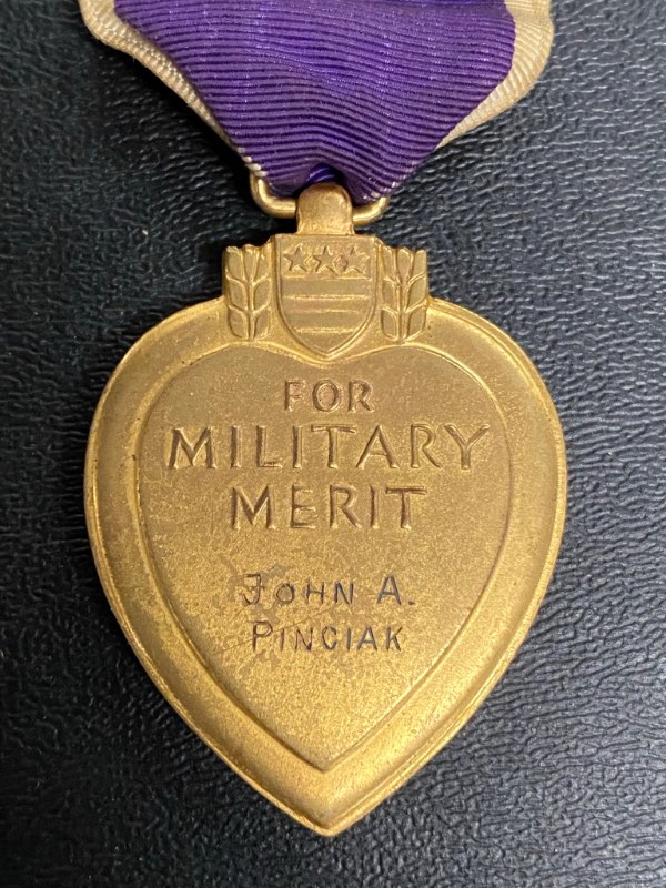

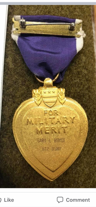

The three Purple Hearts about with the weird “J” were allegedly WWII KIA. You won’t find this type of “J” on a real wwii KIA. Also the engraving lines are too thin

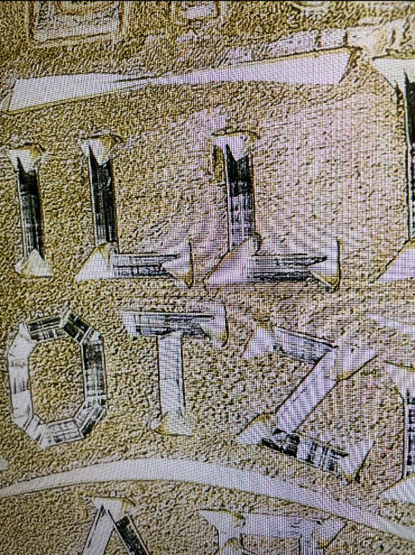

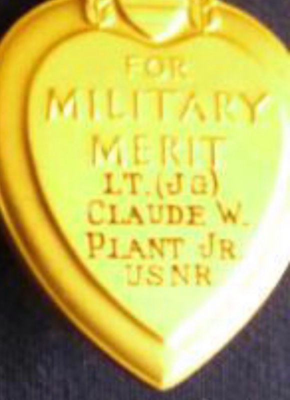

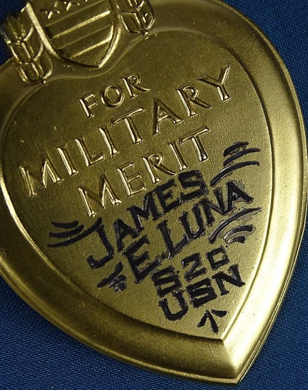

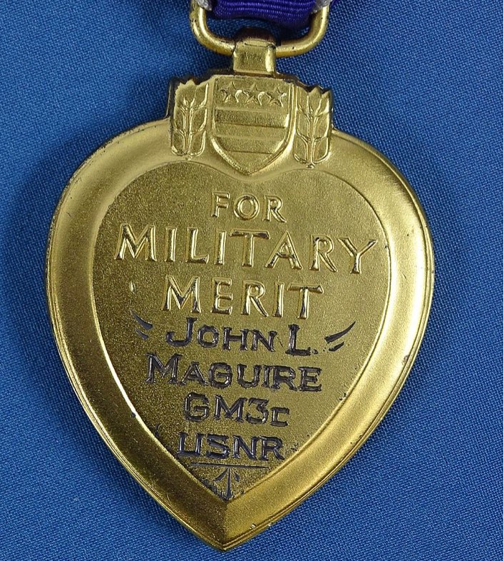

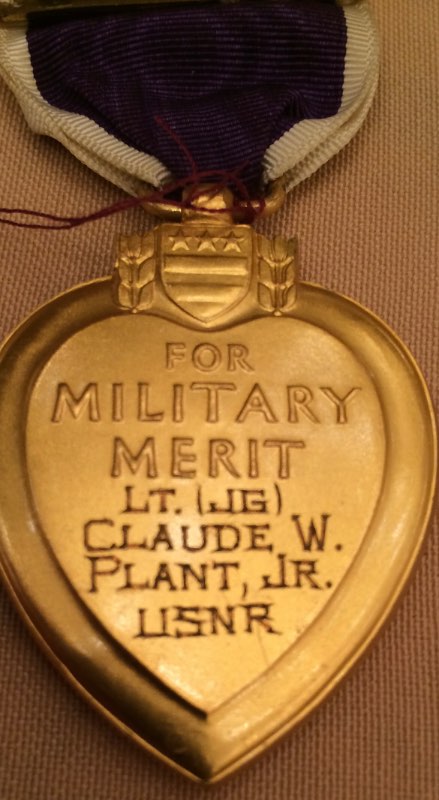

On WWII Type 1 and 2 Navy Purple Hearts you should see cuts like the ones that are illustrated in this photo. Also note how blocky the engraving tool is on the letter O.
If you don’t see these cuts then I would question the engraving.

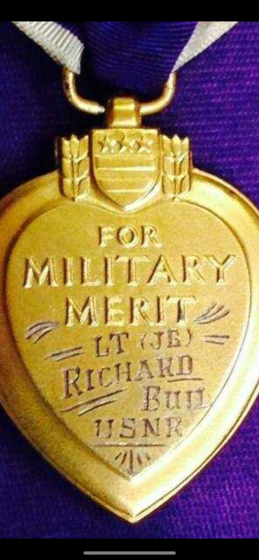

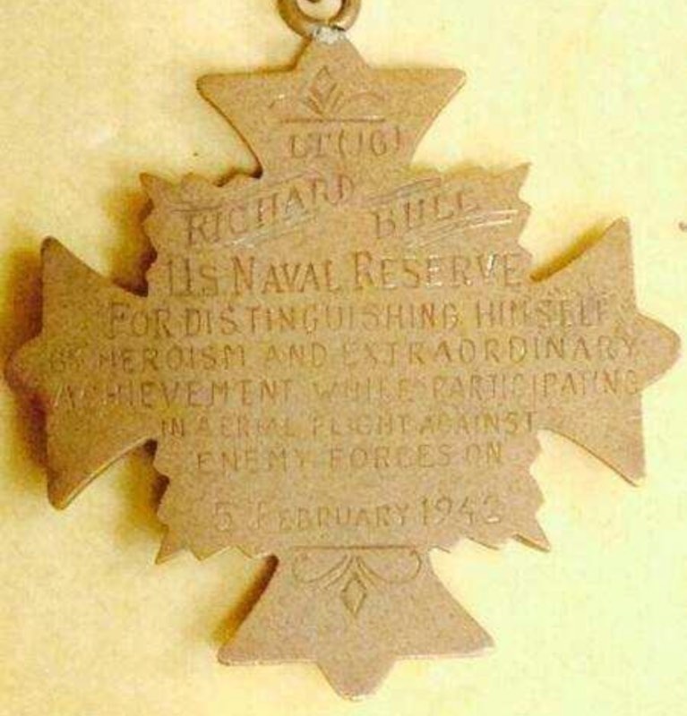

Someone who remembers the story about Frank ? who was a master engraver and produced some very good fakes.  I assume that's who did your Bull DFC.  Expounding on that DFC could save some readers a boat load of money.  And thanks Pete-o MSU for posting!
BTW, I remember a very good thread years past with some of his work on the Forum.
Like I said above you need to look closely at the construction of the letters. Trying to illustrate the differences with this side by side. One isn’t like the others. Look at the “O”
Again look at the engraving cuts

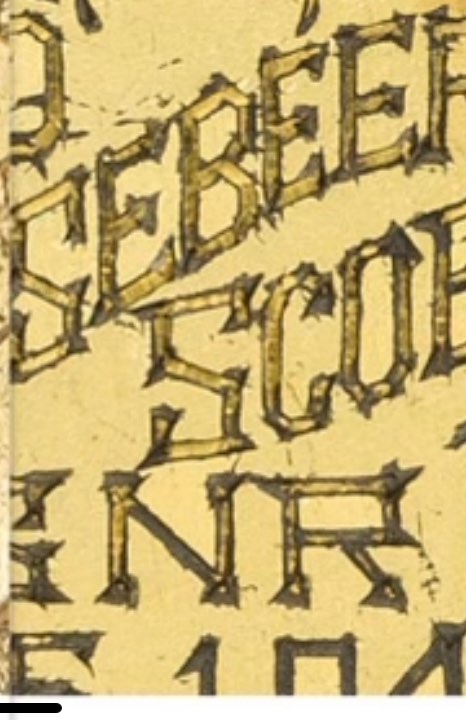

from the forum tigerfan aka Roger has an amazing documented silver star group (Scobell) vs this new silver star

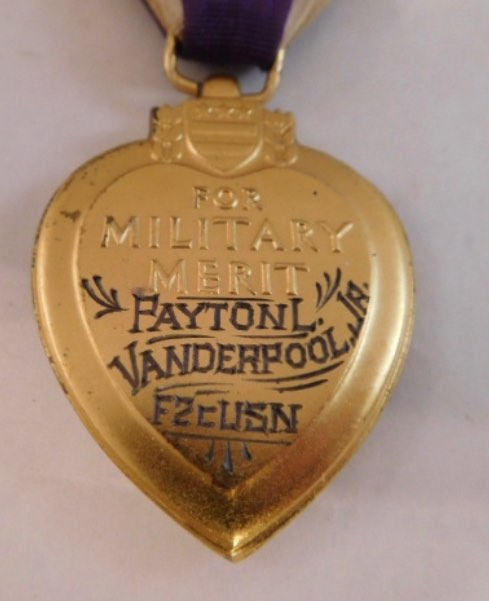

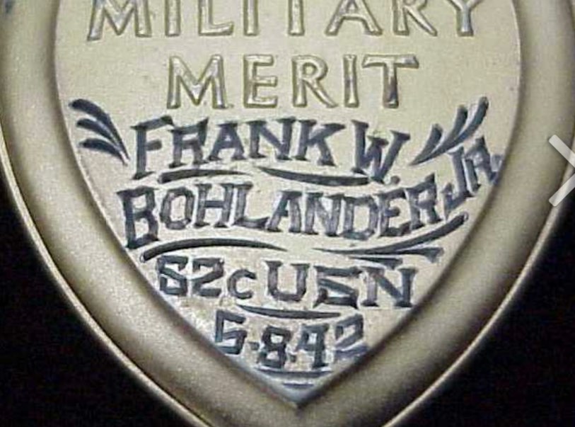

Again compare the first three vs Vanderpool, Harrison, and Dawn. Feel free to compare against any Pearl Purple Heart. I think they need to be discussed further.
I also want to say I am not trying to single anyone out as these are good fakes and could fool any of us including me. And I now believe one group might have. I am trying to help educate and start a conversation. Dan is a victim also.

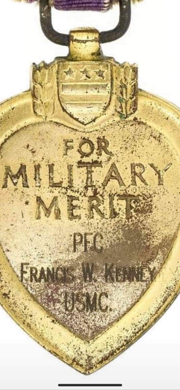

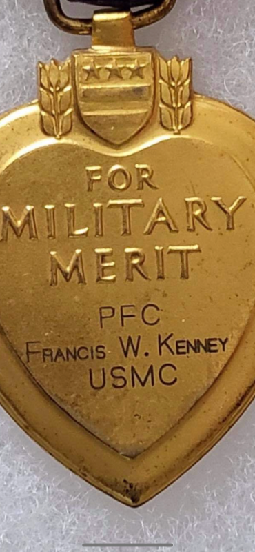

Here is a real medal and a fake to the same vet.
The real one is the first one .

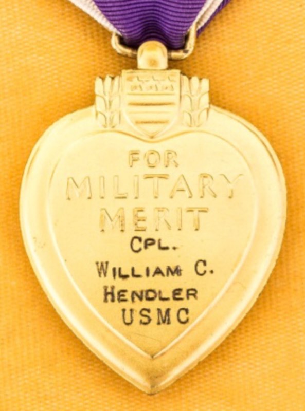

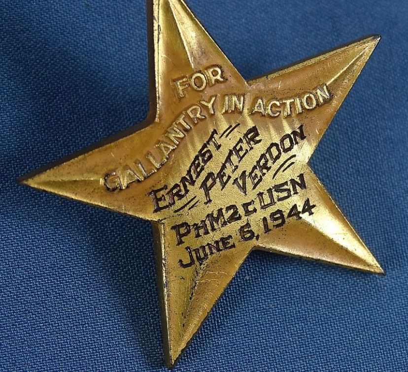

Here are a few more fakes that I happened to find in my photo library.  Many of these are the work of Frank Paulus. He was an early faker of medals  back in the 1980s.
The USMC PHs and Vietnam Navy PH are someone elses "work"
This is believed to be the work of Frank Paulus. This was last sold at a show of shows a few years ago with the fake Purple Heart.
Dave describes this one later on in the thread. It’s engraved on a fake Chinese made planchette.
unsure who to attribute this work too.

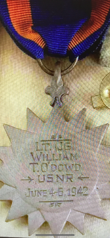

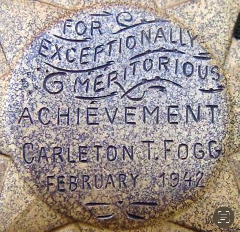

I think this is a great topic and resource. I have spent some time reviewing Dave’s book and many of the known engraving styles posted through the forum, I’m no expert like Dave and Kurt. While there will always be obvious fakes I’ve noticed there can be quite the variation in the Type 1 Navy medals as stated above. I think we need to remember and take in consideration that just because a medal might not have a particular feature doesn’t necessarily mean it’s bad and this is mainly in reference to early navy engraving  These were done by human hand no two might be exactly alike plus consideration must be given to the experience of the engraver, I can’t imagine all were professionals on day one on the job. As well as wear on the engraving tool over time. Unfortunately the same could be said for anyone attempting to fake any medal engraving and I imagine the more information that’s out there the better the fakes will get.

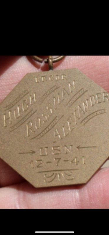

This is one that I have had for 20+ years that I bought directly from the great niece - He was a KIA on the USS Pringle when it was hit by a Kamakazie.
I plan to take it to Nashville in November
Bill
