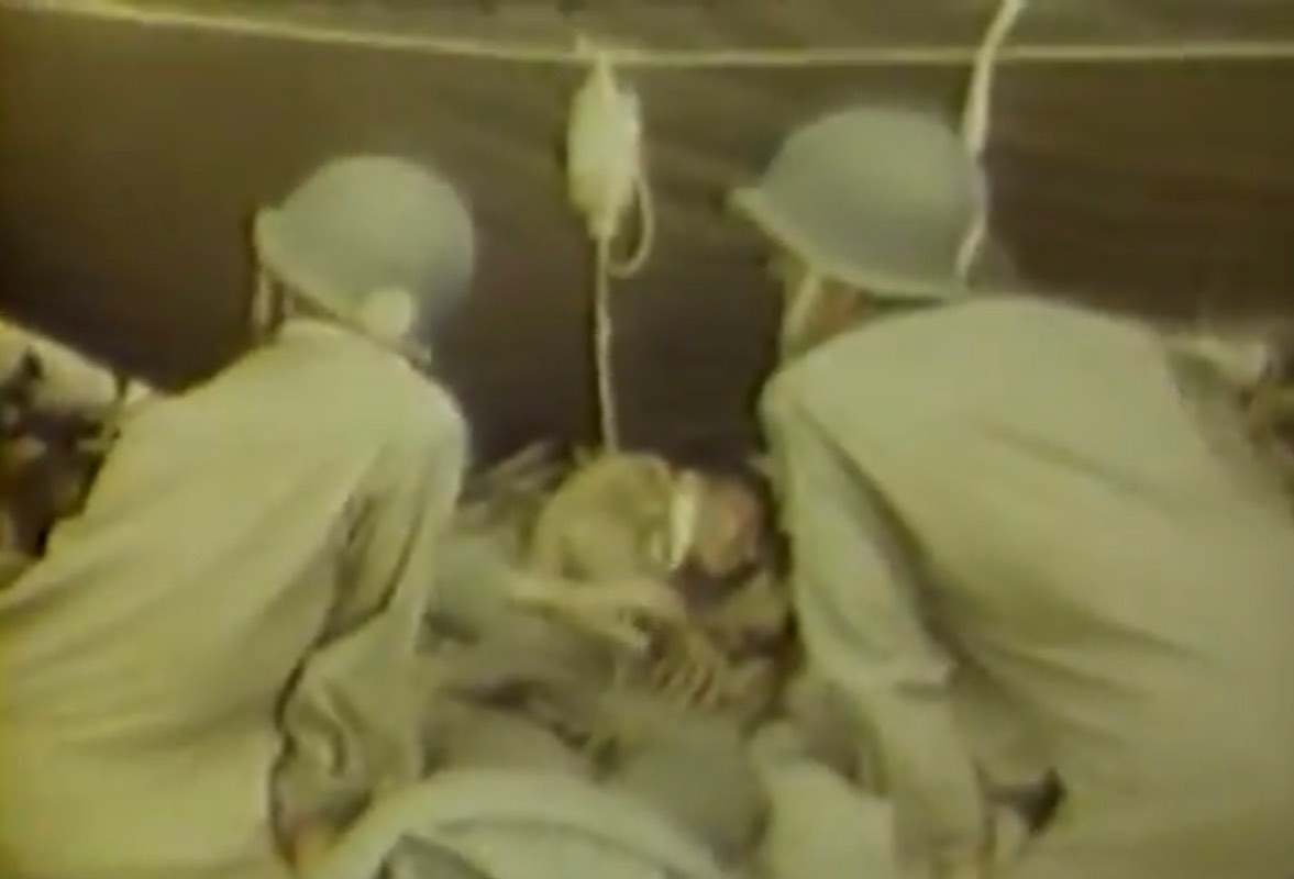

JerryTheGerman Posted August 30, 2022 #1 Posted August 30, 2022 Hey there y’all, this has been something I’ve been meaning to post for a while now. I’ve been looking at corpsman with the dots on their helmets for a while now and have come to the conclusion they were not white but in fact yellow. Here’s the evidence I have so far: 1. USN regulations for the circles do not mention “white dots” but yellow ones 2. In all footage I’ve seen of these in use the color has been yellow such as on Tarawa and Eniwetok 3. All “white dot” examples I have seen have either an army rank or serial number. 4. Most photos of the navy dot have either initials or small rank inside of them. I believe this misconception may have happened due to most of the photos of these helmets were in black and white and not color making it look as though the yellow and white colors were the same. Also the footage of them on Tarawa is over saturated due to the pacific heat which makes the helmets look more white and not yellow but you can clearly see a difference in color of the white bandages and the color of the dots. Also an example by General Cheese shows these being used late war on the back of a helmet. Just a reminder these were used by beach battalion corpsman and not sailors attached directly to marines.

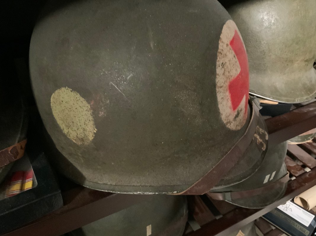

JerryTheGerman Posted September 5, 2022 Author #4 Posted September 5, 2022 Here’s an example of a helmet that fell perfectly under regulations for beach battalion personnel. It sold on eBay a while back but I’m not sure if anyone on the forum got it.

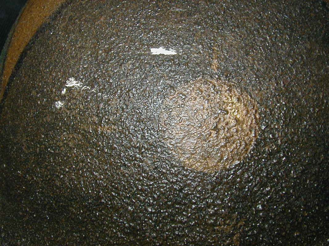

suwanneetrader Posted September 7, 2022 #5 Posted September 7, 2022 I"ve had this along time and posted before getting little info. Maybe this is a better discussion to post in. If some of you know what a yellow circle meant in WWII how about WWI? I'm hoping. Also disregard what I paid and retail its in title for my kids. 🤪 Richard

suwanneetrader Posted September 13, 2022 #7 Posted September 13, 2022 Still looking for someone knowledgeable on this helmet. Richard
JerryTheGerman Posted September 13, 2022 Author #9 Posted September 13, 2022 38 minutes ago, suwanneetrader said: Still looking for someone knowledgeable on this helmet. Richard Can’t say for sure what it could be? Possibly communication or HQ? Who knows? I don’t believe in WW1 they would be having the same problems with medics faced to the PTO
