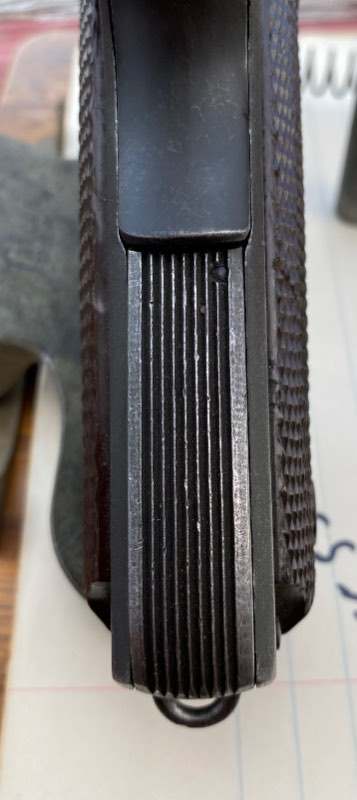

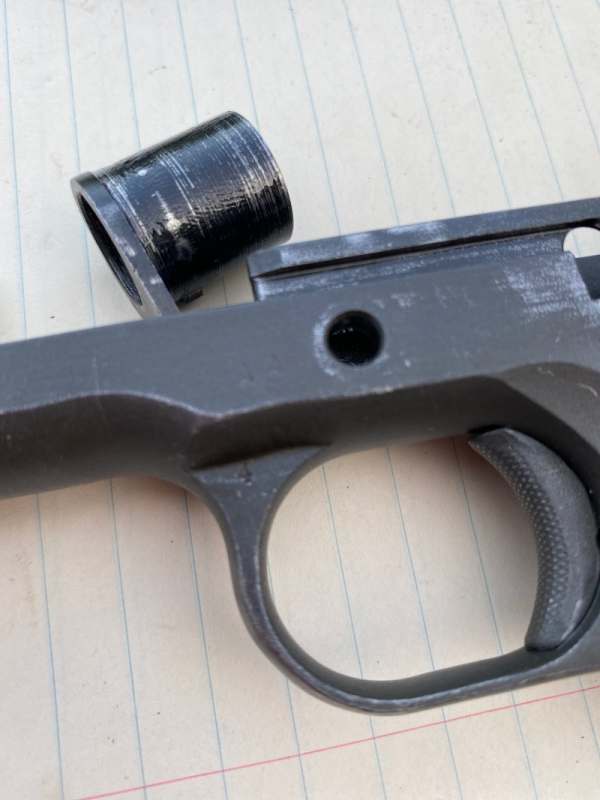

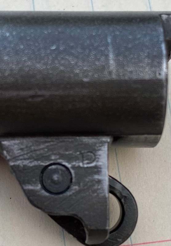

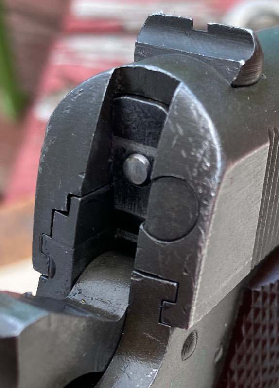

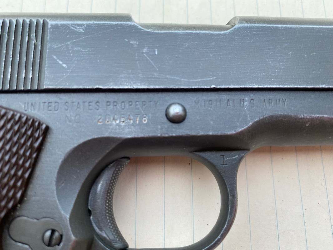

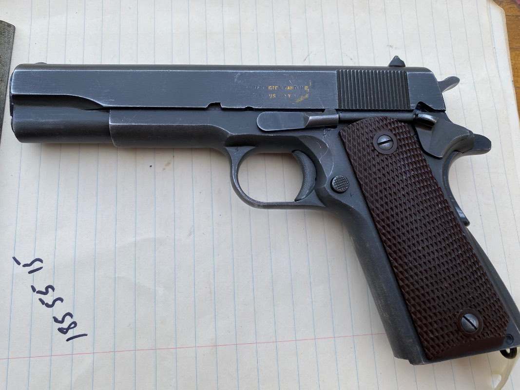

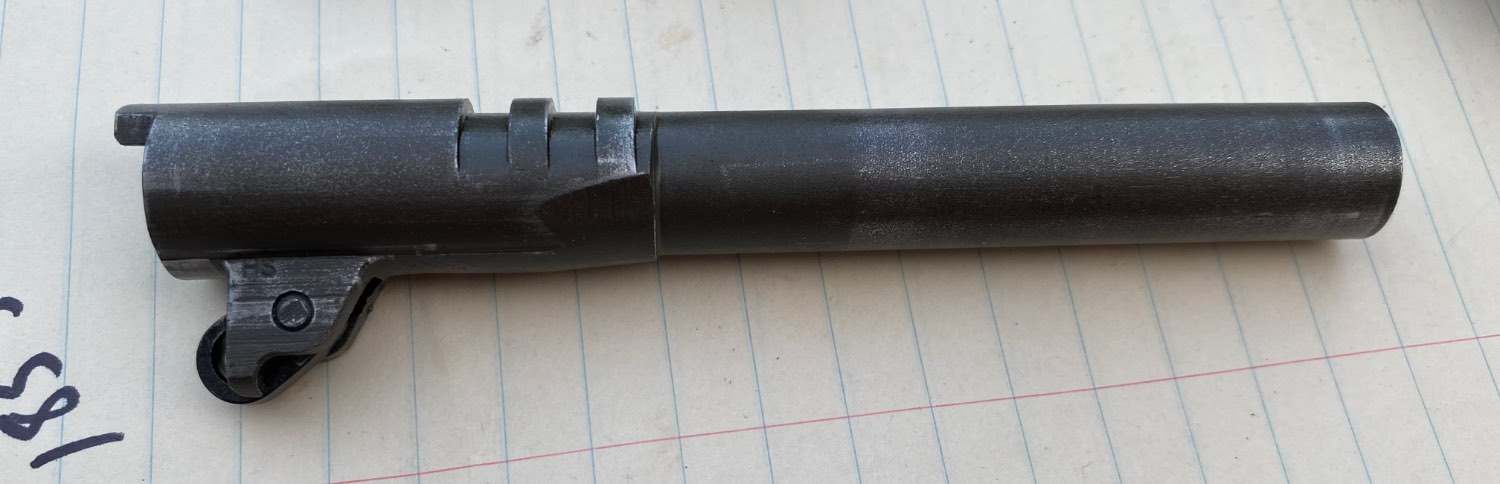

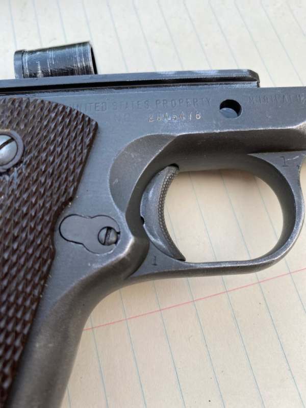

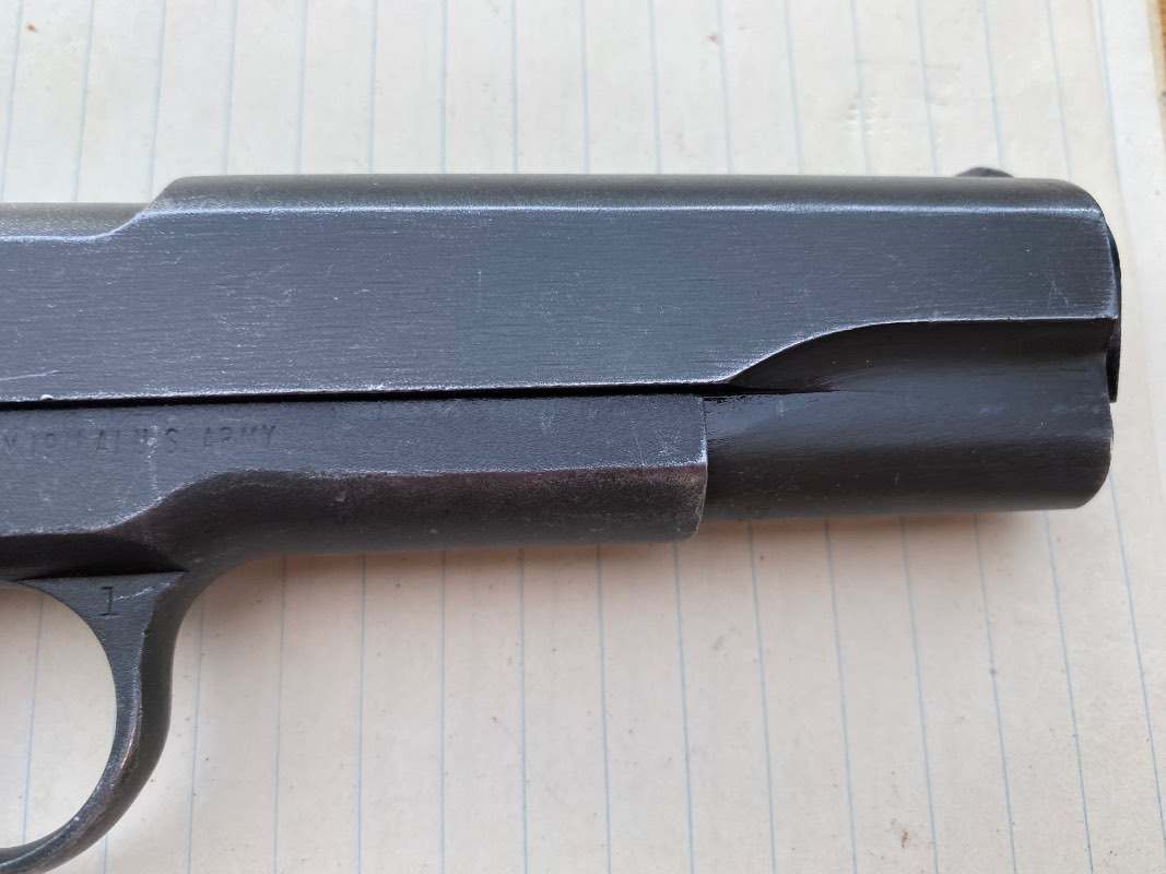

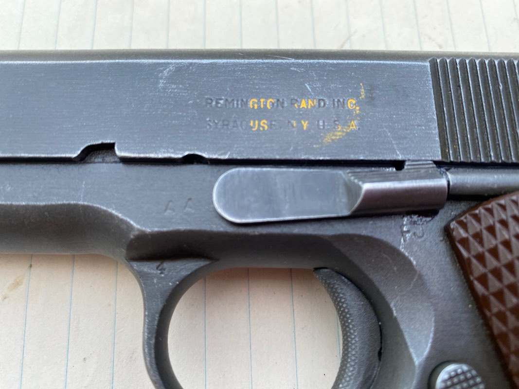

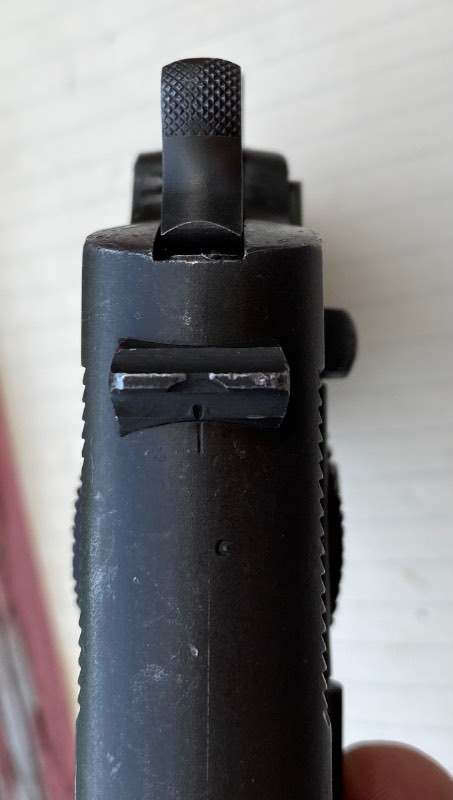

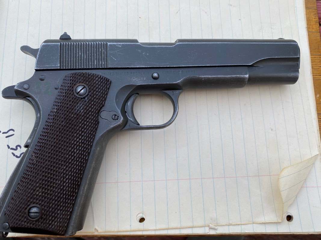

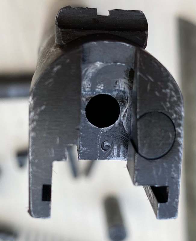

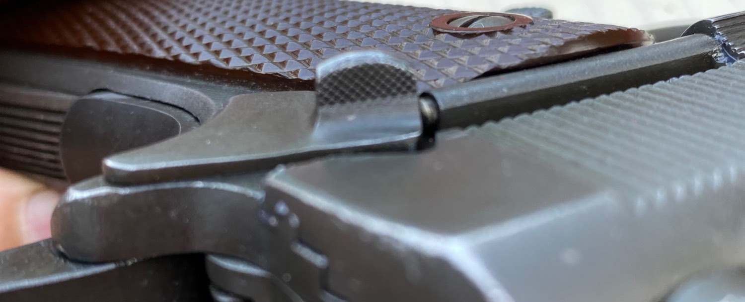

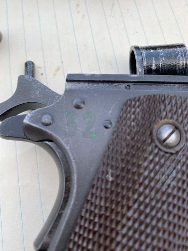

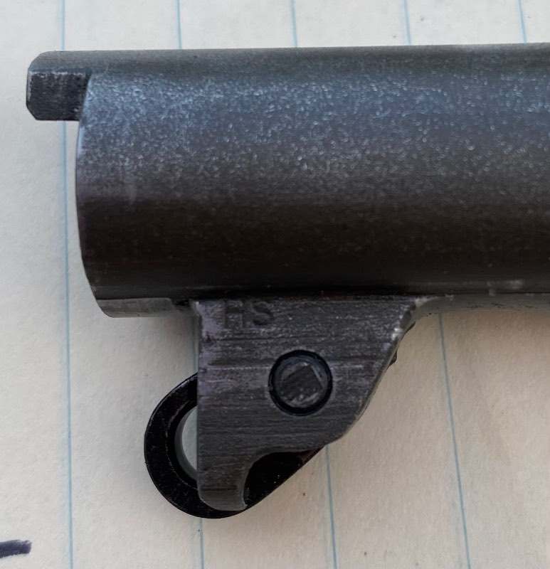

Pics… for your review … and opinions on the small parts
has the correct HS barrel (?)
Remnants of a rack number in yellow on the left side and a green rack number on the right
some wear on the rear of the slide
And the rookie scratch.. patina..

That is a really solid example of a Type-III Remington Rand / Augusta Arsenal rebuild.
That mark under the firing pin stop is actually a letter “G”, which is fine.
All of the small parts look right for this 1945-manufactured example.  Narrow spur hammer, 8-rib Mainspring Housing, short stamped trigger, correct barrel, etc.
Only SOOOOOPER-nit-picky thing, which is the easiest to remedy, is the mis-matched grip panels.  The right panel looks like a Keyes Fiber one, which would be correct for this beauty (you can confirm this by shining a light in the magazine well, after ensuring that the weapon is unloaded, clear, and safe, and looking at the back-side of the panel.  It should have crossed reinforcing ribs, with a star with a “K inside of it, and a mold number near it).
The left panel has wide reinforcing rings, which were not used on RRs.
I am impressed at how nice it is.  Congrats.
