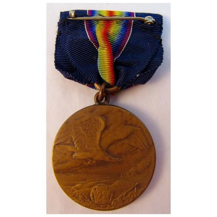

The United States officially entered The World War (World War 1) on April 6, 1917. For the period of April 6 through August 5, 1917 who entered Federal Service while members of the Pennsylvania National Guard received the first medal pictured. After August 5, 1917  they received the second medal pictured. The second medal had the inscription around the edge changed from Pennsylvania Federal Service to Pennsylvania National Guard and on the front the shield center was changed from a star to the letters PNG and on the back the shield center was changed from the letters US to the number 28.                                                            1.thumb.jpg.286d7e0e923bad8c02c2fa370f926a93.jpg.df3758be2beaa980bc2212f39e41ef79.jpg

Anyone who entered service between 4/6/1917 and 8/5/1917, received the "Pennsylvania Federal Service/US" medal (if requested).  Anyone who entered service from 8/5/1917 to the end of the war, received the "Pennsylvania National Guard/28" medal (if requested) - even if they weren't in the National Guard or the 28th div?
