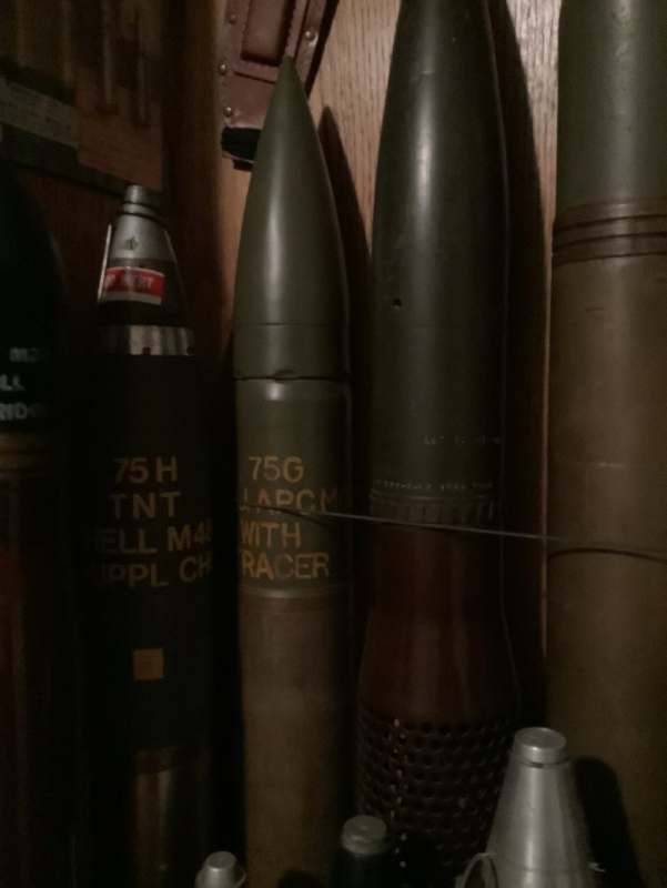

The color would be black with white lettering if the cavity was empty (not loaded with HE). If the cavity was loaded with HE, it would be OD green with yellow lettering. After a few months in the field, it was found the HE filled projectiles did not penetrate armor as well as the HE empty projectiles did and the HE filling was discontinued.
Picture shows an example of an HE APC M61 on ET.

Thank you both for the info!  Much appreciated.
