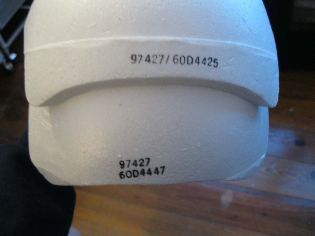

AMT500E Posted October 1, 2021 Share #9 Posted October 1, 2021 The 1 piece styro liner for the HGU-26p era of helmets will be the easiest to find, either by online auction of direct from one of a couple of places here in the US. If sold correctly it should include the Ensolite rubber brow pad (top in the photos) that glues in after the liner is installed (see photos) Guessing (by the spring loaded earcups) your helmet is/was an HGU 2Ap at origin. If/when you get a liner, be very careful what you choose to use, to attach it to the shell with. Most glues will melt the styrofoam and ruin the instal. You helmet looks like it might be a large size and will need a large liner. The photos are the latest and last 1 piece liner(s) for the HGU-22 sub assembly., medium on the left and the large one on the right. HGU-22 was the last issue of type, supplied as a basic stripped shell from which the desired helmet configuration (T.O.) could be built (single visor, dual visor, etc.) and is identical to previous HGU basic physical designs. Link to comment Share on other sites More sharing options...
AMT500E Posted October 1, 2021 Share #10 Posted October 1, 2021 Previous post HGU-22 was the last issue of type, supplied as a basic stripped shell from which the desired helmet configuration (T.O.) could be built (single visor, dual visor, etc.) and is > "identical to previous HGU basic physical designs." To clarify Identical in all aspects except the 22p did not include the 3 hole feature in the crown of the previous issued, HGU shell. Link to comment Share on other sites More sharing options...
Alamo Posted October 1, 2021 Author Share #11 Posted October 1, 2021 Thanks for the replies......I have a one piece liner i bought but my question is : Obviously this liner won't just pop into the shell so can i cut this liner right down the middle in 2 pieces and install one piece at a time into shell?........Installation is my question. Link to comment Share on other sites More sharing options...
72psb Posted October 1, 2021 Share #12 Posted October 1, 2021 It should just roll into the shell without to much trouble. They do not cut them up in the factory or the field to get them in. This stuff is not rocket science. Don't over think it, should go together just fine. Link to comment Share on other sites More sharing options...
Alamo Posted October 1, 2021 Author Share #13 Posted October 1, 2021 It's just that i've seen these liners for sale in one piece or 2 pieces and thought that might be the way it is....And where i got it from told me i might have to cut it....These parts are hard to find and expensive so i wanted to ask experts...I don't want to screw 'em up, i'm not buying them again..Thanks for the advice. Link to comment Share on other sites More sharing options...
mohawkALSE Posted October 2, 2021 Share #14 Posted October 2, 2021 4 hours ago, Alamo said: It's just that i've seen these liners for sale in one piece or 2 pieces and thought that might be the way it is....And where i got it from told me i might have to cut it....These parts are hard to find and expensive so i wanted to ask experts...I don't want to screw 'em up, i'm not buying them again..Thanks for the advice. Def dont cut it, they do just sorta slide or roll in from the front or rear of the shell. Might have to pull the shell apart with your hands a little from the side like donning a helmet. There were various impact liners for the various APH and HGU series helmets. Earlier ones were 2 or 3 piece designs, not cut and then later liners were mostly 1 piece. Depends on what model helmet it was and how many piece it was. Link to comment Share on other sites More sharing options...
Alamo Posted October 2, 2021 Author Share #15 Posted October 2, 2021 I'm not cutting it now that i know, thanks for the info..It really helps. Link to comment Share on other sites More sharing options...
