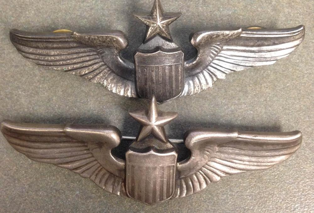

pfrost Posted September 4, 2018 #51 Posted September 4, 2018 Here are the two versions of the senior pilot. It is interesting but the "earlier" pin back versions seem to show a great deal of die wear, whilst the "later" clutch back version has more detail. This suggests to me that Josten made new dies at some point. There are some minor and subtle variations, like the stippling on the area under the star.

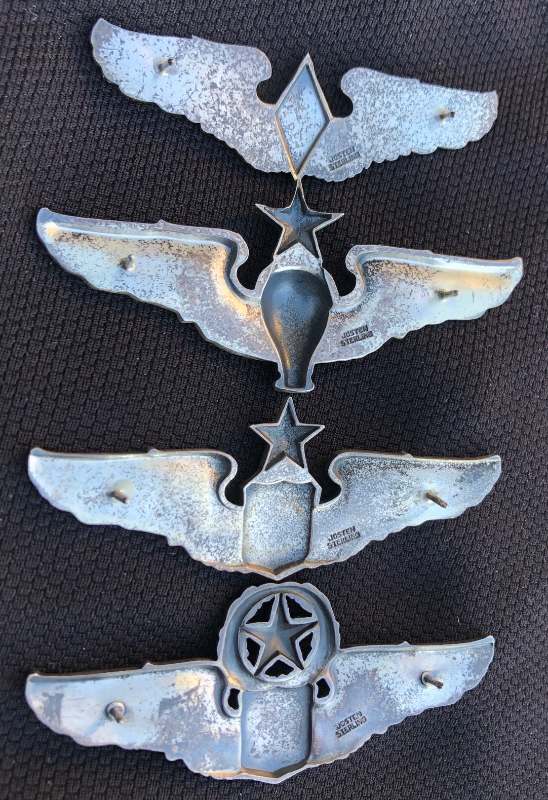

pfrost Posted September 4, 2018 #52 Posted September 4, 2018 The hallmarks. The senior pilot is interesting. A number of years ago, someone one in Florida (IIRC) was selling them in droves. He clearly had a NOS cache of these wings and for a couple or 3 years, you could have bought as many Josten senior pilots as you wanted (all for about 125$, with each wing in a small wax paper envelope). All those wings were clutch back and had the mark on the side. The s/p wings in pin back was much more scarce. In fact, my general impression has always been that outside of the super rare sets of WASP and Ballloon wings, the rarity of Josten could be ranked as the following from rarest to most common. Most rare: Observer Rare: Pilot (pin back) Rare: S/P (pin back Most common: S/P (clutch back) Most common: C/P (clutch back)
pfrost Posted September 4, 2018 #53 Posted September 4, 2018 When you put the 4 wings together, you can see that the clutch back command pilot and senior pilot wings have the same detail and finish. There may be a WWII command pilot version (Russ would probably have one), but if there is, I have either forgotten or haven't seen one. Josten are really nice wings with some interesting variations and overlap in the (probably) WWII wings versus the (probably post KW wings).

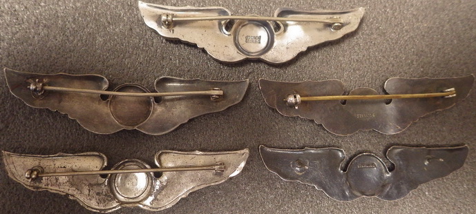

5thwingmarty Posted June 28, 2019 #59 Posted June 28, 2019 And here are the backs. The slick back wing with the brass pin is much more vaulted than the others. It is also the heaviest of the five at almost 27 grams. The other three pin-back wings are each 25 grams, and the clutch back wing is only about 17 grams. The wings have the same span, its my photo that makes them look different.

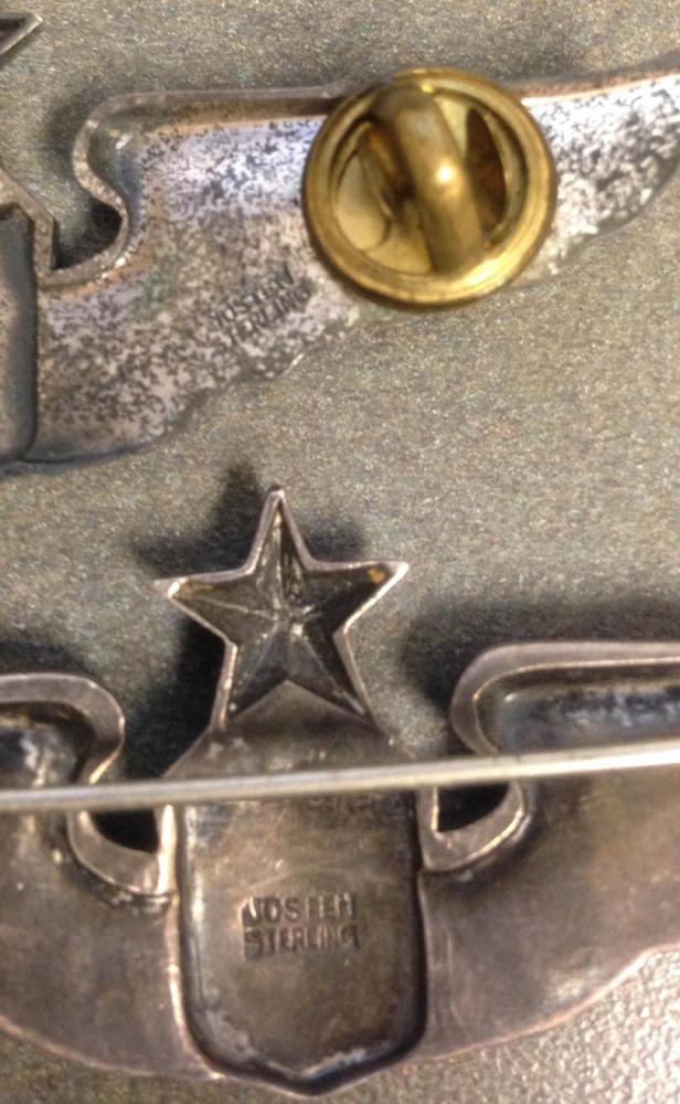

5thwingmarty Posted October 27, 2020 #64 Posted October 27, 2020 I was doing some Josten wing research and turned up this old thread. In reviewing the wings shown I noticed something a bit odd about Andrew's Balloon Observer wing. Although it has the Josten Sterling mark in the center of the back as is typical of Josten pinback wings, the style of these appears to be that typically found on Josten clutchback wings. On all of the other pinback wings I have seen the Josten and Sterling are lined up, with the J and N being directly over the S and G. On all the clutchback wings the J is centered over the ST and the N is centered over the NG.

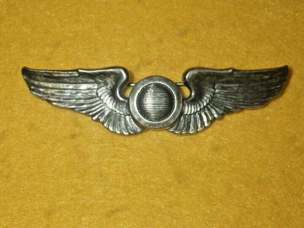

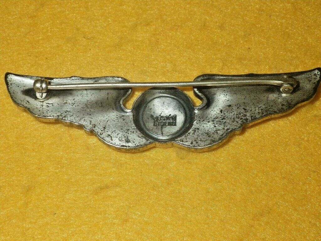

donaldnol Posted April 10, 2021 #67 Posted April 10, 2021 i need to know is this a true JOSTEN'S STERLING WING
donaldnol Posted April 10, 2021 #69 Posted April 10, 2021 11 minutes ago, pfrost said: Looks good to me hard to see the lettering, good thanks
bschwartz Posted April 11, 2021 #70 Posted April 11, 2021 That's a very nice wing. Surprisingly, they seem much less common than the Senior Pilot and Command Pilot wings.
pfrost Posted April 11, 2021 #71 Posted April 11, 2021 I have always felt that the VAST majority of the relatively common senior and command clutch back Josten wings are actually post KW, and much more modern than is thought. There are several threads on that idea in the forum. But here is what I think. The Josten WWII vintage wings (usually with pin backs) are relatively rare. This includes the Josten pilot, senior pilot and command pilot, the observer and some of the even more rare balloon wings. Although not a STRICT rule, in general those WWII made rating were in pin back. The main exception to that is the WASP wing, which was only made in clutch back. It took me ages to find a Josten pilot wing, then another age to find the pin back senior and command pilot wings. I am still looking for the observer wing. But I think you have to be careful into which time frame you put the clutchback senior and command pilot wings. My feeling is that they are NOT WWII vintage. Here is one thread but there are many others:
rathbonemuseum.com Posted April 12, 2021 #72 Posted April 12, 2021 Yes, authentic Josten observer and relatively hard to find.

Kropotkin Posted April 12, 2021 #74 Posted April 12, 2021 The difference in the clutch pins, as shown in the above picture, might be a pointer to likely dates of manufacture. The command pilot wing has the nail head pins suggesting a later manufacture compared to the three others that have soldered ‘straight’ pins, which are generally accepted as being WW2, late-40s era.
pfrost Posted April 12, 2021 #75 Posted April 12, 2021 Russ, just to quibble, I don't believe I said that the S/P or C/P weren't made in WWII. I do think that the VAST majority of the ones you see are in fact post KW time period. Nearly none of the pilots who got their wings when WWII started would have been able to reach the qualifications for senior, much less command pilot status before the war. I suspect that Josten made some war time SP and CP wings, but I also suspect that those particular versions are as rare or more rare than the other WWII-vintage wings like the observer/pilot. The old NOS cache of Josten SP and CP wings that used to be sold on eBay probably represent more modern versions and not WWII vintage wings. Those appear to be all in clutch back. The Josten pilot and observer wings (as well as some of the other ratings) do show up in both clutch and pin back versions and I have no issues with them being WWII. My statements really only pertain to the rather common SP and CP wings. In contrast to the huge number of SP and CP clutchback wings, you will rarely find (at least in my collection) a SP wing, in pin back, with the hallmark in the center of the shield. They are more akin to the WWII version of the pilot wing, and it is my suspicion that those are WWII vintage wings. NOT the ones with the clutchbacks... although I see no reason why some of them can't be. No way of telling really. P
