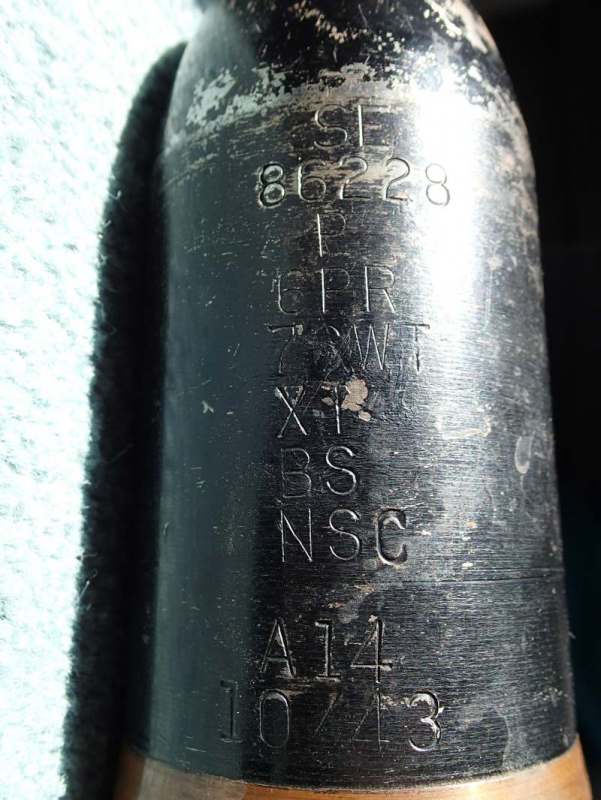

Here are some photos of my 6 PR projo.  It is well marked.  The painted example is from my file of another:
