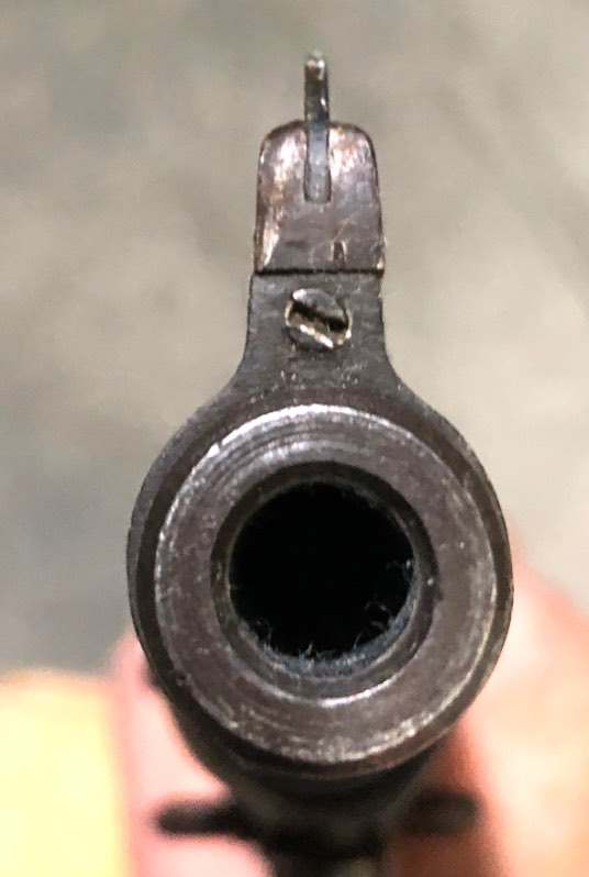

Beautiful piece. Sad about the front sight.

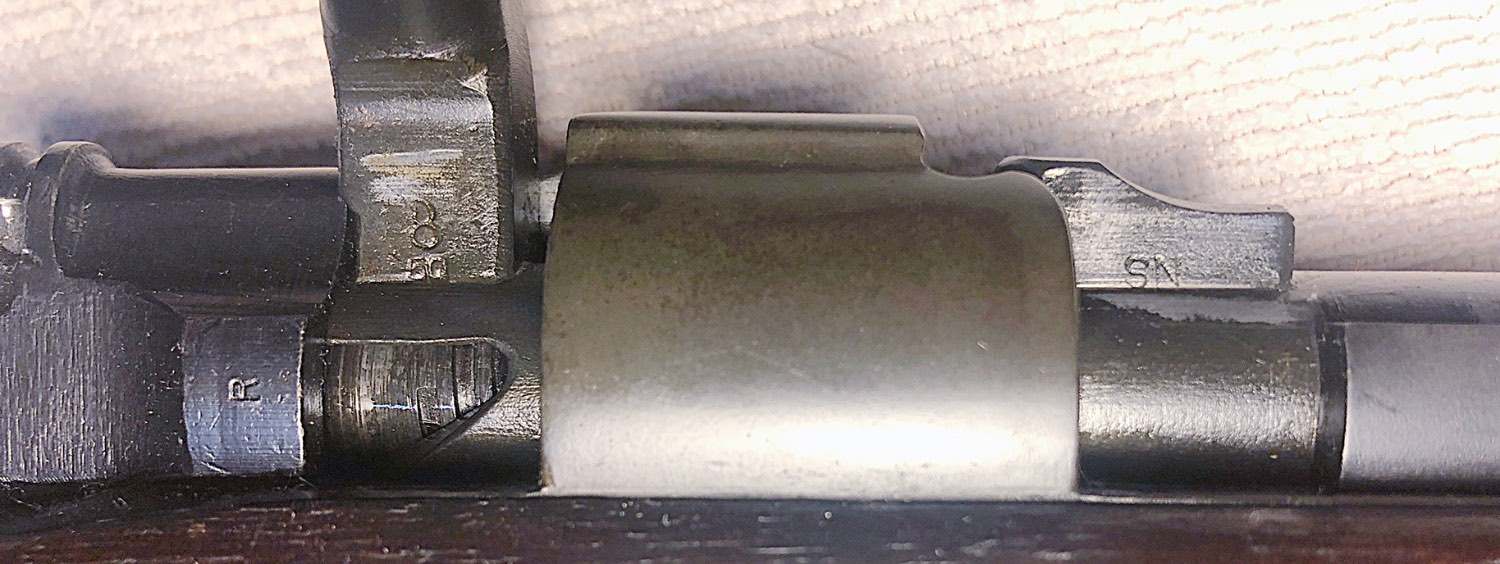

Here's a close up without the cover, what are you seeing?
Nice rifle! The bolt appears to be a RIA nickel steel from the 1918-19 period. Early ones were straight and later were swept back.  The marking under the bolt handle of the ordnance flaming bomb and "50", plus the NS on the underside of the safety lug indicate this.  Your rifle was probably made in late 1919 to early 1920. The Mark 1 I own is S/N 11892xx with a barrel date of 2-20.  As to the front sight, it appears to have been shifted somewhat to the right of center in your photo above without a witness line on the sight base. Take a look at John Beard's  Vi shooters page for much more bolt info: http://www.vishooter.net/m1903.html  Be sure to read the explanatory notes too! Could you take a close-up shot of the ejection port/stock area?  Thanks for posting.

GWS, Thanks for the input, I got the bolt info from John Beard's site, and the rest from my copy of Brophy. (See original post).
What I did not think to check was the front sight, so that will be next. I enjoy the research.

Thanks for the additional photos. I could not tell for sure if the stock under the ejection port had the small relief cut but you confirmed that.  What I don't know is if the RIA bolt would have been in this rifle originally or not, but if so,  it probably had the later swept bolt handle. Hope the headspace checked ok. Did you check it?  I will look to see if I have either a SA or RIA bolt sleeve, the Remington works but it's a sore thumb on an otherwise nice looking Mk.1 rebuild.

Don't know for sure, although I expect that the original bolt was a Springfield, and the arsenals did their usual thing.
I have fired that rifle for some years now, a couple times a year since I got it, not including 2019 and 2020. And yes, the headspace is good.

Well, I found the bolt sleeve I was thinking of, but it's a Remington too!  Glad to hear that the headspace is good and the rifle shoots so well. The bolt you have is a good one so I wouldn't worry with it at all.  Someday when I have time I'll post my old 03 shooter on here, talk about a mixmaster of parts! But like yours, it shoots well and I like it so who cares!  Thanks for the reply too.
