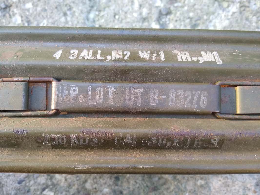

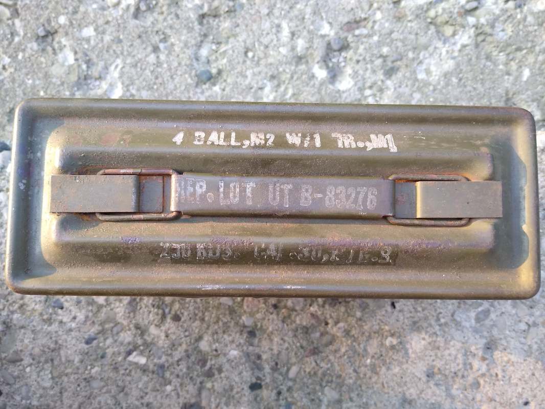

kfields Posted July 7, 2021 #1 Posted July 7, 2021 I purchase these older cans when I see them and the price is right. Something I use to store my Garand ammo in. I pulled this can out this afternoon as I plan on doing some shooting this week. Just curious if someone could decipher the stencil markings. None on the sides, just on the lid. Thank you Kim
mohawkALSE Posted July 7, 2021 #2 Posted July 7, 2021 I know the first line of it is showing its a combat mix, so was linked or belted ammo for a machine gun. The belts were loaded 4 Ball Cartridges 30cal M2 and then 1 tracer 30 cal M1, or what would be called a 4 to 1 mix, every fifth round a tracer. The handle part appears to be the lot number of the ammo, and I cant really make out the last row other than the 30 cal part.
917601 Posted July 8, 2021 #4 Posted July 8, 2021 The handle translation as I can see,“ repacked Utah Arsenal, Belted, 83,xxx” (lot number). Unusual as that info by reg should be inked or stenciled in yellow on the can side.
kfields Posted July 8, 2021 Author #5 Posted July 8, 2021 Thanks 91760. I thought it an unusual place to put those markings as well. Seems like a difficult place to stencil for the stenciler. Not that I've seen a lot but I haven't seen another can marked this way . Kim
silverplate Posted July 11, 2021 #6 Posted July 11, 2021 That is a rare variation (of nomenclature markings) on a very common ammo box. I hope you plan on preserving it as is. Very cool! Utah Ordnance Plant was in operation from March 1942 until December 1943, producing over 1.2 billion rounds of .30 caliber ammunition. The rounds in that box would have been packed in a cloth belt, and there would have been a repack card inside the box that identified the original lot numbers of the ball and tracer rounds placed in the belt. Here's my replica of what that repack card would've looked like for a Utah repacked lot.
