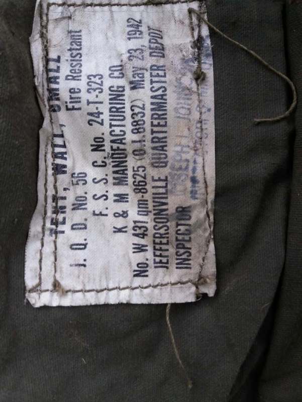

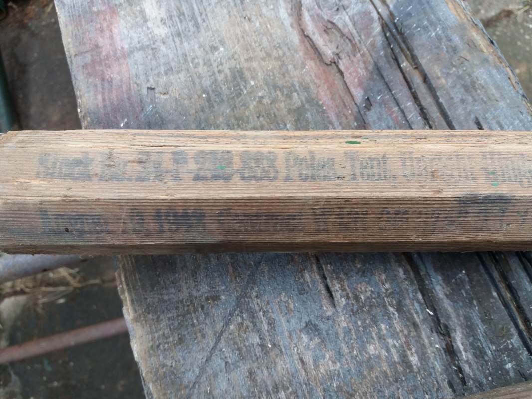

Hi, picked up a nice tent today and wondered if these poles are right. They do look like they have been with tent a long time but never seen this style before. 20210628_171339.jpg.7aed088486728e6abb61f9b78513de64.jpg20210628_171301.jpg.ea88f4a47d288e68c502d3fe91a58b1e.jpg20210628_171339.jpg.7aed088486728e6abb61f9b78513de64.jpg20210628_171241.jpg.85ad1f4acd64fc011003eaf20356b4dd.jpg20210628_171211.jpg.b1925fbbaa617dacecd68060680d49b0.jpg

Poles look good...hard to find WWII poles like that...nice

Specifications are listed according to FM 20-15 Tents and Tent Pitching - February 1945.
The upright poles are described as:
Poles, tent, upright 9' - Stock No. 24-P-253
and the ridge pole is::
Pole, tent, ridge 9' wall, small - Stock No. 24-P-114
The upright poles are described as one piece but the two piece version probably were used out of necessity and if they were available.  (Today a two piece pole has the advantage of easier storage and transport.)
The manual states that the ridge height of the small wall tent is 8' 6" which may seem odd with 9' upright poles but, in practice, the instructions indicate that the earth should be evacuated where the uprights sit with a hole dug to correctly match the ridge height and the hole is then filled and packed back to add stability to the erected tent.
In practice today since old canvas has a tendency to shrink - it is best to carefully measure the tent to determine the best actual height needed and cut off a little of the bottom of the pole for a good fit - instead of digging the hole.  (I carry two small pieces of 2" x 4" board painted OD to place under the poles especially if the ground is wet and soggy.)
Ridge poles from the modern latrine screen set make excellent substitutes for the small wall tent ridge pole.
